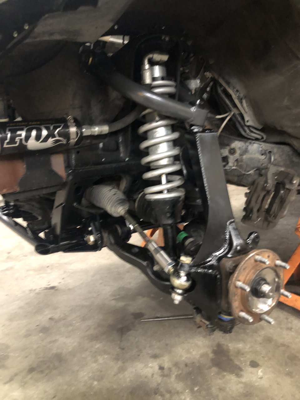

    In as simple of words as possible, explain the benefit of this to me.

    Bitches.....Heims get bitches...also bypass tubes pull bitches too! That is all you need to know

    How about one word strength

    He probably knows this and is asking along the lines of if you don’t have the outer tie rod be the weakest link (and easy trail repair) then the inner becomes the weakest link which sucks to change out on the trail

    I had my inners and rack have issues before my outers. The side loading and harsh side hits really does a # on the inner and rack seals as well as flexing of the rack and potential breakage which we've seen before outer tie rod failure. You also have the point of rack "tooth" jumping from big tires and bound before an outer tie rod has issues (again something I experience on a regular). IMO the heim now just adds a little more strength over the stock outer tie rod but adds more flex before bind and gets rid of on of the potential killers of travel when going LT. That's just how I see things from what I've experienced.
    IMO the point to this kit is getting the stock spindle as close to a custom fabbed one without the huge costs associated and the gusset design without the double sheer looks to be a little better than the TC. I'll have them both side by side to compare. So again I stand by in strength and clarify it as spindle.

    @81Trekker if you are looking at doing a 3.5"-4" LT with fabbed spindles I'd definitely be interested especially if we could get some more ground clearance and it pushed the axle forward even more like the MC kit but also gained the caster like your current set up compounds with the LCA mounts.

    I’ll gladly make one if someone wants to pay for it. I would also cut the coil bucket out and start from scratch to fix the caster change issues with the taco

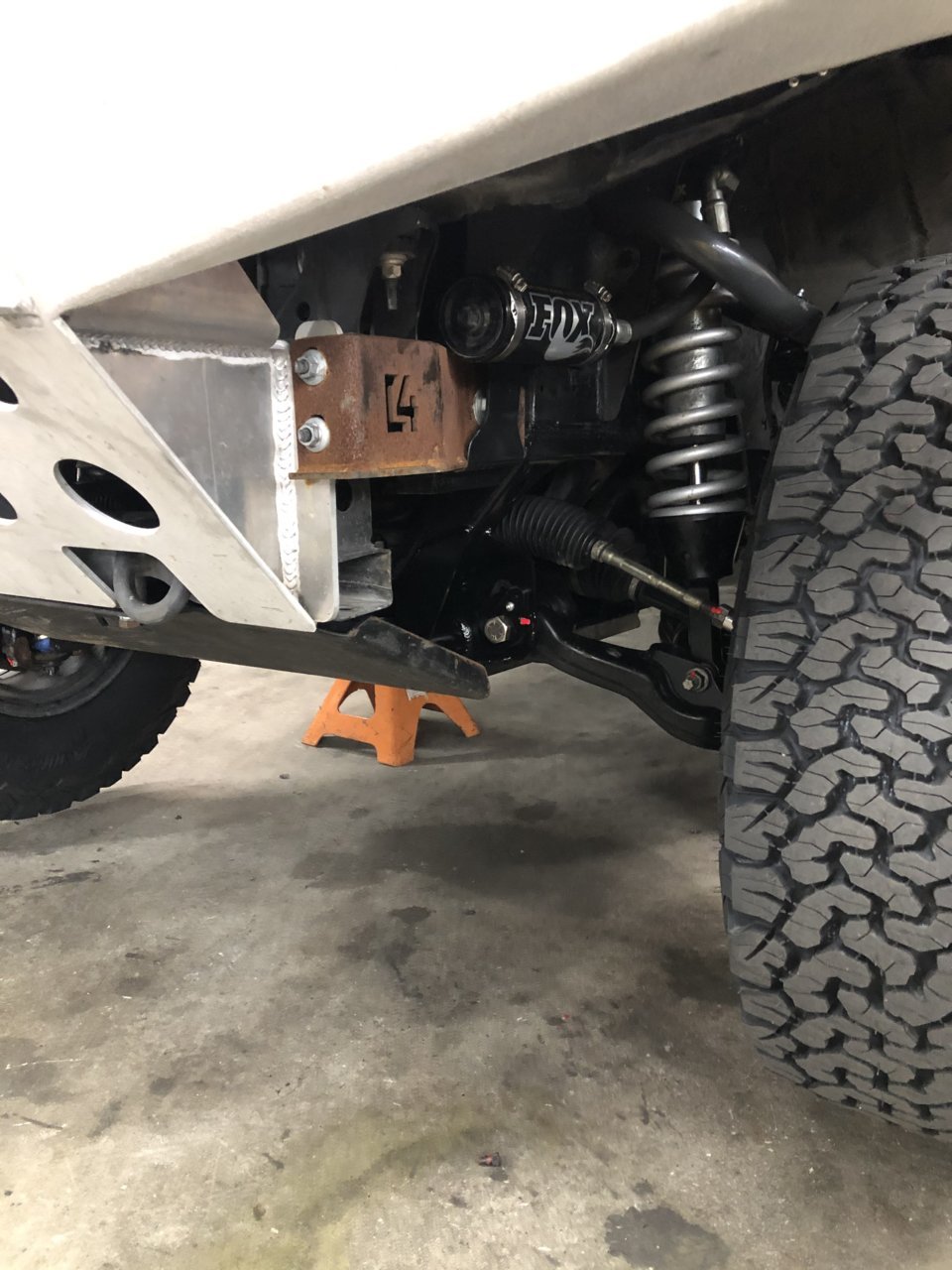

    The pelf skid works nicely with the LCA kit
