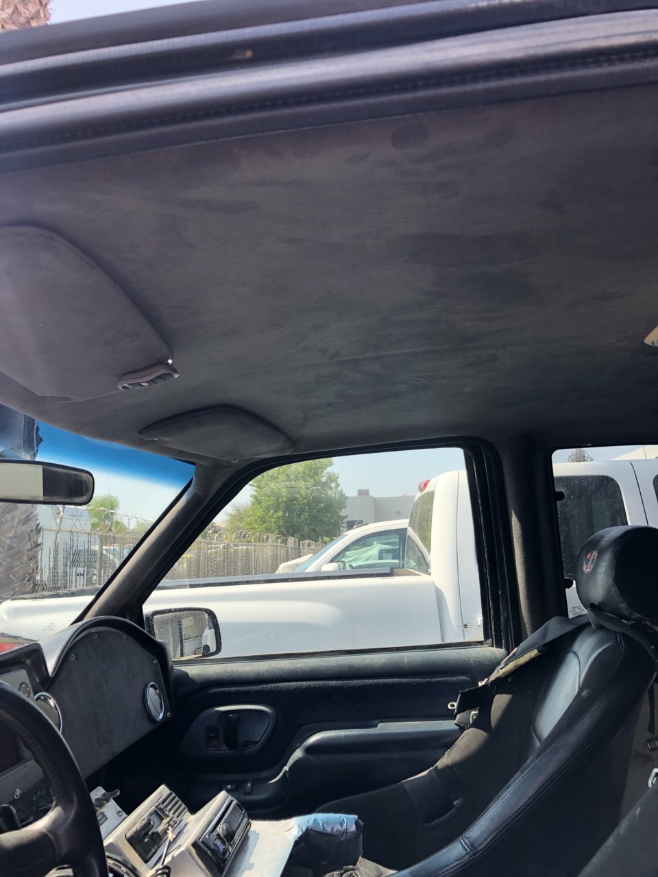

  2. Aug 28, 2020 at 8:45 AM

  3. Aug 28, 2020 at 8:46 AM
    #2163
    Jpiskura
    Jpiskura Well-Known Member
    May 23, 2013
    #104773
    536

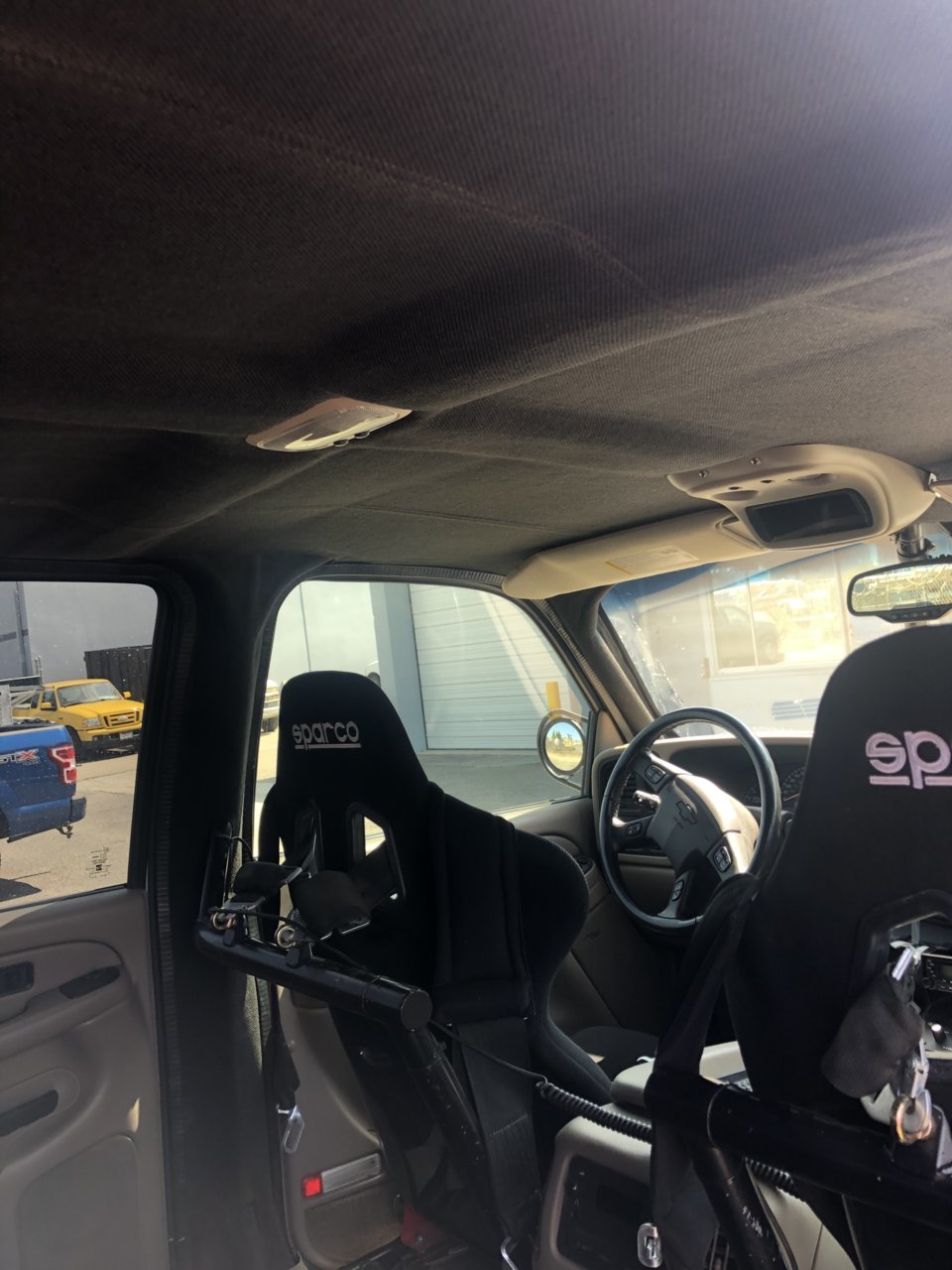

    Please don't put a headliner in this... It is a mortal sin to cover something like this up....

    Lol... I think it will be more impressive to have a truck that you can’t even tell has a cage in it!

    I agree with this. It would be kinda cool to do a panel that recesses just a bit into the areas around the tubes so it bumps out the tubes hinting that there is something I under the headliner.

    I just did a Silverado like that and I honestly don’t like it

    I much prefer the smooth look

    Yeah nevermind it sounded and looked better in my head. Not bad but not as epic as I was thinking. If you wanted to leave the bars poking out just a bit upholstered panels in the spaces would be ok but I think it would be noisy and just looking lackluster after a while. Full headliner it is!!!!
