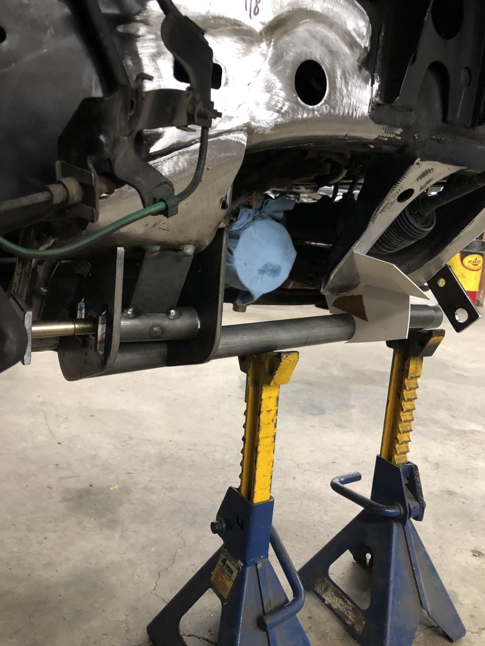

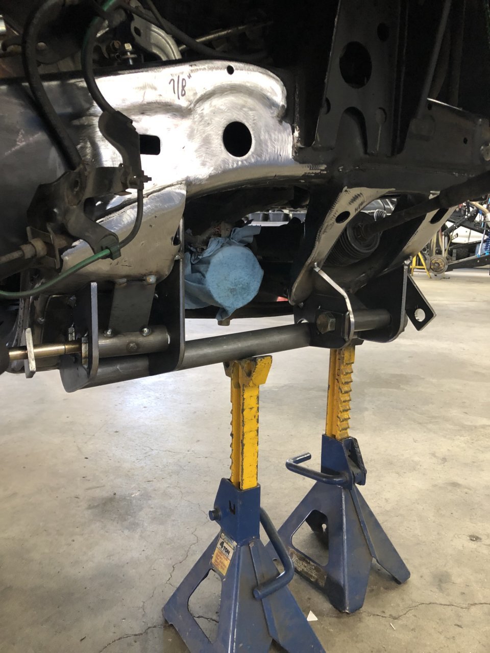

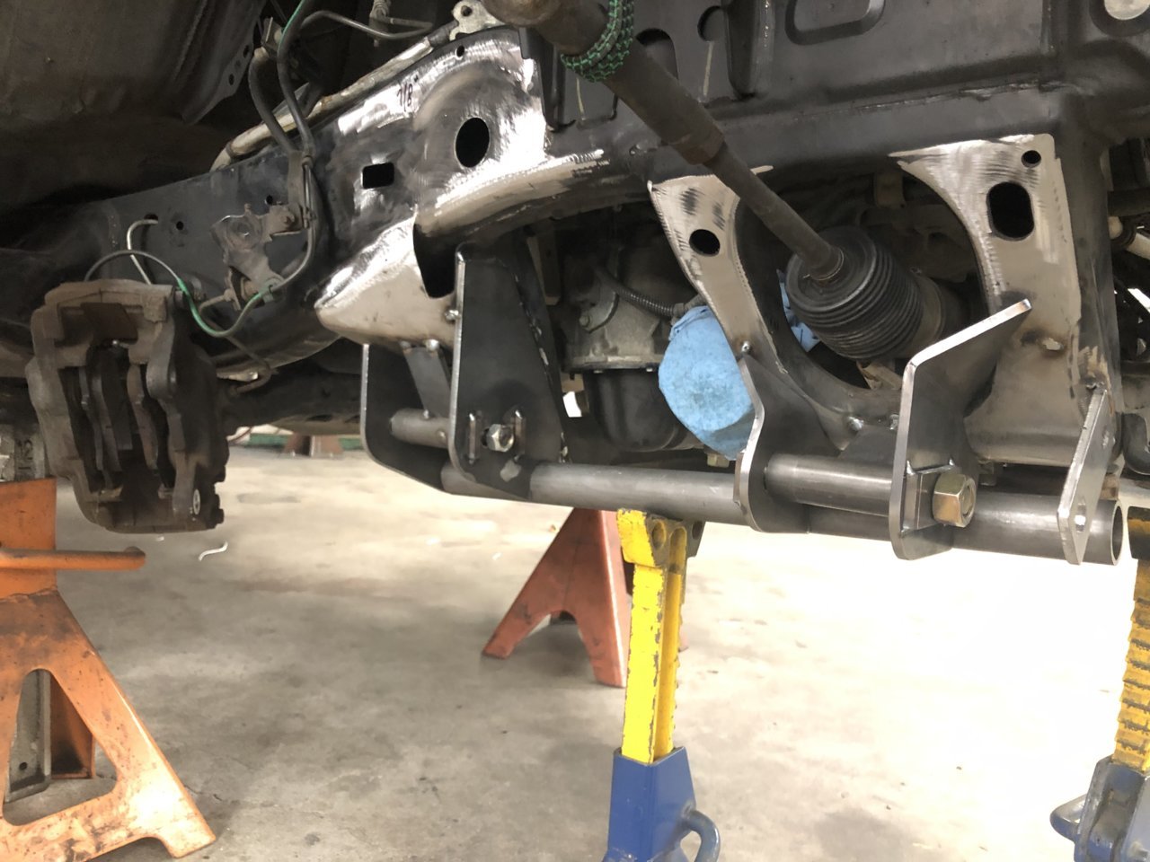

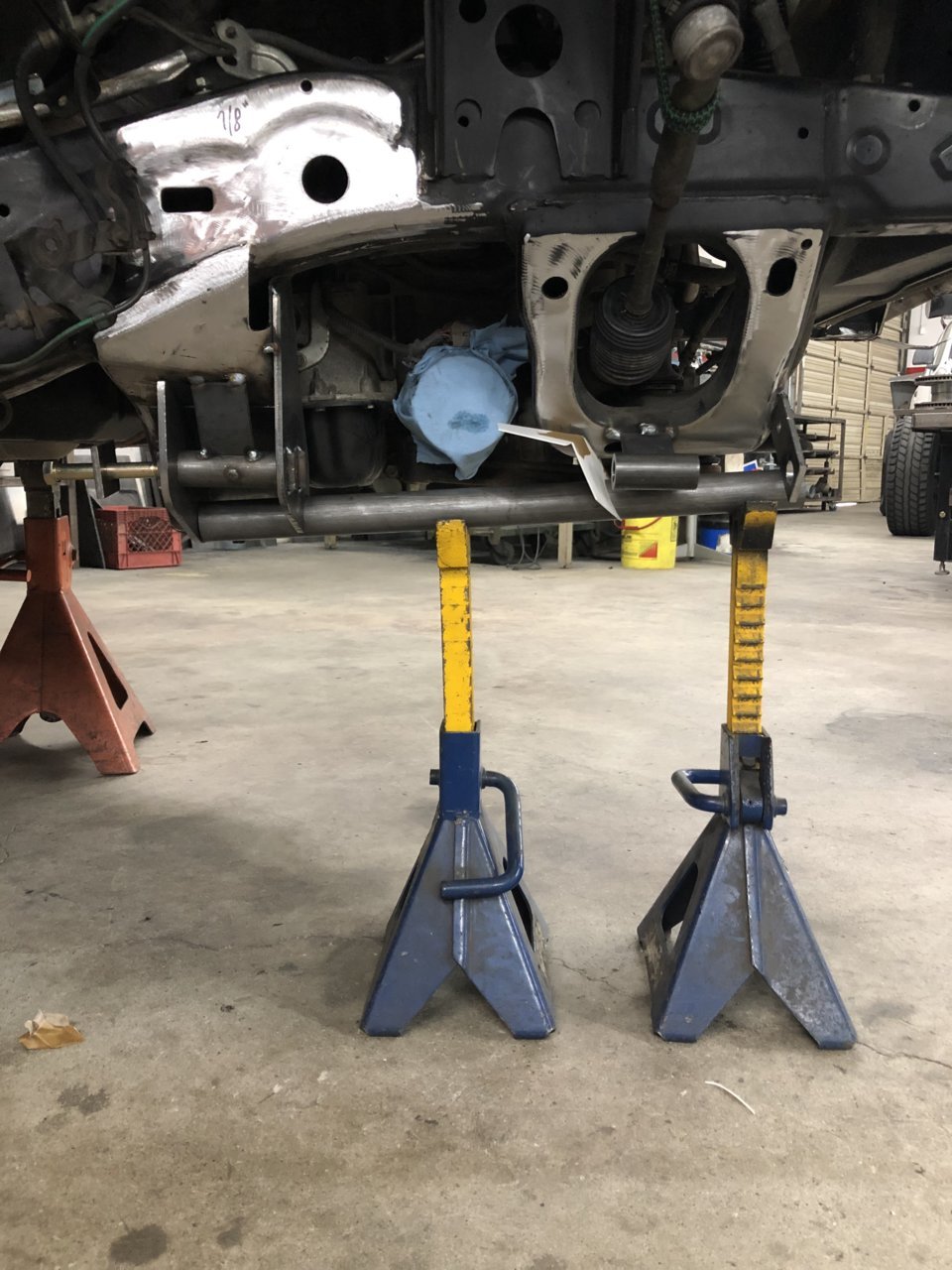

    Here’s a pic of inbetween the arm tabs, you can see the plate that was added which fills in the factory hole in the frame...
    And the tab in the second pic was just an alignment tab for the jig, it’s not part of the actual ones I’m using

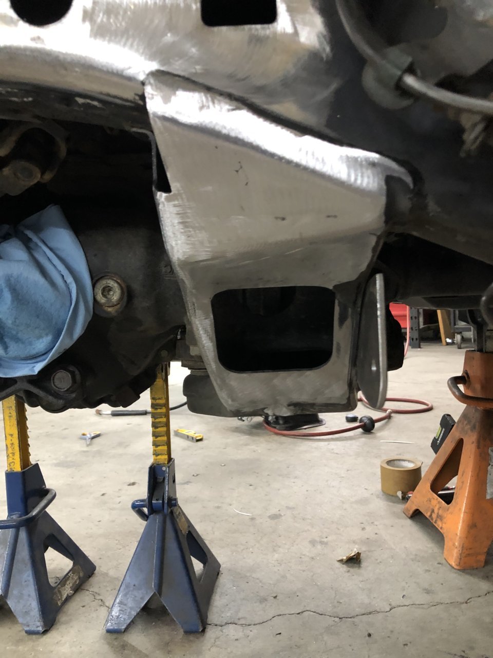

    The front pocket is almost done...
