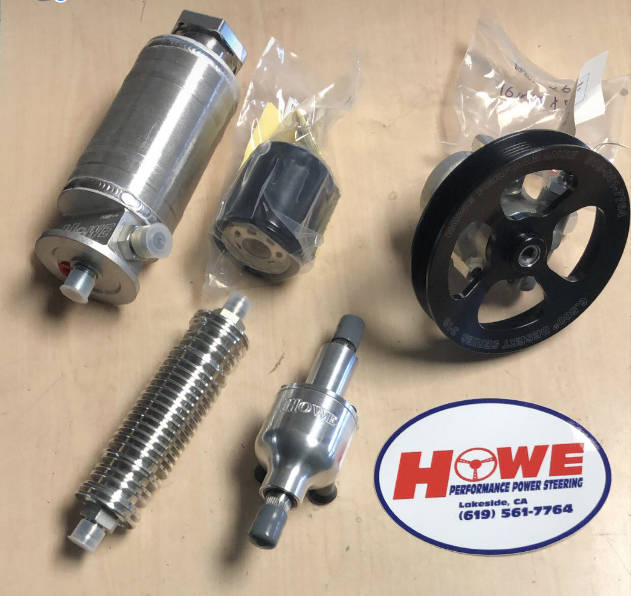

    I’m not seeing this “kit” on their website... Did you piece it together yourself? How much $?

    It’s a kit I had them do for me that retails somewhere around $1k
