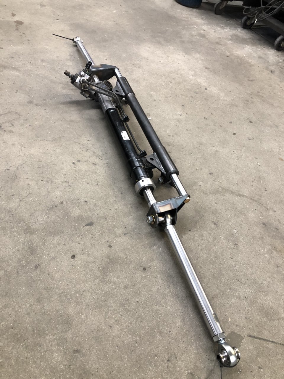

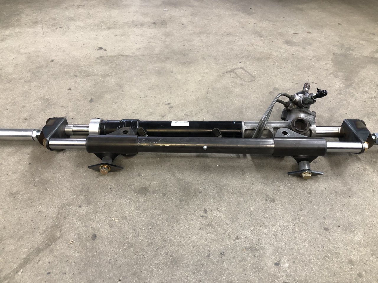

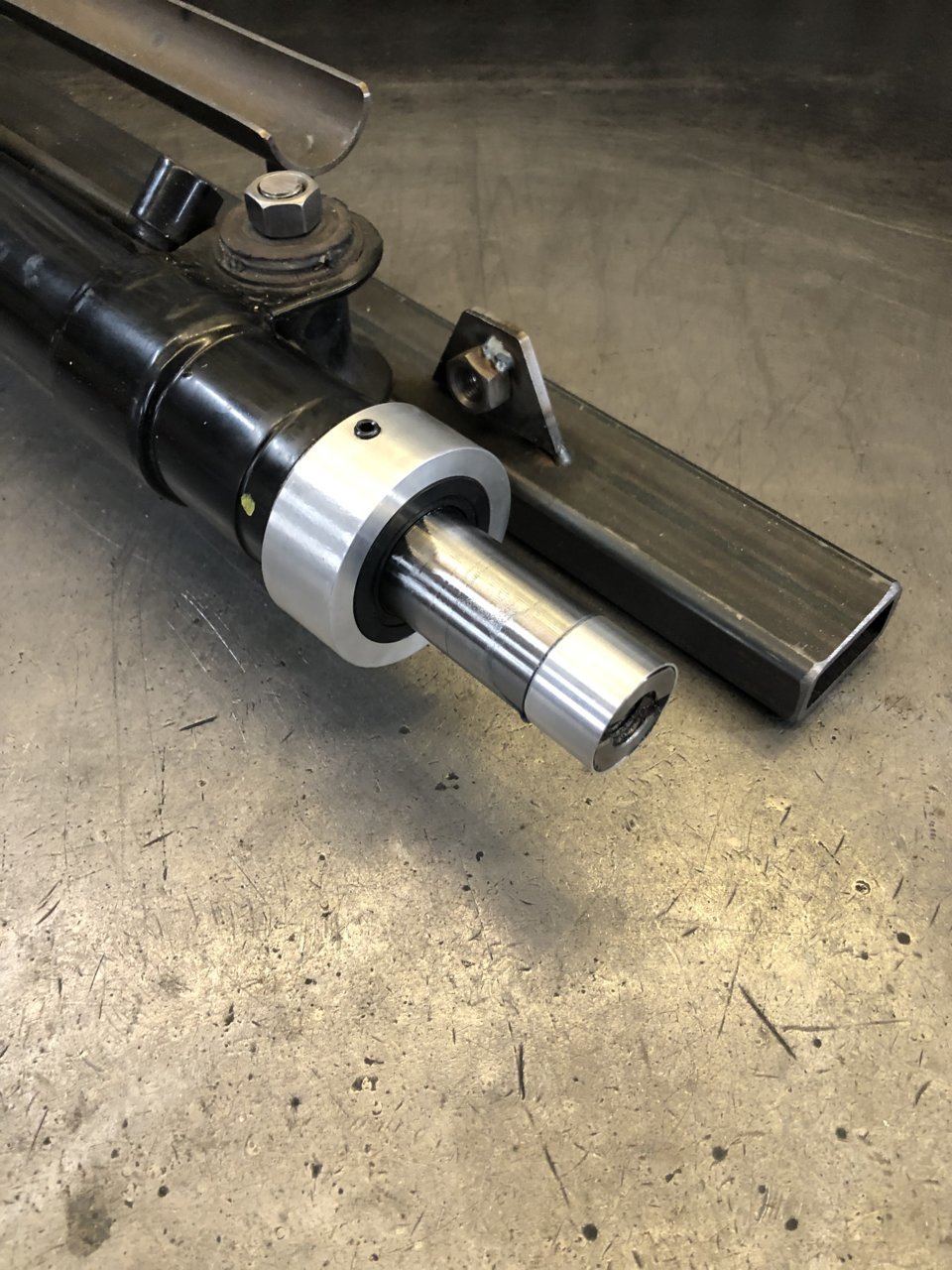

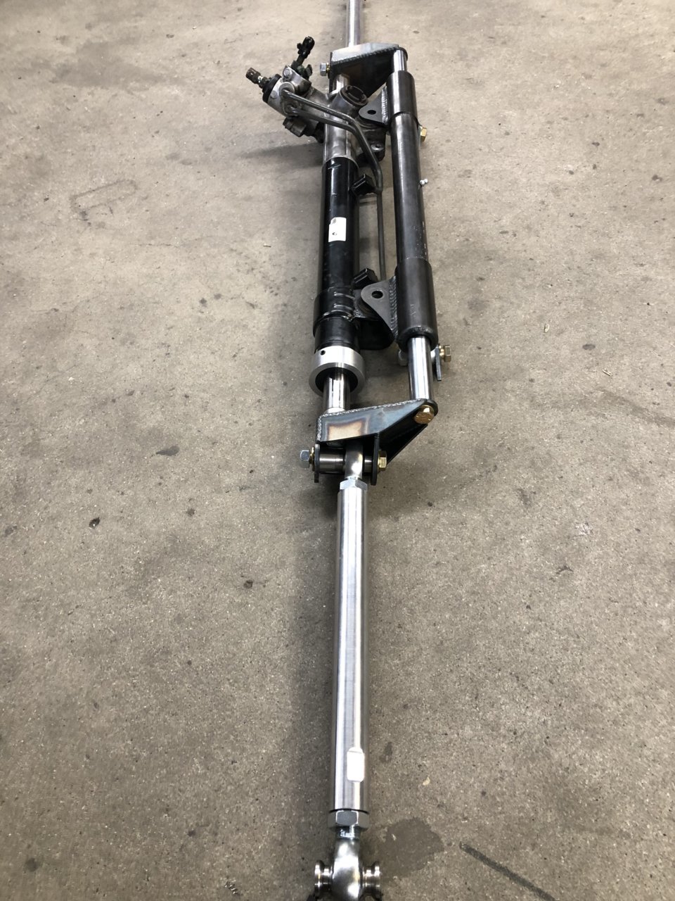

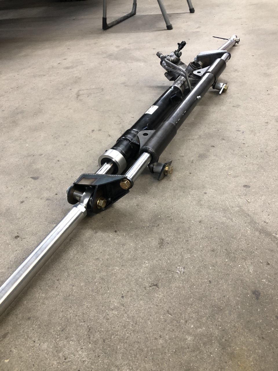

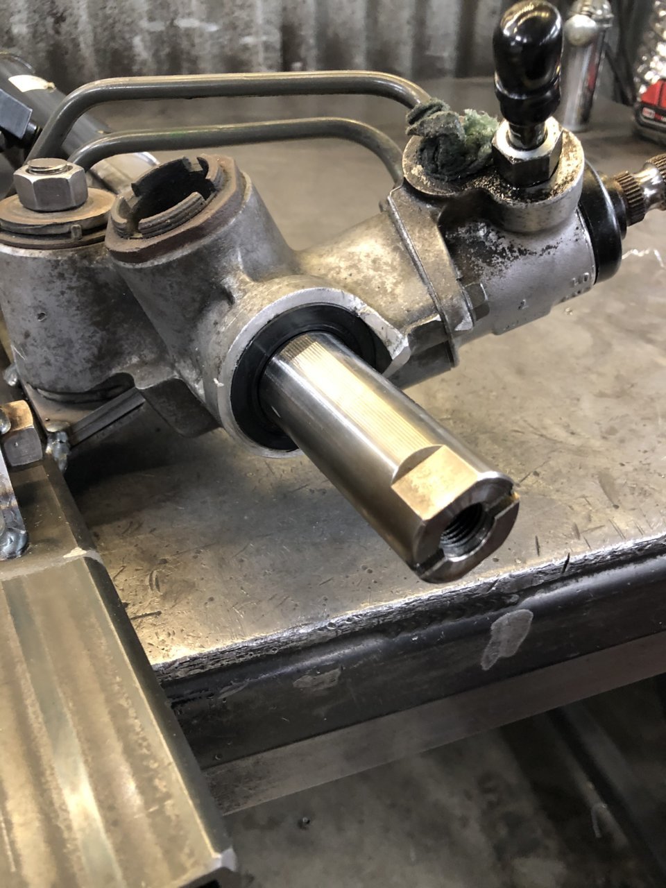

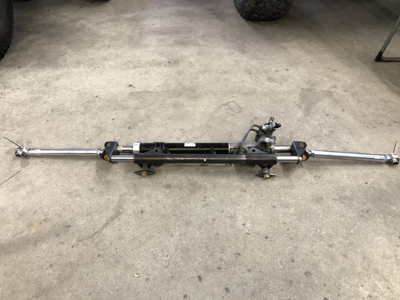

    Secondary rack seal kit for the slide rack

    I like in the last picture that it shows you’ve compensated for bumpsteer by moving the inner pivot forwards. Almost looks like it could be adjusted if necessary by use of different spacers. Really like the finished product here.

    We spent a ton of time figuring out the bump steer and thanks!

    If that OEM steering piston could be hard-chromed, like a hydraulic shaft, there would be no need for boots up here in the rust belt.

    So it looks like this could be adapted to work with my 4Runner rack, which I believe has slightly different lengths as well as the mounting hole dimensions, by having you not weld on the tabs that use the rack mounting holes, correct? Any issues with the rack length being a bit different that I am not thinking of?

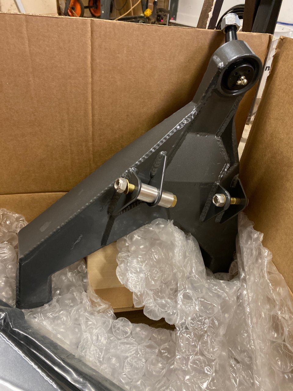

    These just showed up and 934s on hold. Now I gotta figure out how to sell a kidney for the steering solution before I get back from deployment!137D7171-EA2F-4D5A-AA9C-2E457AB36A37.jpg

    Working on them... I have 6 Tacoma’s to do full installs before I will have time to really dive into it

    In theory it would work however the tabs are welded in a Tacoma specific jig and then the end pieces are put back in the lathe so they have a slip fit over the end of the slide.
