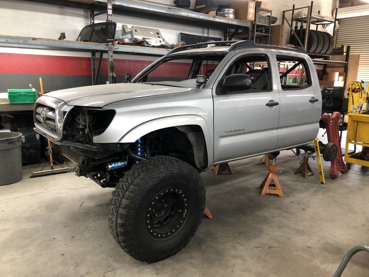

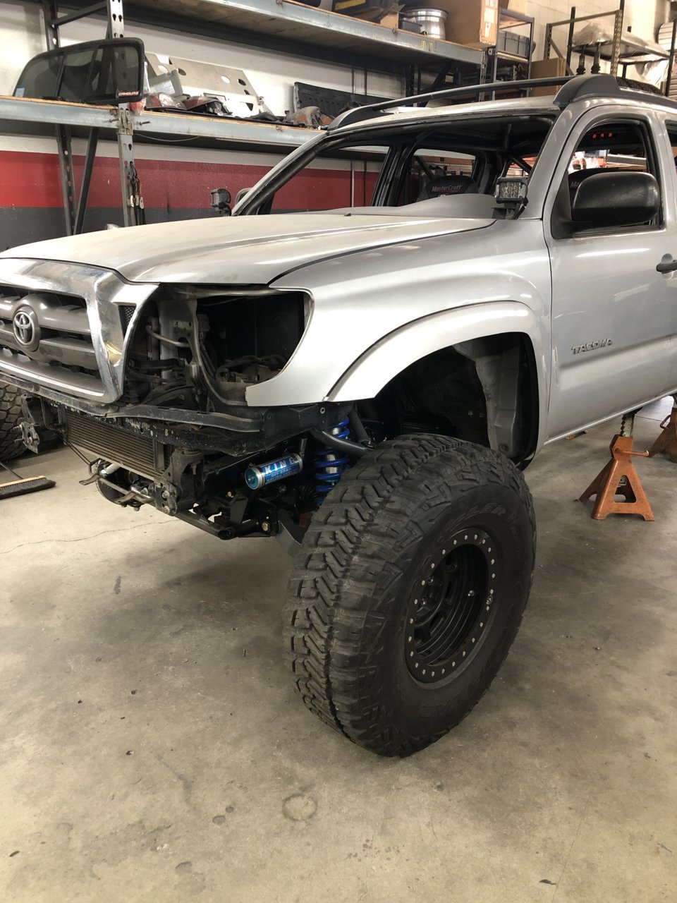

    Looks good! What size tires are those?
  5. Sep 20, 2020 at 6:50 AM
    #2225
    81Trekker
    81Trekker [OP] Well-Known Member
    Aug 25, 2019
    #303299
    3,750
    La Jolla SD
    81 Trekker and 2015 CCSB Tacoma
    Too many to remember
    37x12.5
