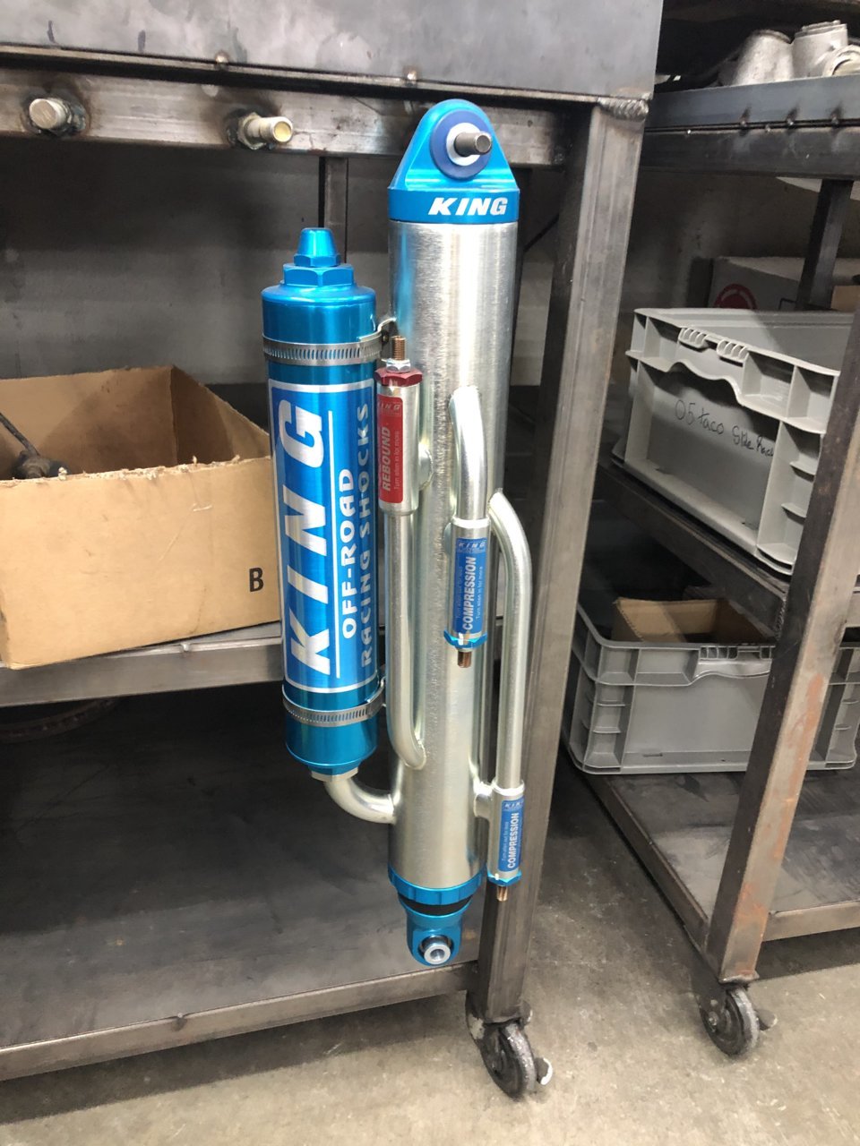

    Makes sense! Can’t wait to see how it’ll turn out when you mount the shocks and bumps. Is all staying under the bed or will you cut the bed?
  20. Sep 30, 2020 at 11:47 AM
    #2260
    81Trekker
    81Trekker [OP] Well-Known Member
    Aug 25, 2019
    #303299
    3,750
    La Jolla SD
    81 Trekker and 2015 CCSB Tacoma
    Too many to remember
    Yes... 14” 3.0 bypass shocks will be completely under the bed, axle bumps out on the frame and will cycle 18”
