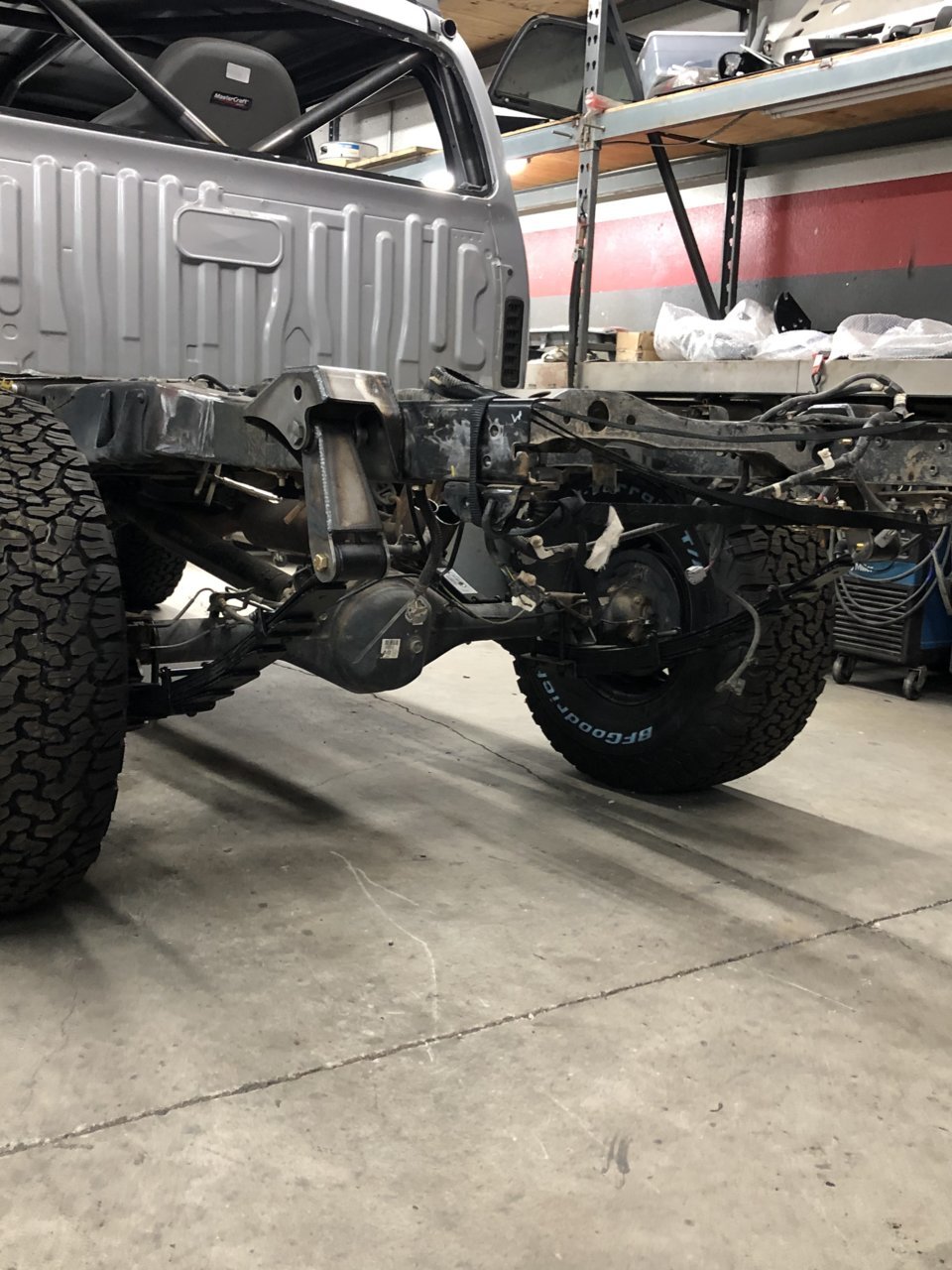

    But what happens when you drop down onto a rock on the shackle and spring?
    EatSleepTacos likes this.

    I've ran dakars with BP-51 rear shocks, and currently have a 63 swap with 16" kings. The ride is insanely better with the 63s. The dakars were always so stiff and didn't flex very well. I haven't lost up travel, I just haven't gained any. I did gain a tonne of droop though. Lifting the rear wheel with a forklift, I gained around 10" from ground to bottom of tire with all 3 other tires on the ground and the same front setup.
    However, with a longer shackle pivoting from the top of the frame, like this setup, you could set the up travel to be much more without having the rear end sit sky high at ride height. The goal for me would be 16" of travel, sitting at around 7-8" up travel, and maintaining clearance under the axle.
    Axle wrap is definitely a thing with 63s though, I will admit that

    Yeah really. I hit my hangers all the time in the rocks. I would be worried about tweaking the leafs.
    snowsk8air2[QUOTED] likes this.

    The same thing when you do it with a shackle hanger. Have you not seen stock trucks hit their springs or shackle hangers? I haven't had one issue with my 63s and the've been drug across and dropped onto rocks quite a bit.
    Dropped down on mine multiple times as well seen others drop down a lot harder absolutely no damage other than some rash. You can still drop on the springs with normal tacoma hangers seen that with no damage.
    I was looking at redoing my shackles and set up as well dropping the rear of the truck some and doing better shackles too. I didn't even come close to thinking of this geniusness.
    old55guy and WormSquirts[QUOTED] like this.

    I hope this isn’t a serious response. When you drop down onto a rock the springs and shackle has the ability to move unlike the drop hangers which will end up bending and tweaking your frame.
    Additionally the springs move much more naturally with the shackles in this orientation which give the truck a much better ride. With the shackles pointing up they fight the spring and then when it drops out you loose spring rate when the shackle drops forward
    jdiola, kasnerd, ovrlndkull and 2 others like this.

    Half serious question just because I know everyone on here hates on shackle "flips" primarily for soa because it puts the leafs in to negative arch. This is also primarily for stock length leafs. I ran that setup for a while on my stock length leafs and it seemed to work alright but that was before I started getting into bigger rocks. I know thats how a lot of leaf sprung jeeps and what not are as well as how 1st gen tacomas do their long travel setups. Was just curious as to what your response would be.
    Side note, what happened to the shackle pivoting off of a D44 hub or something? Wasn't that the original plan?

    The typical shackle flip kits don’t allow for the shackle to be mounted up as high as ours because of how we changed the front spring hangers.
    we ditched the d44 snouts for a double uniball shackle because we wanted to make the rear spring hanger have adjustment so you can tune in the spring rate based on your setup
    lferrara, kasnerd, bhigbee and 3 others like this.

    The companies that offer them just offer them as plane jane without any real good "adjustments" or work as to where they should and how they should be located. They also don't work on setting them up for proper bump stop location and rely on the stock replacement set up which could be wayyyyy off compared to a flipped shackle.

    Gotcha, I was wondering about the extra mounting holes on the rear hangar.

    The different mounting holes allow you to adjust the hangar location which will change the ride height and spring characteristics. It’s cool to be able to adjust them depending on how many roof top tents and jerry cans you have
