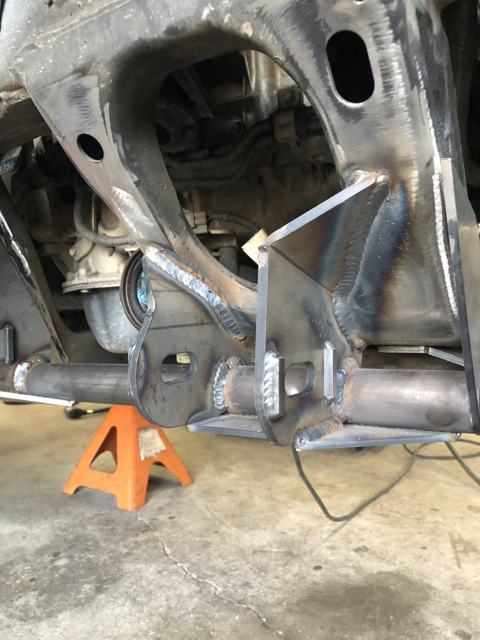

    @81Trekker so you mentioned earlier in the thread you don’t care for SPC uppers and rather use a stronger uniball after adjusting the LCAs forward. Does that same thought apply to stock length LCAs too?
    I’m going to have my shop adjust the cams as for forward as possible. Basically I’m going to clear these tires 100% on stock suspension before I really dive deep down the rabbit hole suspension wise. Funds aren’t unlimited right now so I want to do something I’ll have to do anyways no matter what is up front - clear tires through entire travel range.

    Pushing your lower arm all the way forward in the stock mounts is the worst thing you can as it puts side load on bushings

    So this would be where your bracket mounts (and/or extended LCA) would shine?
    apologies for all the questions - I’m not a fan of doing shit wrong. Constantly learning here

    Yes the LCA pivot kit is designed to allow the cams to sit right in the middle of the adjustment and give you 4 degrees caster with stock upper arm geometry. This eliminates all bushing side loads

    that’s such a badass kit after going over all the info the sight mentions.
    question: how obnoxious will oil changes on my 2.7 be after that sucker is welded to my frame? Lol. I already take my RCI skid off each oil change, but the door on your pivot kit looks bigger

    You just remove the entire skid, it uses 5 3/8” flush head allens with captive clip nuts... the entire skid can be removed in under a minute
