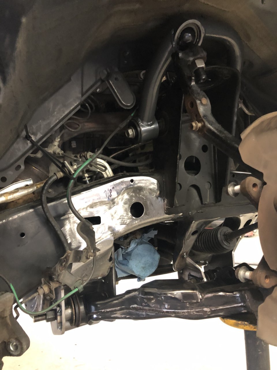

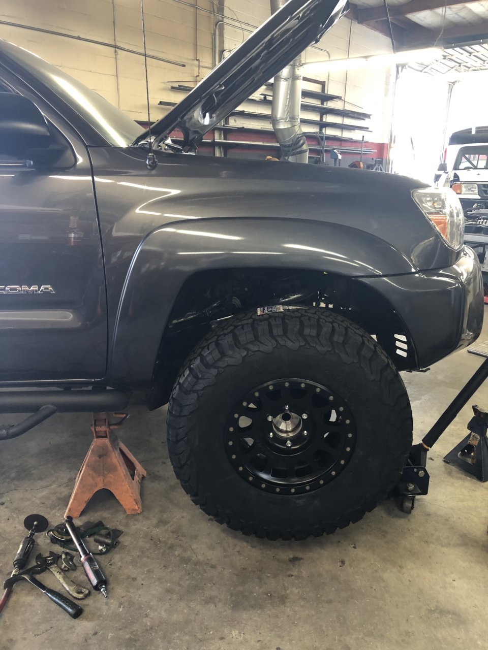

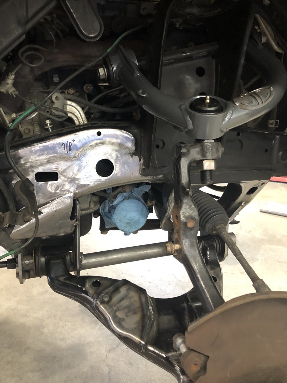

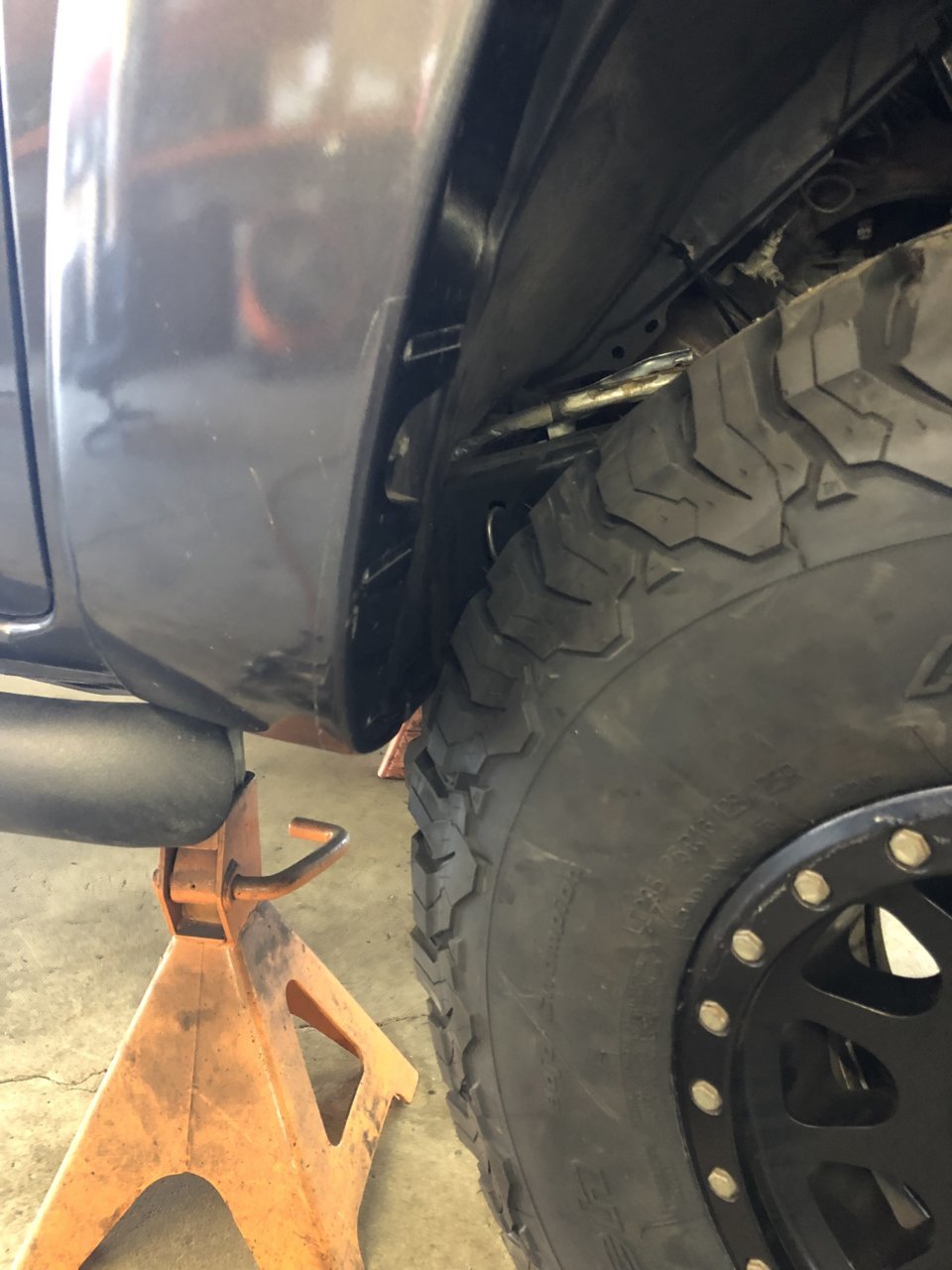

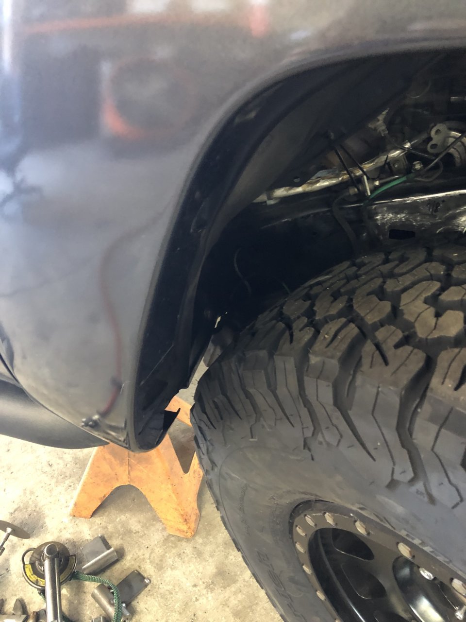

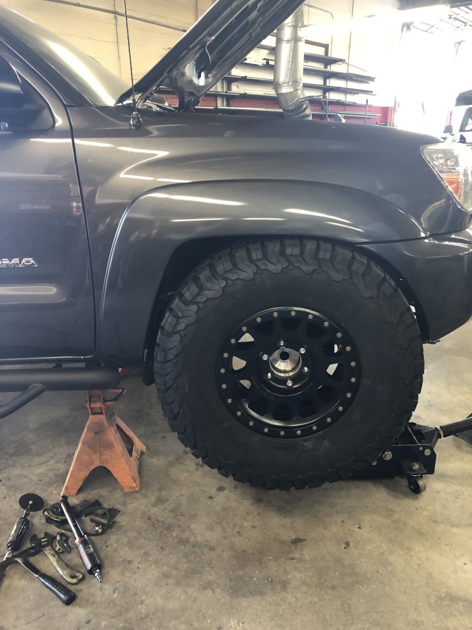

  18. Oct 4, 2019 at 9:54 AM
    #238
    81Trekker
    81Trekker [OP] Well-Known Member
    Aug 25, 2019
    #303299
    3,750
    La Jolla SD
    81 Trekker and 2015 CCSB Tacoma
    Too many to remember
    Picture time...
  19. Oct 4, 2019 at 9:55 AM
    #239
    81Trekker
    Aug 25, 2019
    #303299
    3,750
    La Jolla SD
  20. Oct 4, 2019 at 9:56 AM
    #240
    81Trekker
    Aug 25, 2019
    #303299
    3,750
    La Jolla SD
    295’s on 0mm off set wheels fit with no cab mount chop at full bump, lock to lock
