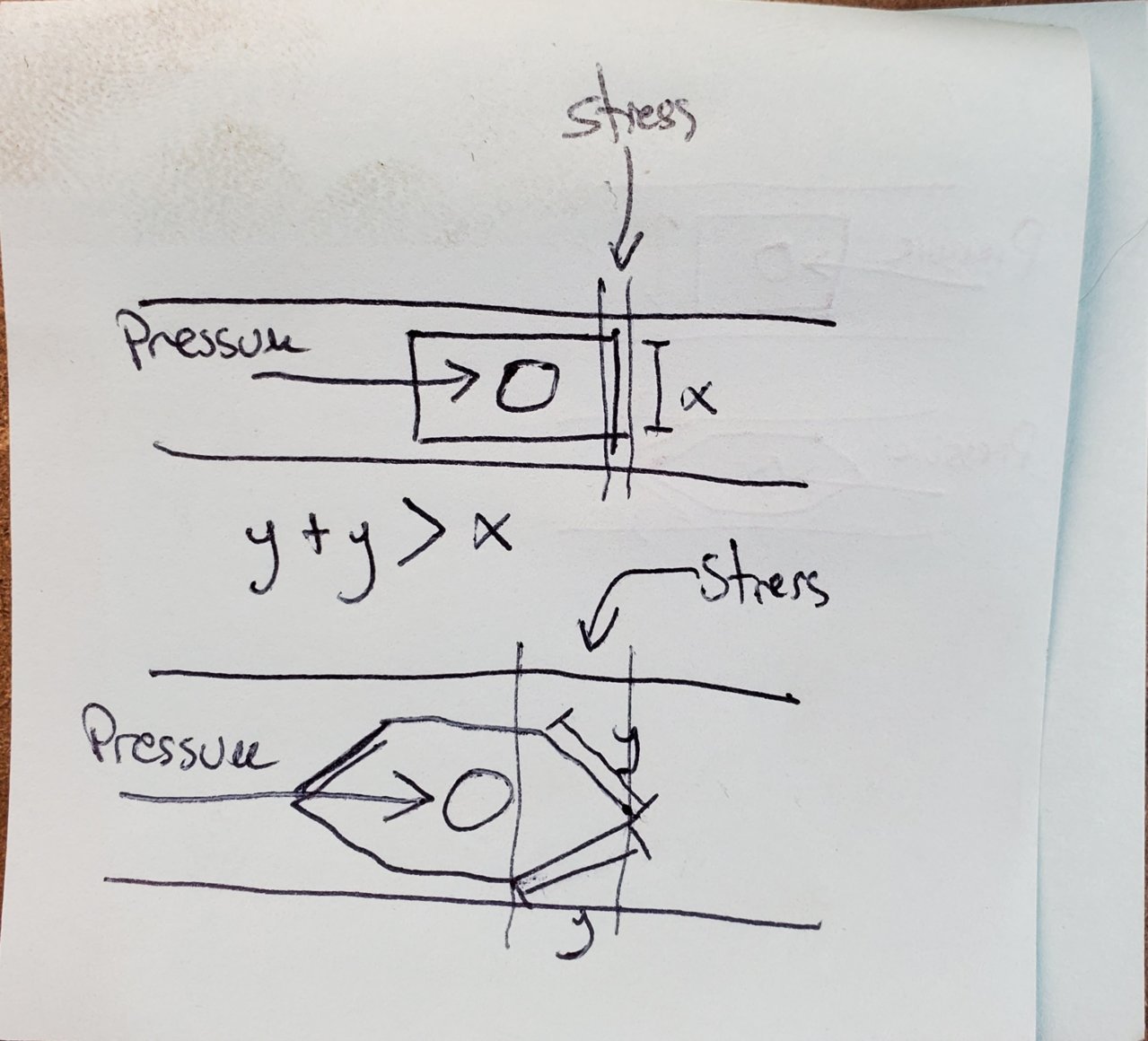

    I've heard you should only weld onto a frame on angles like that because a straight up/down weld makes a weak spot on the frame where it can crack.

    That would imply your weld had made a stress concentration which would be indicative of an improperly made weld.

    It's less about the weld, and more about the stress being spread out over a larger area

    What area - maybe if you post a diagram. If you cause the metal to crack at a joint that wouldn’t have formed before, you’ve made the material brittle.

    I dunno if my quick sticky note drawing helps. Also, this is just stuff I've read and been told by other fabricators, but I don't have a tonne of personal experience.

    Your diagram has a bigger plate in the second drawing. You could make any shape and spread out the force with simply making it bigger.

    Need me to get out my ruler? The principle is still the same despite my drawing sucking...
    I found this on pirate 4x4:
    [Here's a quote from] "Welding Fabrication & Repair" by Frank Marlowe, and "Welding Essentials" by William Galvery and Frank Marlowe. . .they both say the exact same thing. . .
    . . ."Do not place any welds perpendicular to the channel. Welds perpendicular to the channel concentrate stresses on just one section of the weld. This is because end welds on the patch plate prevent beam stress from being distributed evenly along the weld length. They become a new stress raiser and will produce near term failure."
    Take it for what it's worth, I'm not trying to insult anybody, or act like I know more than @81Trekker . I'm a noob when it comes to fabricating and welding. I'm just passing along something I've heard from a few fabricators that I know, whether it's true or not you can decide for yourself. :notsure:

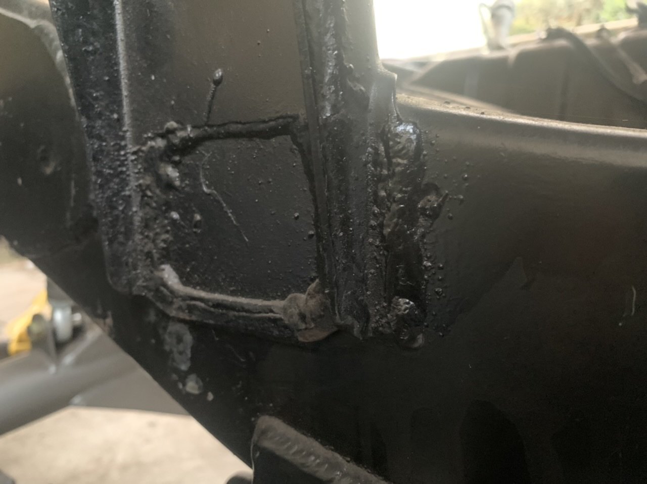

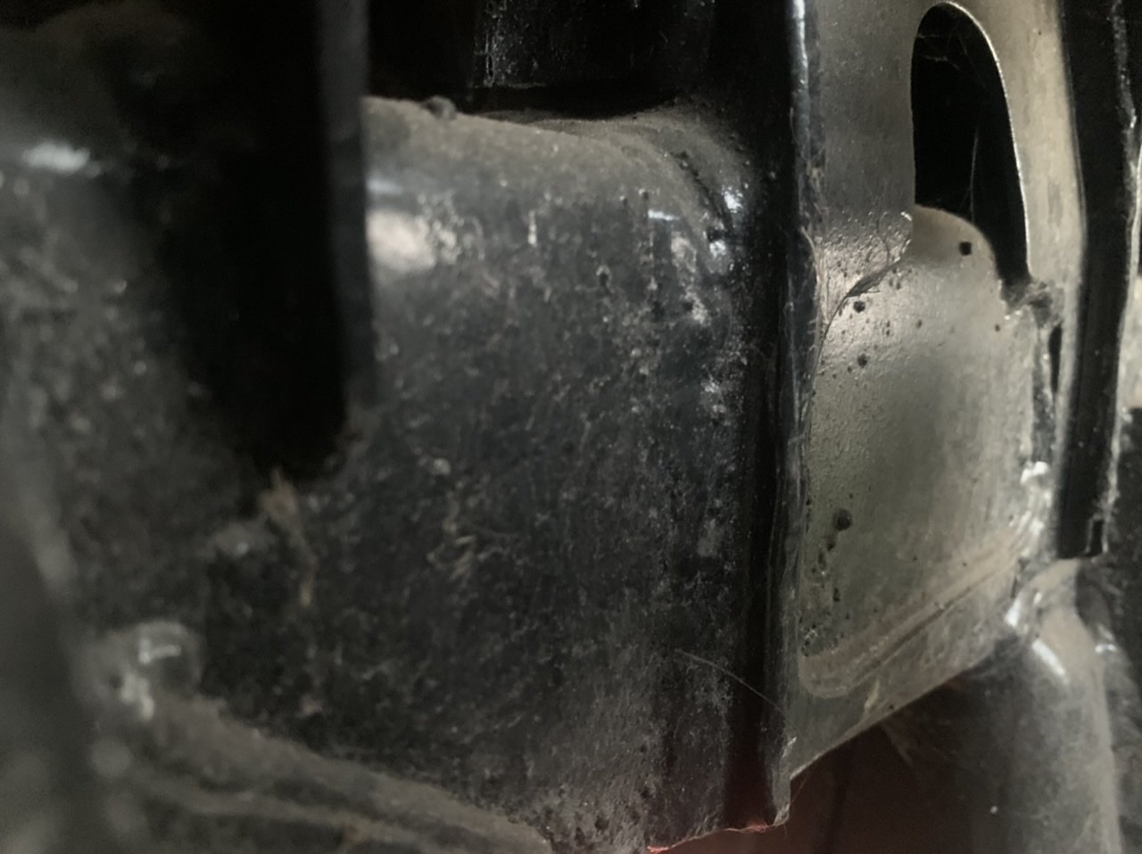

    Way too general. Each situation is going to be unique. Have you looked at your frame? You should email Toyota then.

  16. Oct 9, 2020 at 7:26 PM
    #2496
    WormSquirts
    WormSquirts Armageddon
    Dec 18, 2015
    #172583
    2,883
    Braeden
    BC
    Because Toyota frames never have problems. They're the gold standard, don't you know?! :rolleyes: :rofl:
    Either way, it can't hurt.
    05Taco4x4, bhigbee, Arcticelf and 4 others like this.
  17. Oct 9, 2020 at 7:34 PM
    #2497
    ovrlndkull
    ovrlndkull STUKASFK - HC4LIFE
    Jan 7, 2017
    #206806
    37,785
    Skip
    Burlington, NC
    2005 DCLB Silver
    63s, XD Machete, Beat not Babied
    Then I guess my RGF CMR, AG shock relocations, etc are done wrong too because of the vertical welds. You could also say that the potential for a having a plate welded like that with the points in the center of the thin frame could point load and start deforming the frame at that point vs a long vertical line spreading the load to the top and bottom bends which are stronger than the center of the frame. At that point it's more semantics so to speak and also potential for something or a load happening to cause either or.
    Torspd likes this.
  18. Oct 9, 2020 at 7:43 PM
    #2498
    Dalandser
    Dalandser ¡Me Gustan Las Tacos-mas!
    Feb 19, 2015
    #149090
    17,611
    Anthony
    Downey
    08 PreRunner Regular Cab / 98 4x4 Extra Cab
    Empty Wallet Mod
    A quote taken out of context vs. millions of vehicles that haven’t failed at the bed or shock towers. Not buying it.
