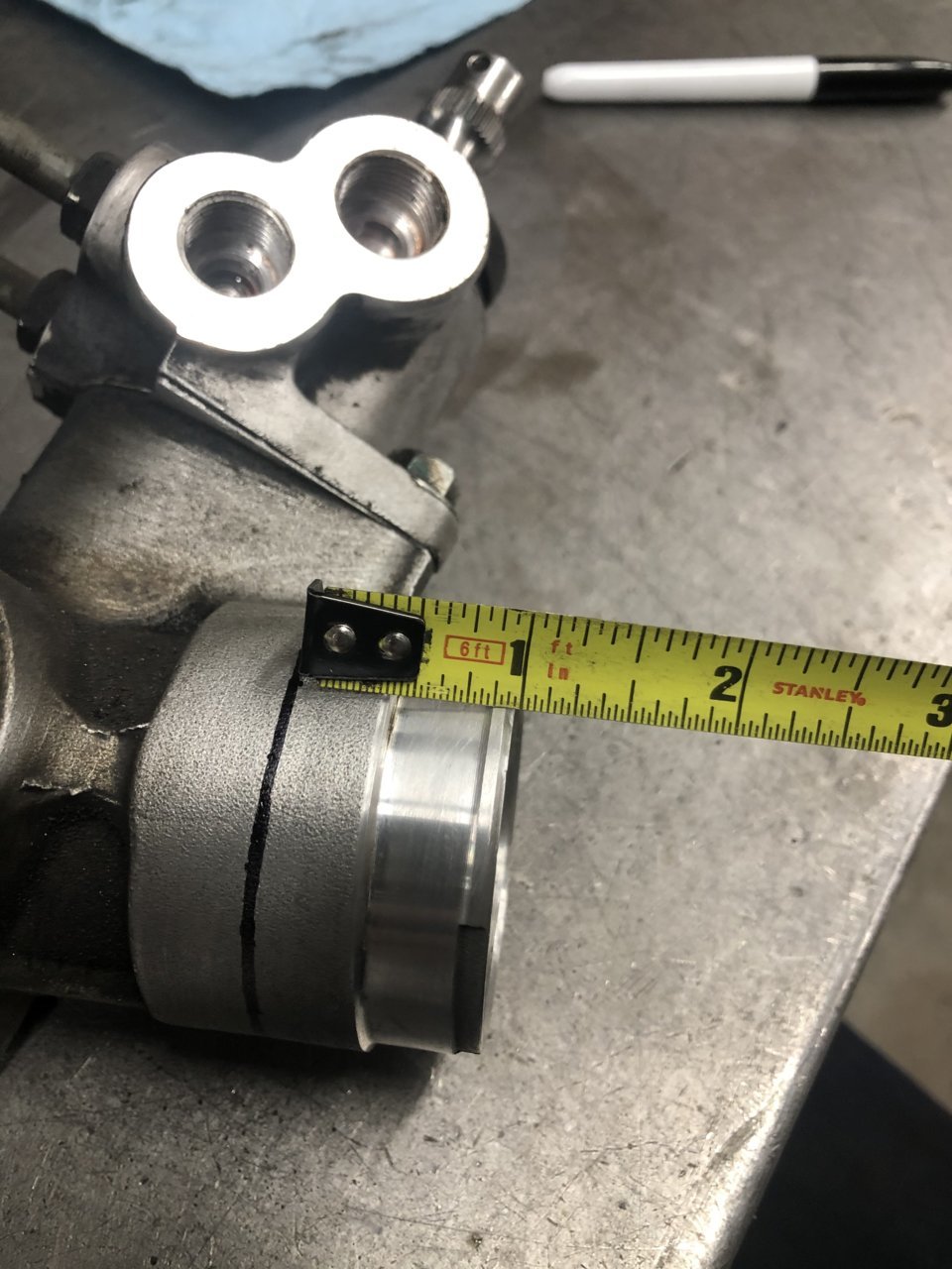

    @81Trekker I lost my power steering over the weekend, my rack finally bit the dust.
    When you install the slide rack, do you have to pull the rack to install it? Or can I install a new rack now and then install the slide rack afterwards without doing too much of the same work twice?

    My guess is you’ll want to pull it out for the extra room to cut and weld the frame to make clearance for the slide rack

    Yes everything has to get pulled out as the rack needs to get modified for the slide rack to work... you trim off 1” of the casting as seen in the pic below

    Gotchya. Thanks! I'll probably just have to do it twice then ha.
    Appreciate it!

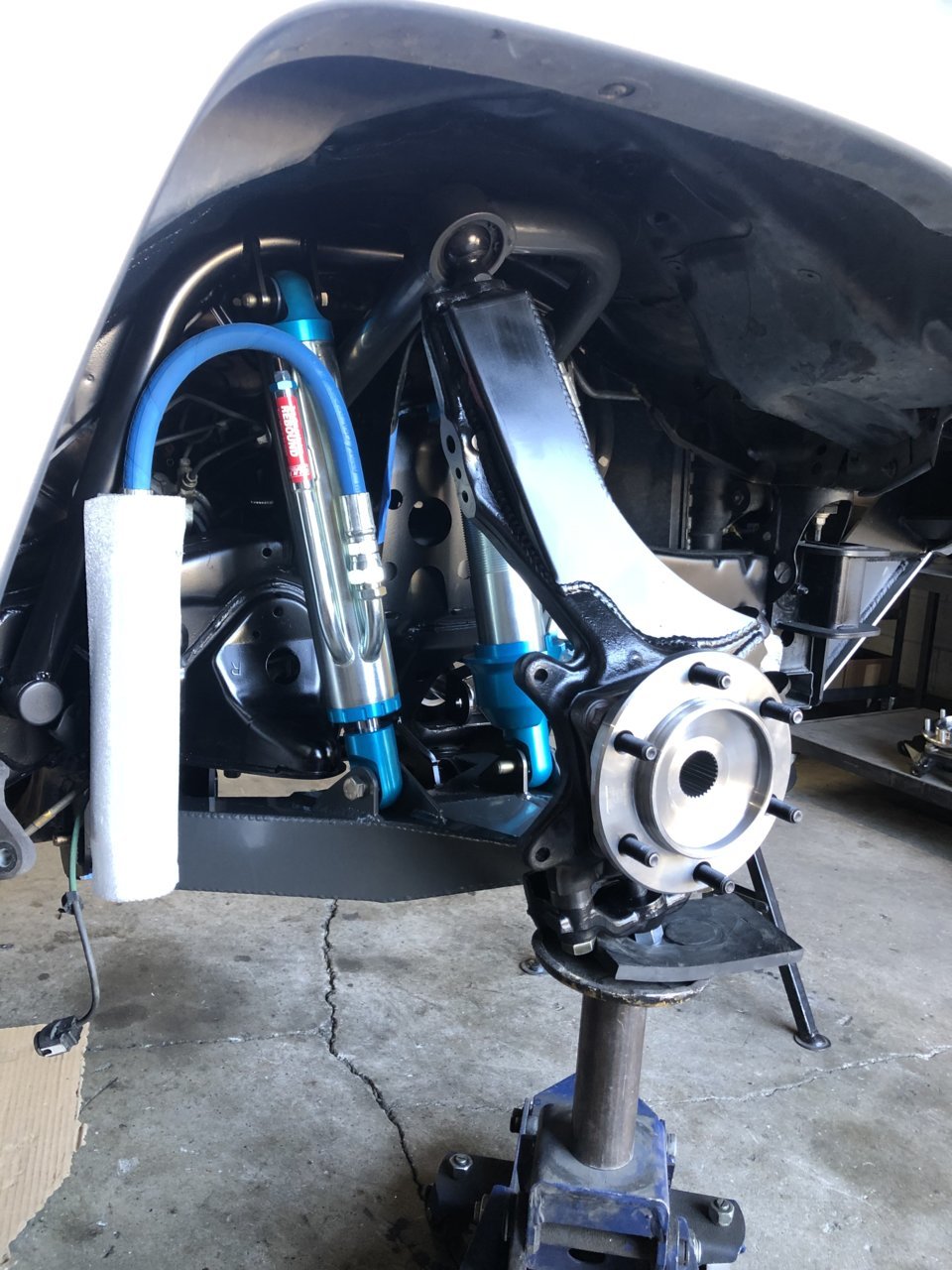

  19. Oct 14, 2020 at 7:38 AM
    #2559
    snowsk8air2
    snowsk8air2 how hard can it be?
    Sep 16, 2011
    #63607
    10,473
    Flagstaff, AZ
    Supercharged TX Pro
    2011 S/C and basic mods
    This does get me aroused in all the right places
