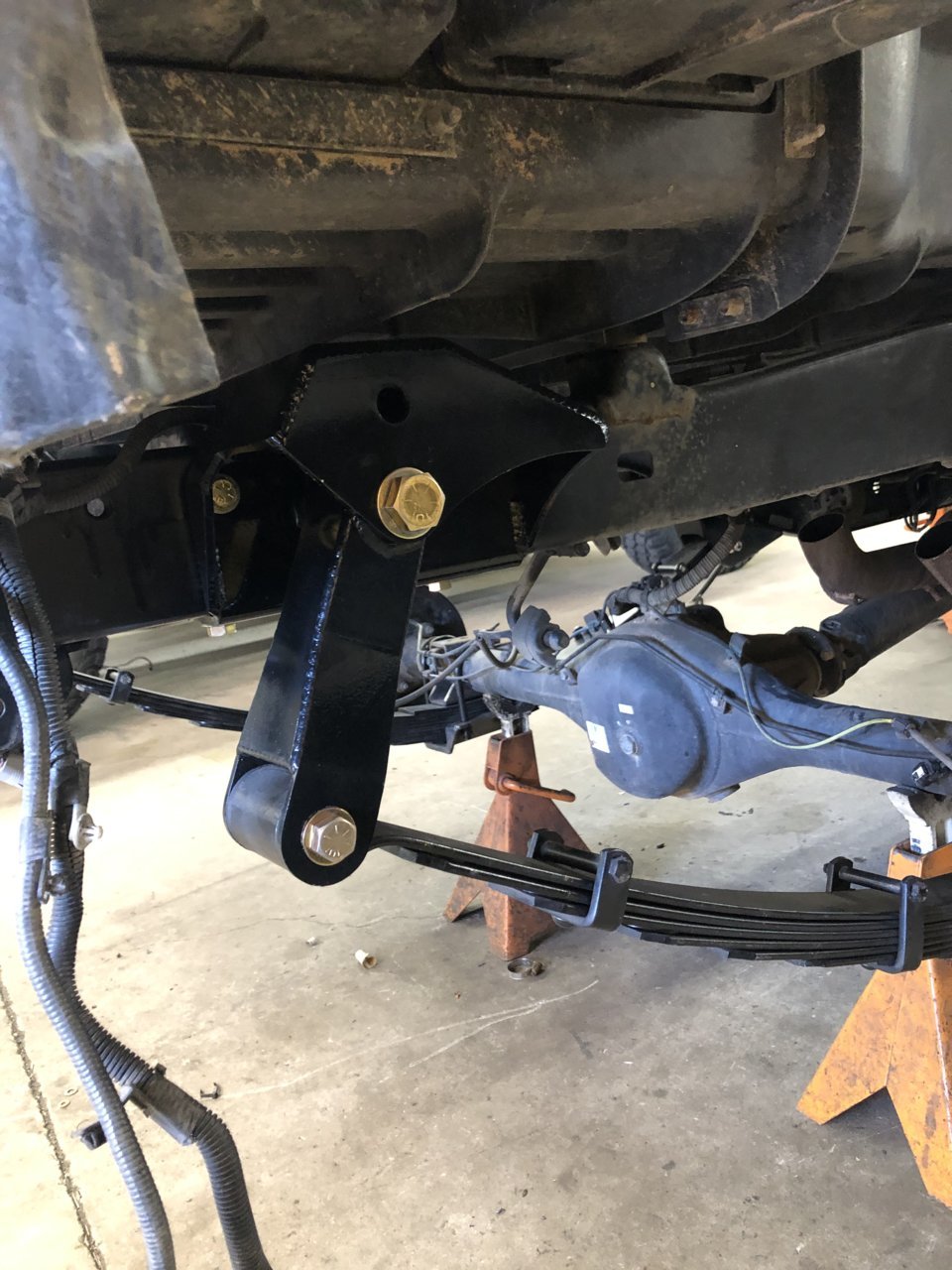

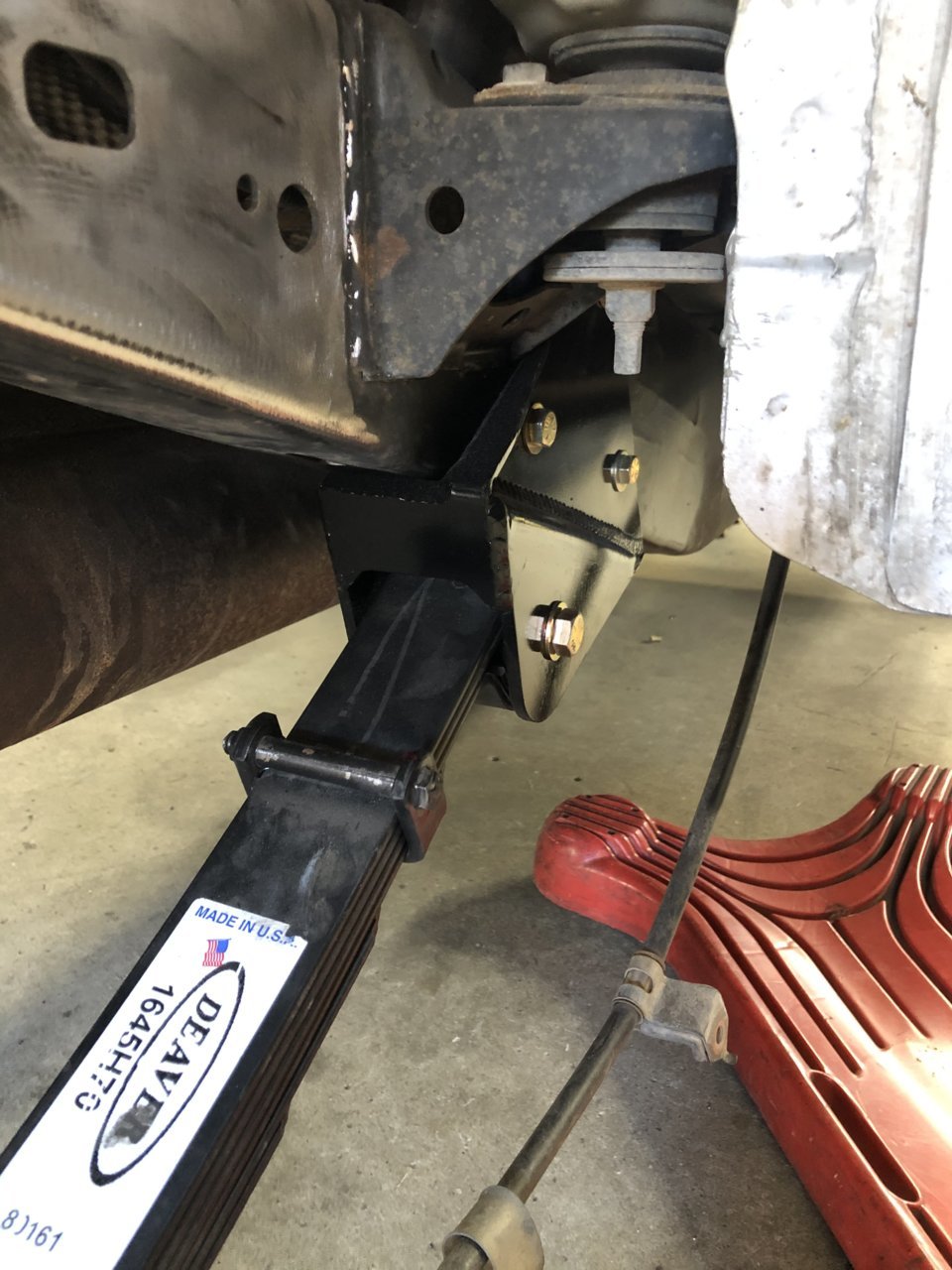

    Loving the bolt on 62” spring under shackle flip kit. Cycles 17” with stock frame and 19” with frame notch

    @Anthony250 looks like the 1st gen TC layout.

    It’s very similar to how we have been doing 79-95 Toyota’s for over 20yrs... it’s a very proven and effective design

    First gen 62" setups are really similar and TC sells some of the same parts on their site that work the same way for pre-comas.

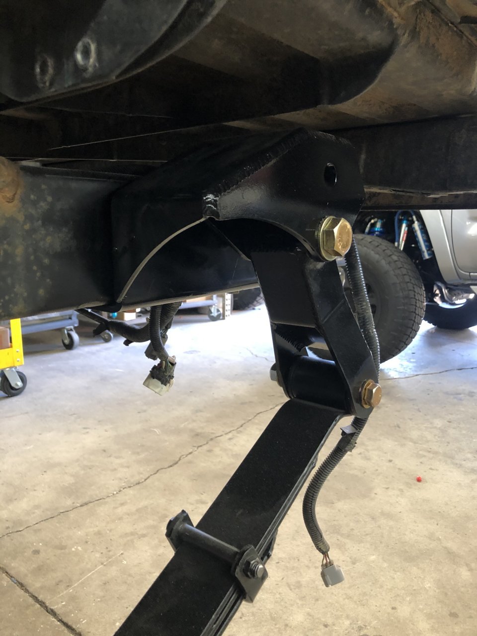

    Holy shock mounts!!

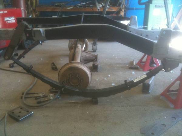

    :facepalm:
    Way wrong picture altogether. Everything's replaced on that.
    Different truck:

    Interested. Is this a JD product then?

    Yes

    How do those front mounts bolt on - stock holes? How do the rear hangers mount?

    Everything is 100% bolt on into stock holes, no drilling is required
