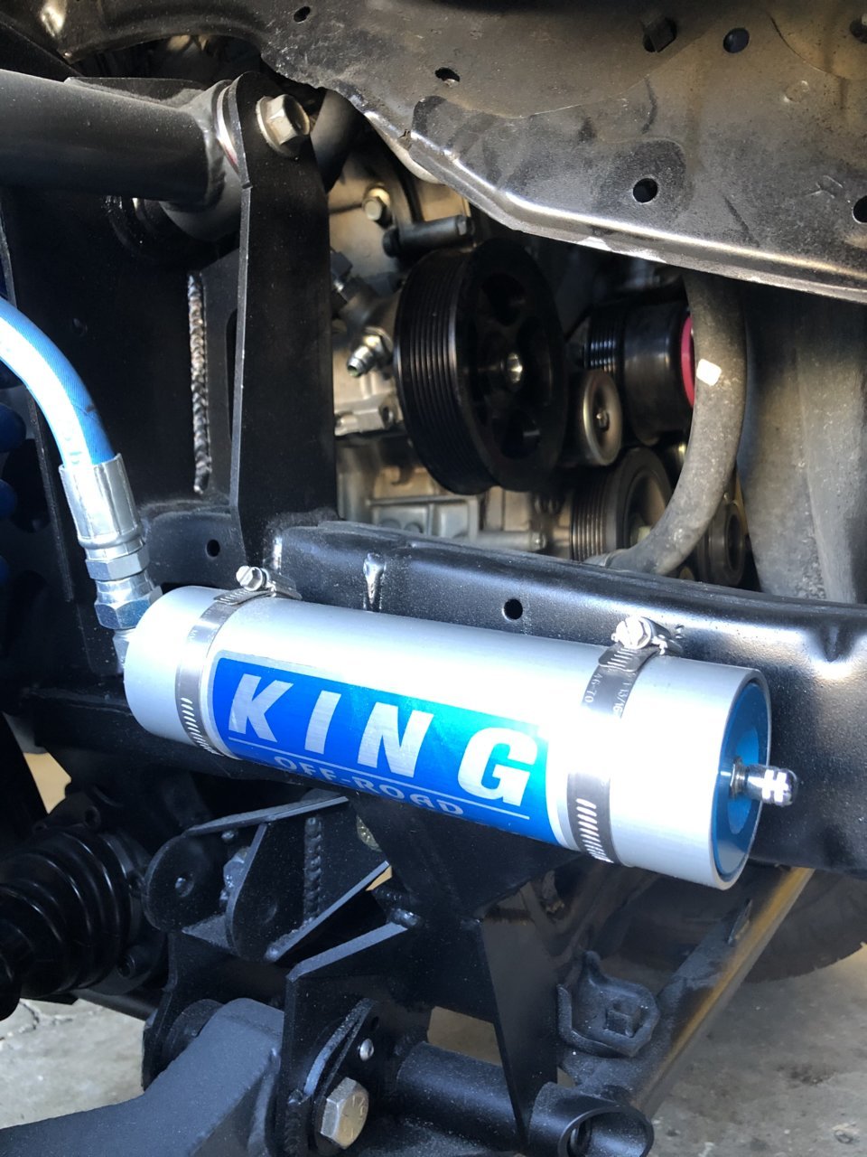

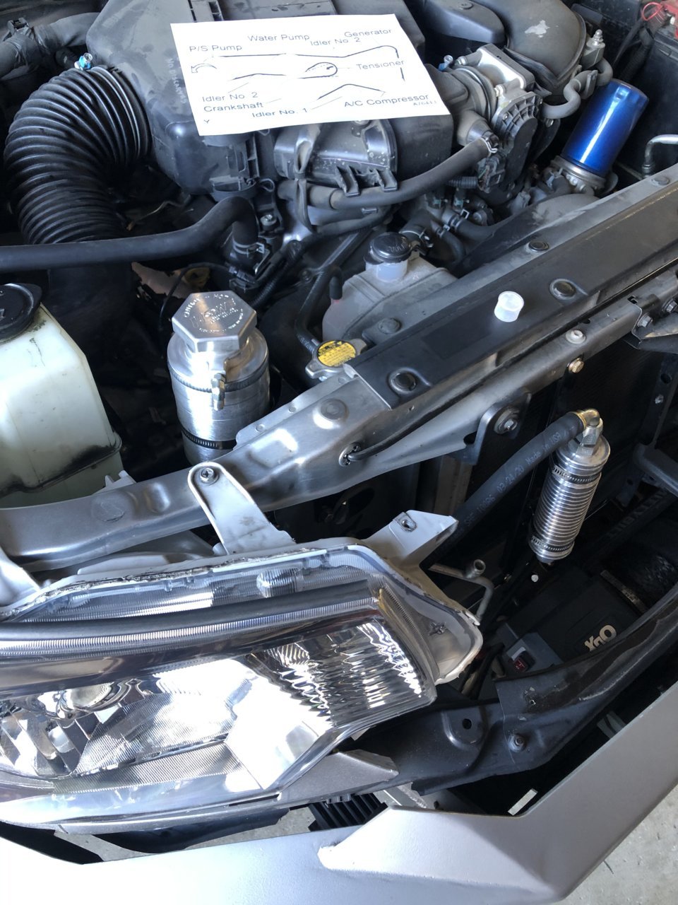

    @kasnerd Howe steering system installed

    To clarify the full system..
    -Howe Pump, reservoir, and line cooler.
    -Stock rack with additional support bushings.
    -And a rack-saver brace
    Did I miss anything?

    Does the pump just bolt up or did you have to fab a bracket?

    It just bolts up with some adapter bushings we made

    You can add a 1.5-1 quick steer too if you like
