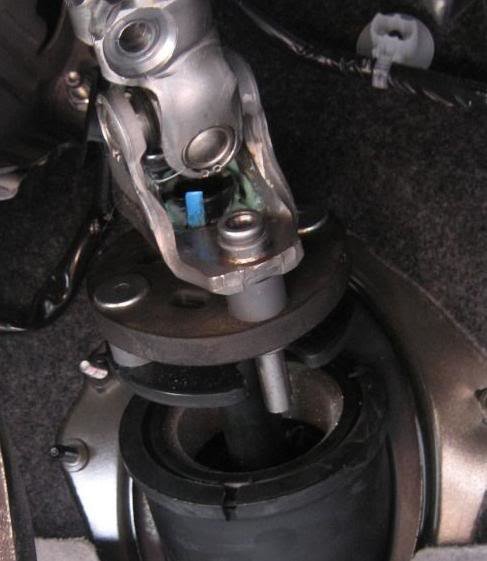

    I’m calling whatever this thing is the rag joint. And they are nice and sloppy from the factoryupload_2020-10-30_6-59-0.jpg

    I stand corrected. But from the pieces shown the quickener will probably not remove that piece just the intermediate shaft.
    Thats an easy piece to have made as an aluminum disc to make it a solid mount

    Mine is nice and solid courtesy of yer good ole zip tie
