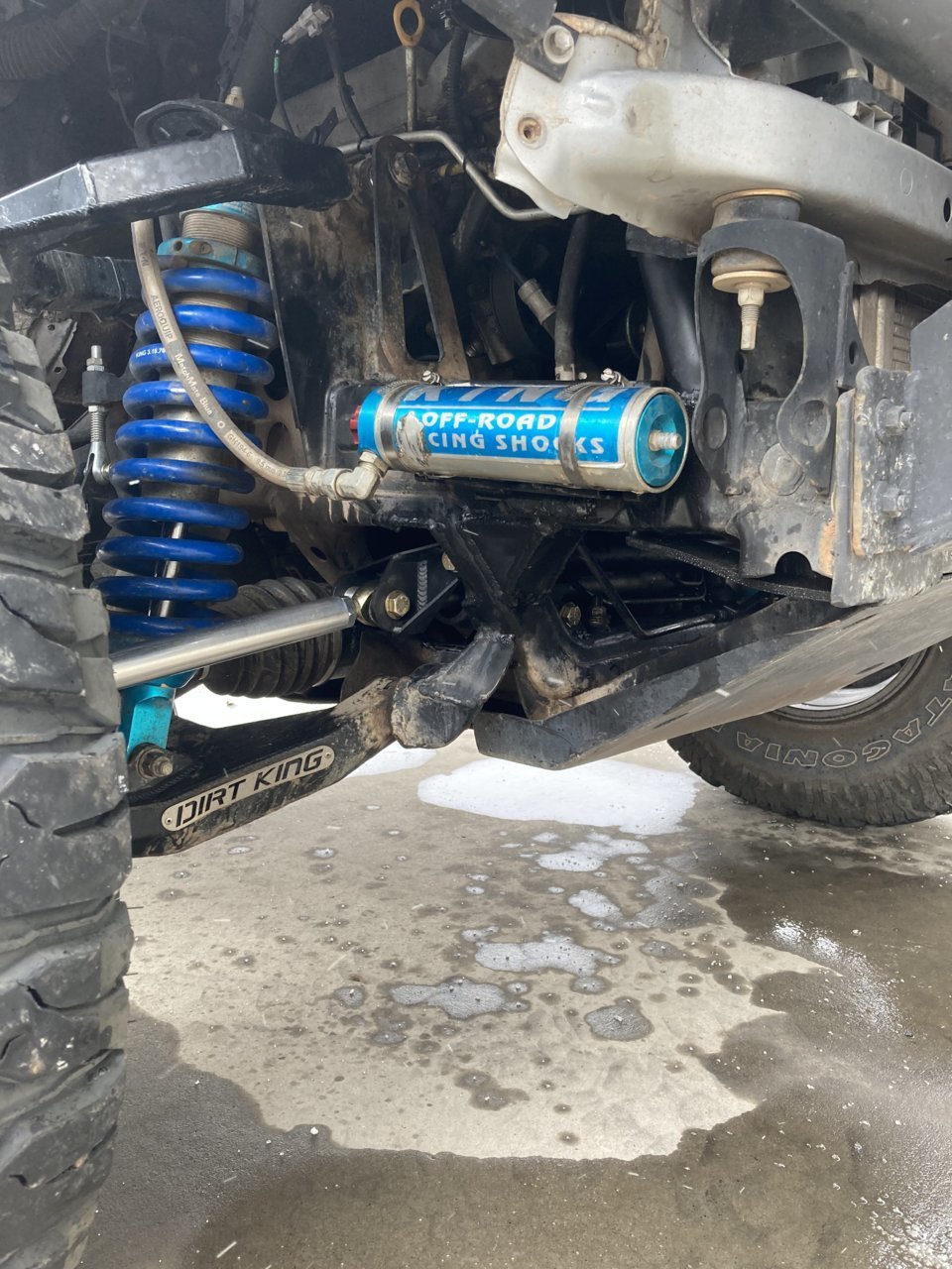

    Makin me go outside in the cold and snow. Truck is a nasty mess that needs a good tear down and cleaning. Uniballs were borderline I should have replaced them so maybe after winter I’ll do that and clean things up better.
    51AF8360-4A40-41E2-BEF7-401249FE8ED5.jpg 6F0C179F-7727-4800-9A24-A6BC58F4BA78.jpg
