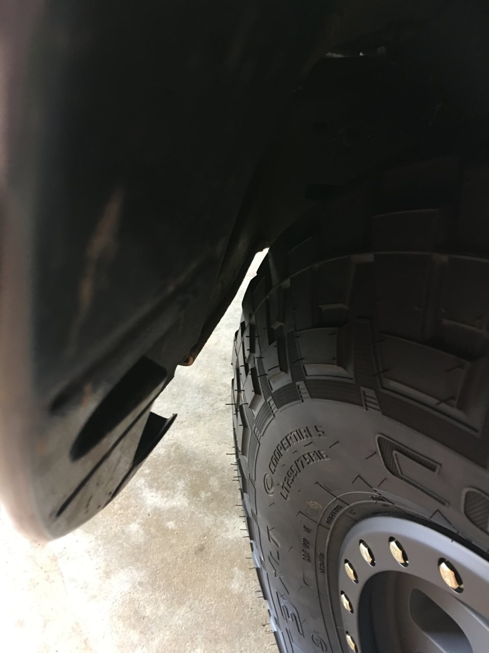

    any rubbing while driving? my 295s clear the cab mount while stationary on the driveway but will rub at full lock reverse when driving. It doesn't rub at all while moving forward though.

    What offset wheels do you have and what are your alignment specs?
    And what does it look like at full bump, full lock?

    that i cannot provide lol.. my alignment guy refuse to give me the sheet printout. but its on spc uca and 0 offset method.

    What happens if you bottom the truck out while turning?

    I wouldn't know for sure.. I haven't cycle the suspension while testing other than driving it onto a small ramp and full lock with clearance. I was just wondering if your current setup right now will rub on the street while reversing in full lock.

    I already did my CMC prior going offroading, but this was just my experience before i did the cmc.

    This is true even for smaller tires. Mine are constantly self clearancing but that's due to the offset and width of the wheel. My set up is really aggressive it's a give and take. I like a square stance and can't stand rear wider than the front or visa versa so mine are stuck out pretty far. That and also it helps with keeping the body away from possible damage on our tight trails here in the SE.

    It clears all the way through the travel lock to lock
