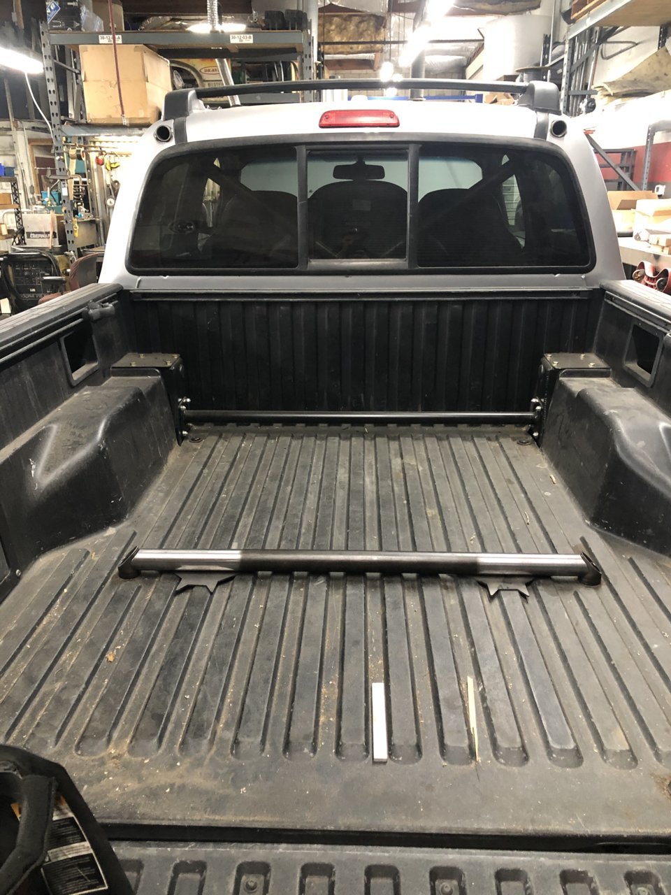

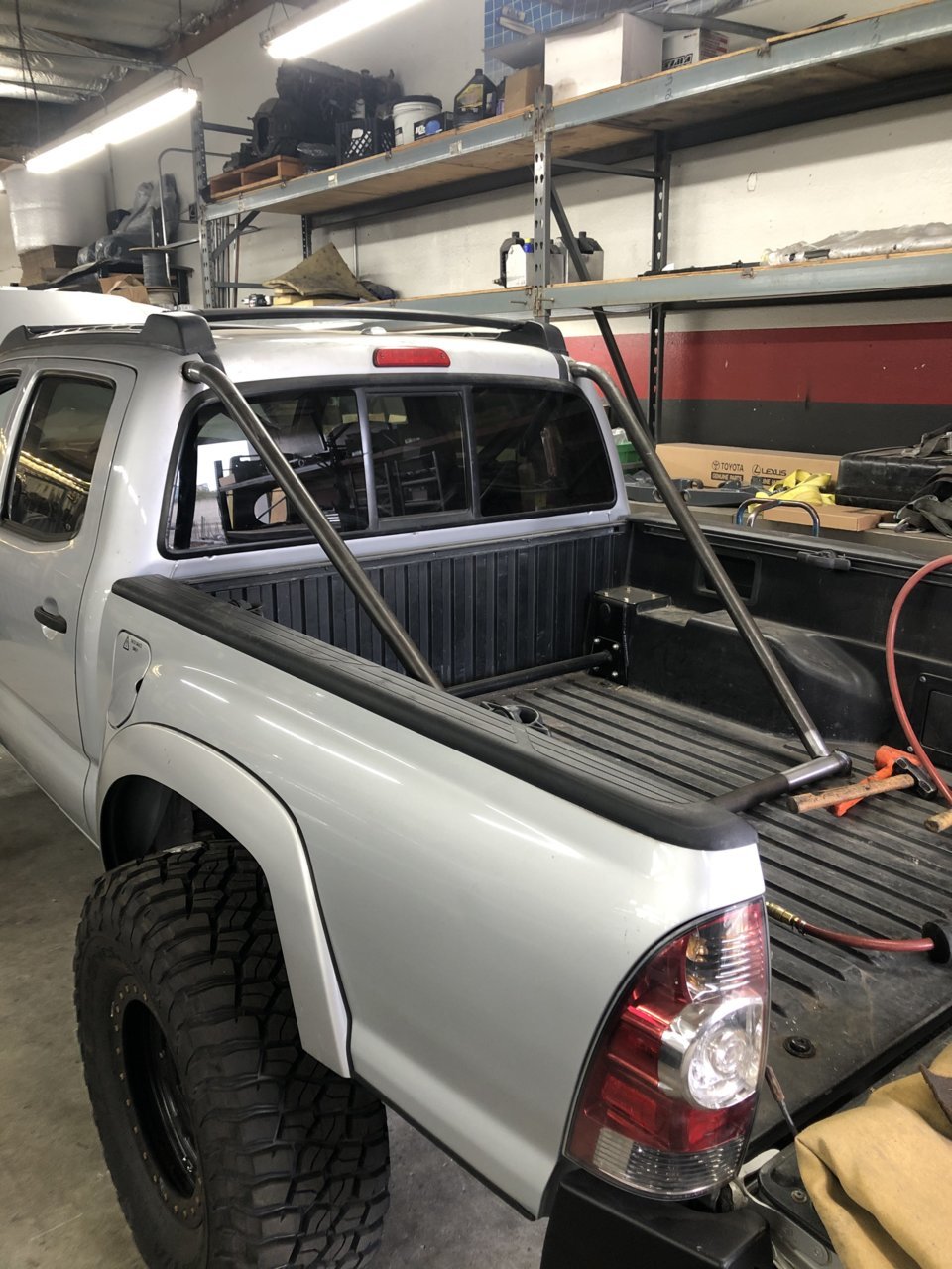

    Bed cage is going down...

    As in travel numbers? He said 15", on page 124. Price numbers, idk.

    Are the bed to cab bars bolted in place with interlocking tube clamps?

    They will get installed when I’m done so the entire bed cage is removable

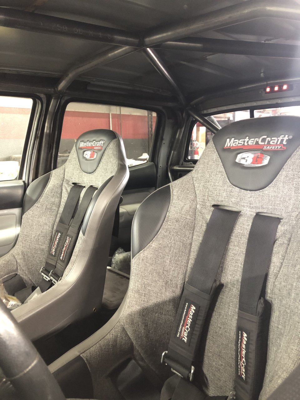

    Are you still going to put the pillar trim and headliner back in? Or will it not work?

    Having it wrapped in suede so you won’t see any of the cage at all
