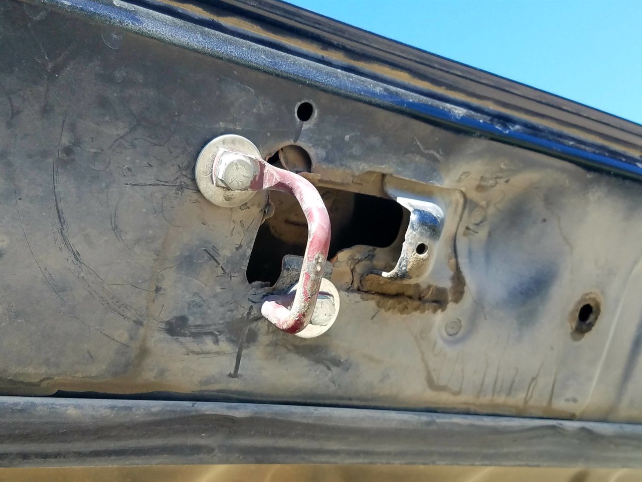

    I have hood pins pretty much same thing where your catch is mounted is where mine is just the core is ripped through allowing the wind to lift up the support around the headlights. If I had a fabbed one like you it would be fine but I don't.

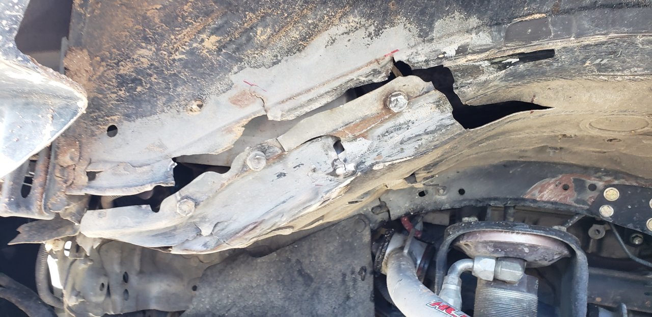

    Well shit my core support is gone now....just fucked up fenderwells now

    Mine were mounted to the core support that runs thru there...it broke the shit in half over time.
    Before it broke the core support in half
    If you go aerocatch make sure you get the kit with steel catch pins the aluminum pins will break. I bought the steel ones thru summit to replace my broken aluminum ones.

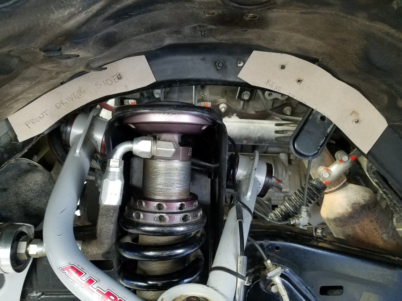

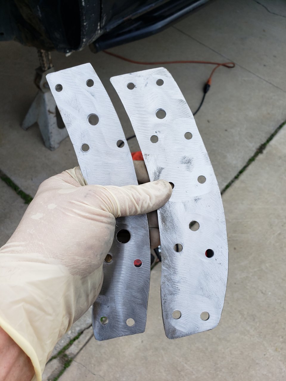

    Nice! Had do do something like that myself
    On my 3rd front end/core support now... good thing people keep crashing into me i guess

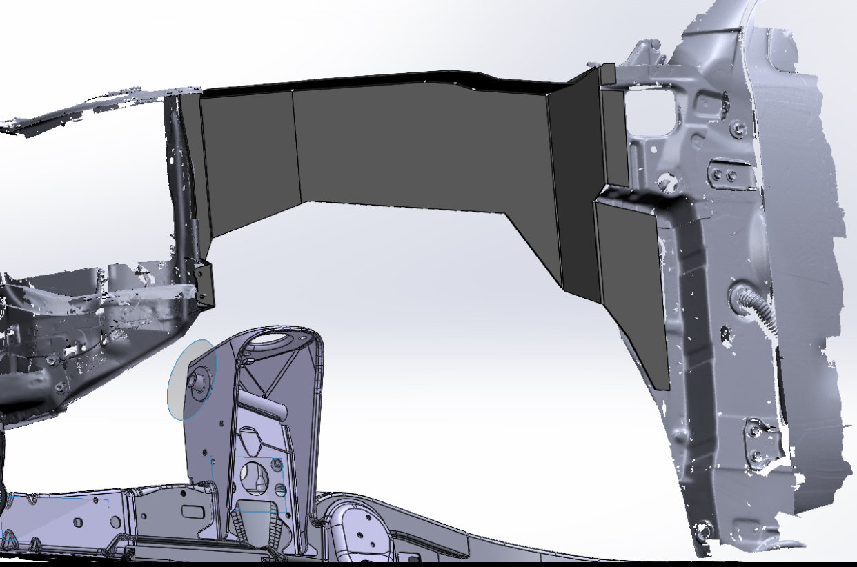

    You guys better start saving your pennies... these are gonna be rad!! 4” of increased wheel well clearance where it’s needed most

    Those weld in or bolt in?

    They will be all bolt on
