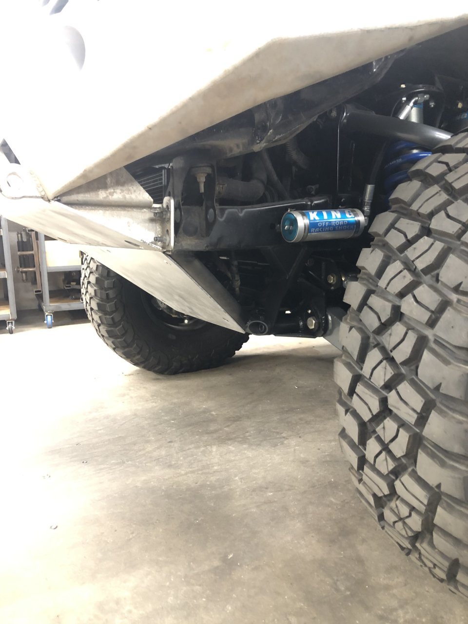

    That's awesome. I still need to build the front and rear skids on mine. As well as get the front bumper built and chop the cross member off. Would love a closer look at what you did for the front skid!

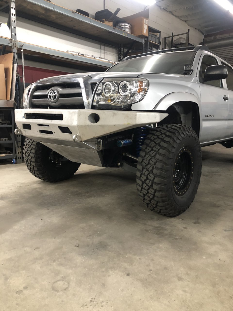

    Looks like an awesome 3D Scan imported into SolidWorks!? Man that’s awesome stuff

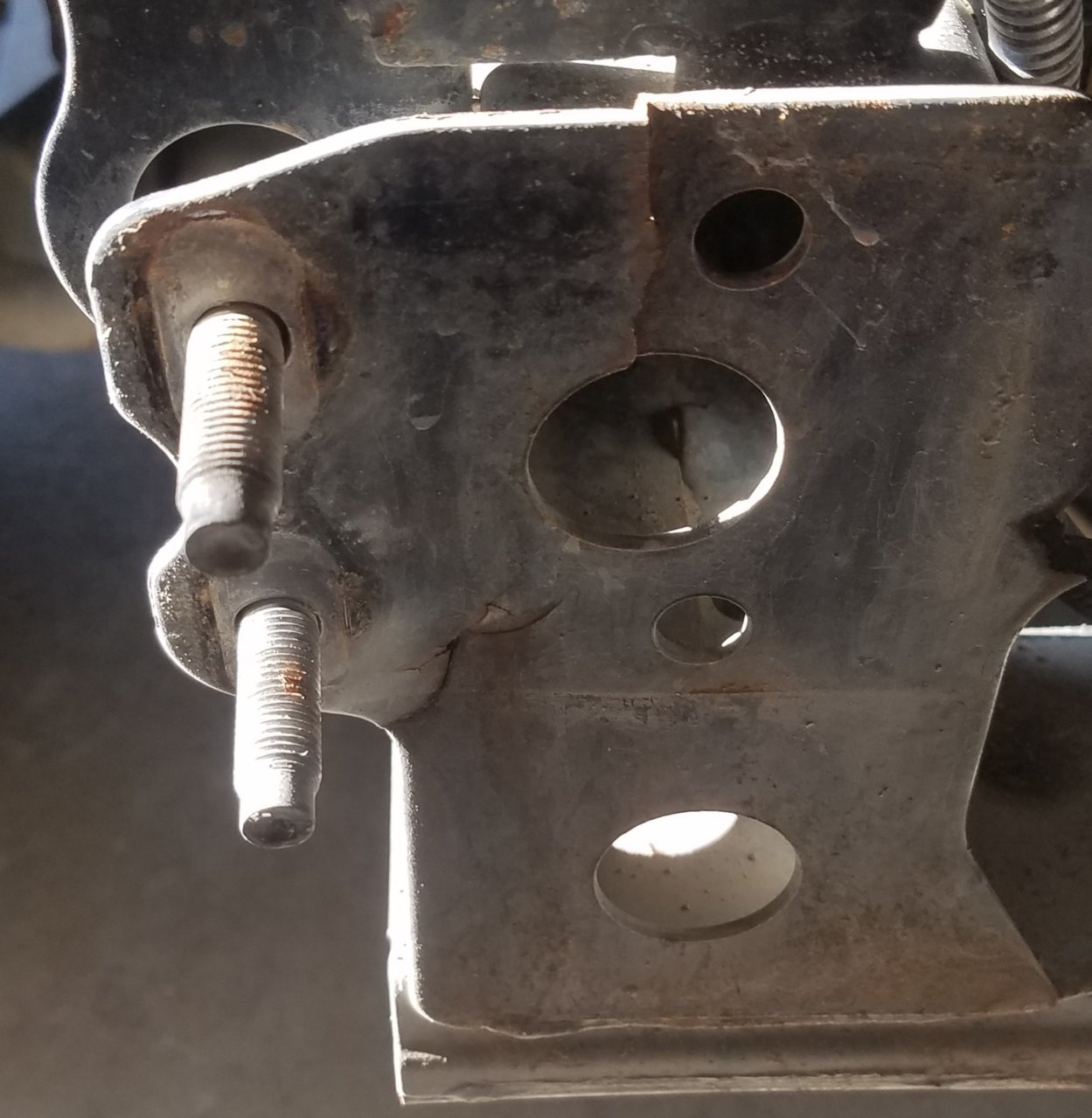

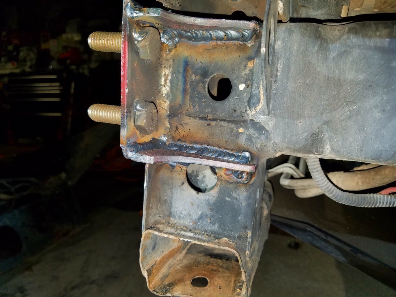

    Did you do anything to beef up the frame horns where that bumper attaches to? Mine are bent to shit from winch pulls and just front driving around with the weight of the bumper there where Toyota only intended for a crash bar

    Yes there is a new crossmember that ties the front frame rails together and then tubes that come up from the LCA crossmember to triangulate the entire front frame

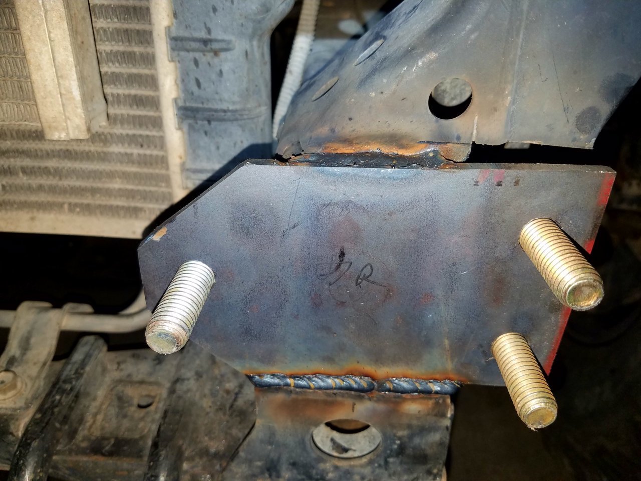

    You'll need to rebuild it. I used 3/4" hardware when I rebuilt mine. I think my frame horn redo will be the next add to my build thread, thanks for the reminder..

    Yeah that’s what I was referring to. Mine haven’t cracked yet like in your first pic but is just a matter of time. 1/4” plate I assume?

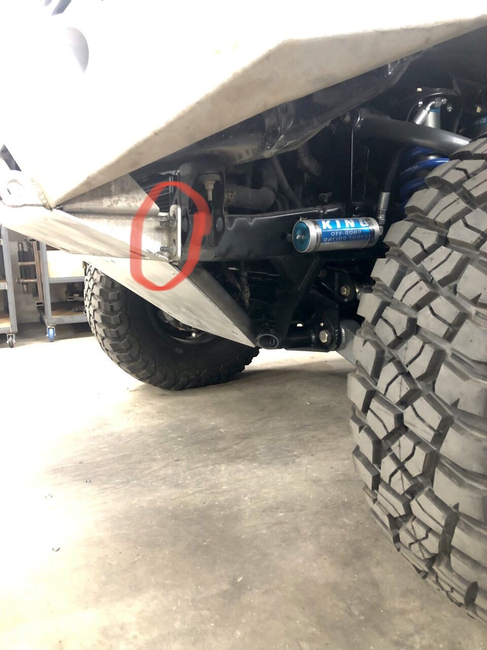

    look inside the red circle. Those are the OEM attachment points which are the problem. Maybe not so much for that truck bc that bumper looks to be aluminum and has no winch

    The entire bumper bolts to the new front crossmember using 3/4” bolts. The OE attachment points do noting on this truck

    But they’re still there and look to be in use unless that pic is old. Anyway, I think a lot of us would love to see more pics of that. I love how that came out! Wanna do that to my pelfry hybrid bumper
