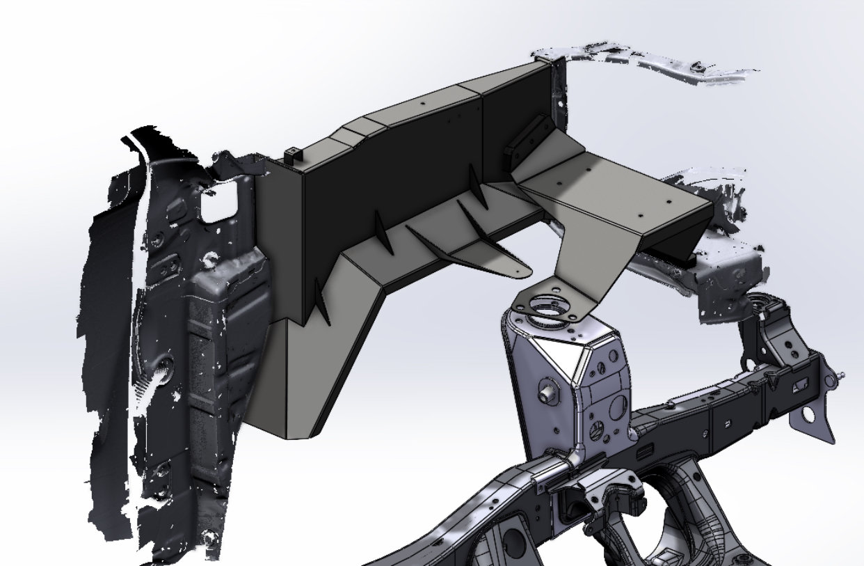

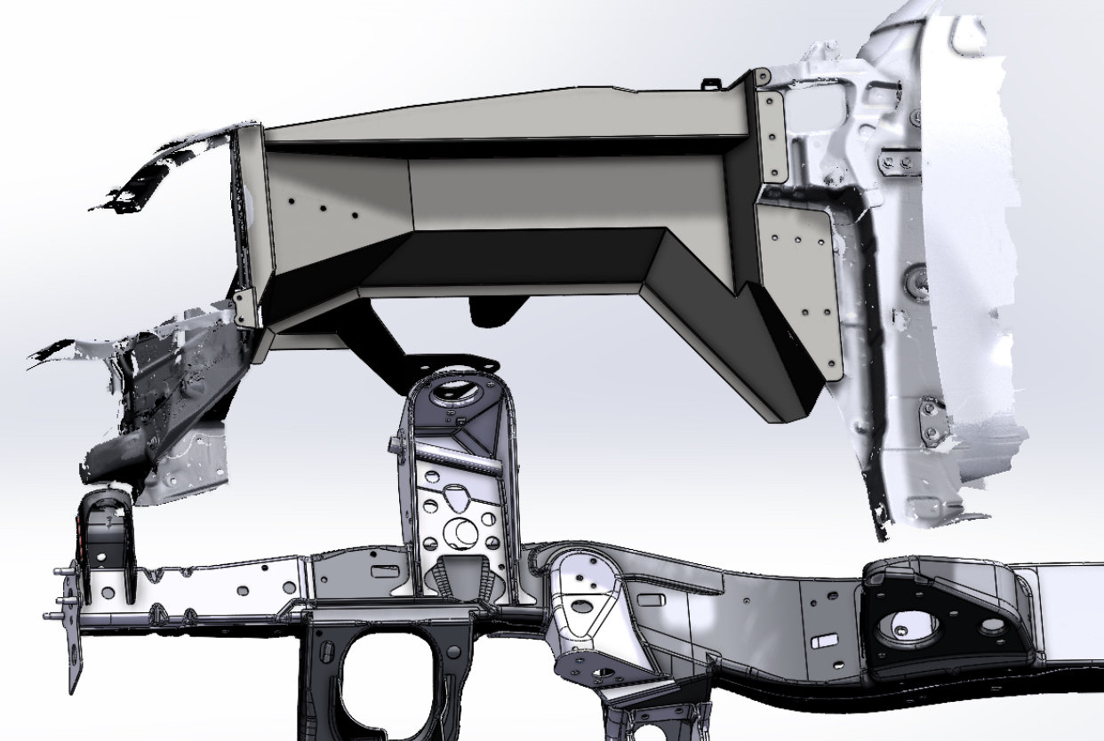

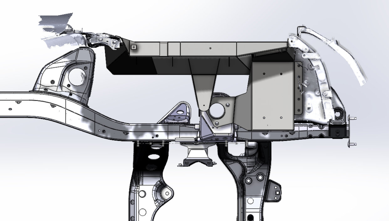

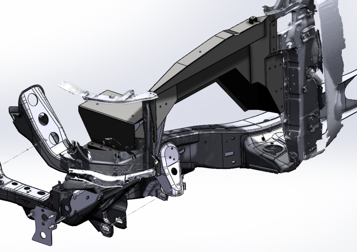

    More inner fender updates
    Slashaar, tyfoon11, Mully and 14 others like this.

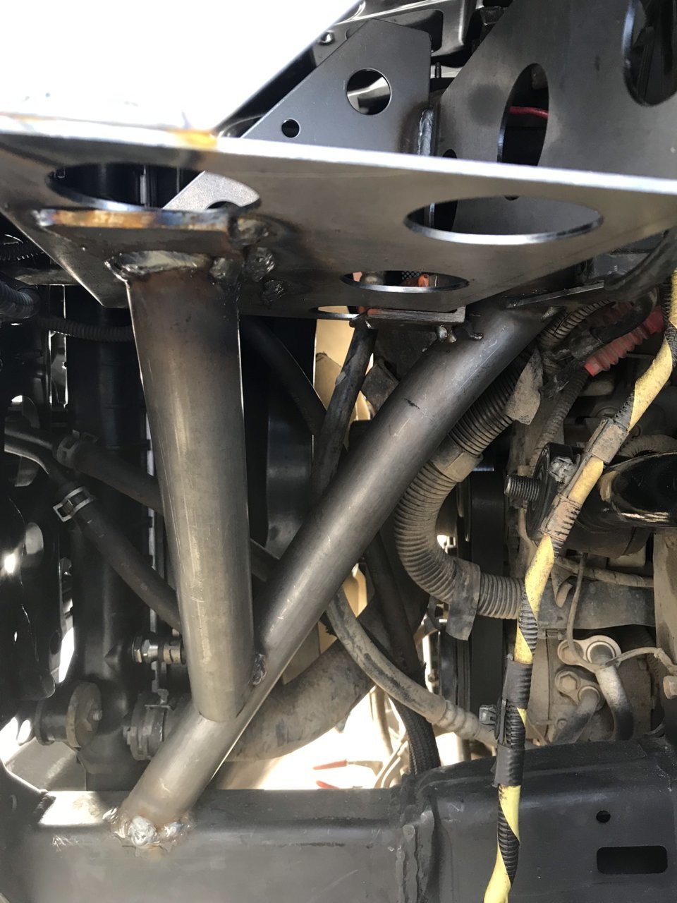

    Front suspension: Work in progress JD Fab +4 LT, LCA pivot kit, steering slide rack, 934CVs Rear suspension: Archive Garage shock relocation and SUA Conversion,King 14x2.5 shocks, King 2x2 hydro bumps, FN wheels 5 stars, sliders
    I need a whole new radiator core support. That mess is starting to rip under the tail lights.

    You can buy new front sections for cheap and then attach them to our inner fenders

    Yeah I’ll end up going this route, mount the battery in the bed. Any goodies from powder coat yet?

    I like how the Battery Tray ties into the coil/over tower, that is key!!!!

    I don’t think so. Have you ever shot video of you trucks front suspension? The shocks and body move independent from each other by inches, not millimeters. If the battery stays up front it needs to be supported to the frame and the frame only. The shock tower is part of the frame.
