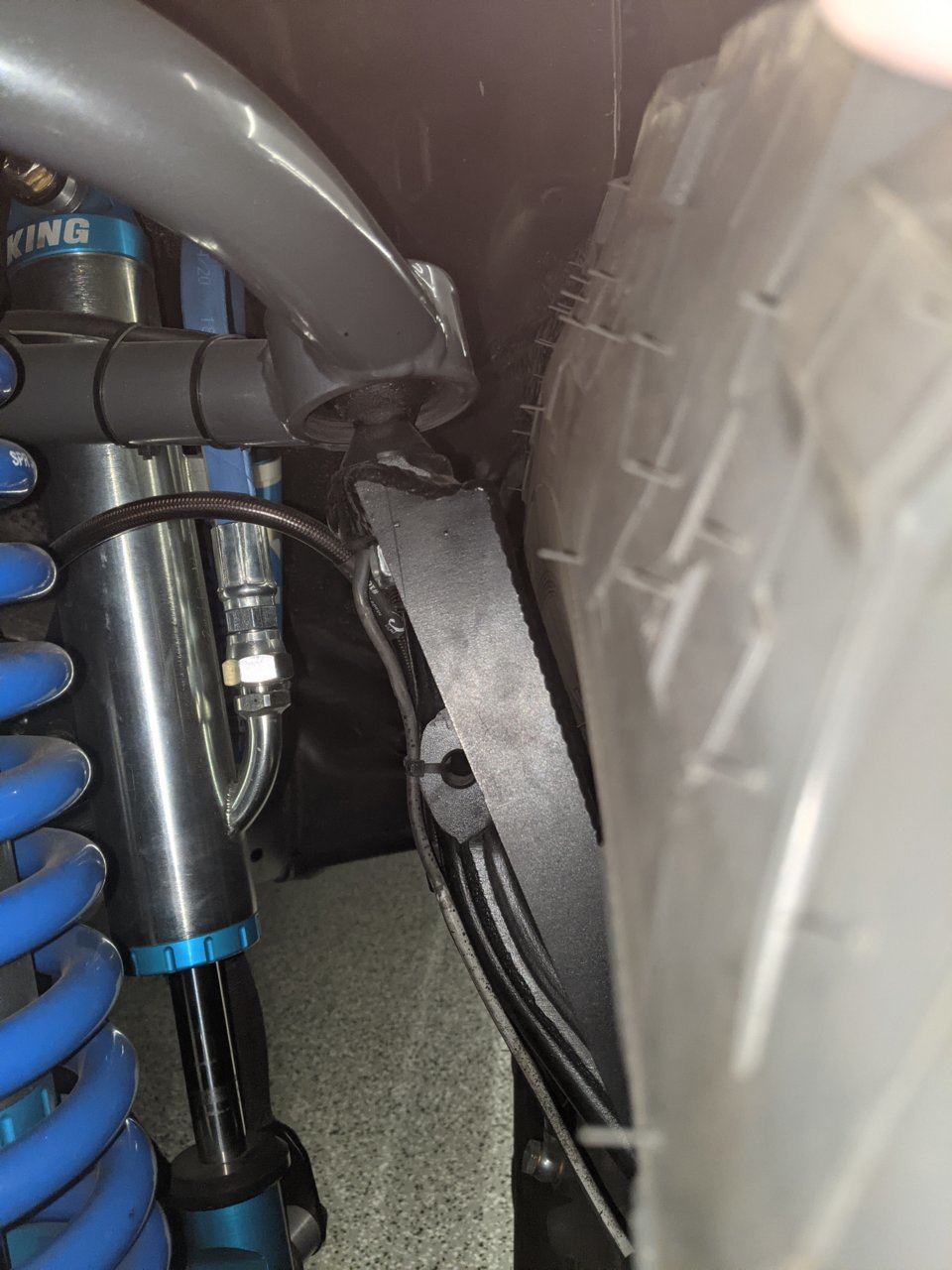

    is that 4.75 with a 35x12.5 ?
  4. Dec 30, 2020 at 2:56 PM
    #3244
    kasnerd
    kasnerd candied bacon
    Jan 2, 2014
    #119695
    2,498
    SoCal Yokel
    '14 SC LT Mall Runner
    Mods? Yes, oh yes..
    Yep 4.75bs with 35x12.5
    New TR's will be better. Not sure specs yet...would like to be able to get real chains on them for snowplay.

    woo that's tight, but it works, so I'll take it! My 37x12.5 shouldn't really be any wider, just taller, which might just move the widest part of the tire up a little bit which is a good thing, clearance-wise.

    in theory, and I suggest getting the right wheels with the specs for your tires and clearances. Kicking the spindle out 2.25" in theory should have helped...but I lost it by going with wider tires. Nitto makes a skinny that is pretty sweet. I'm running BFG AT KO2 C Loads per the wise sages at JD.

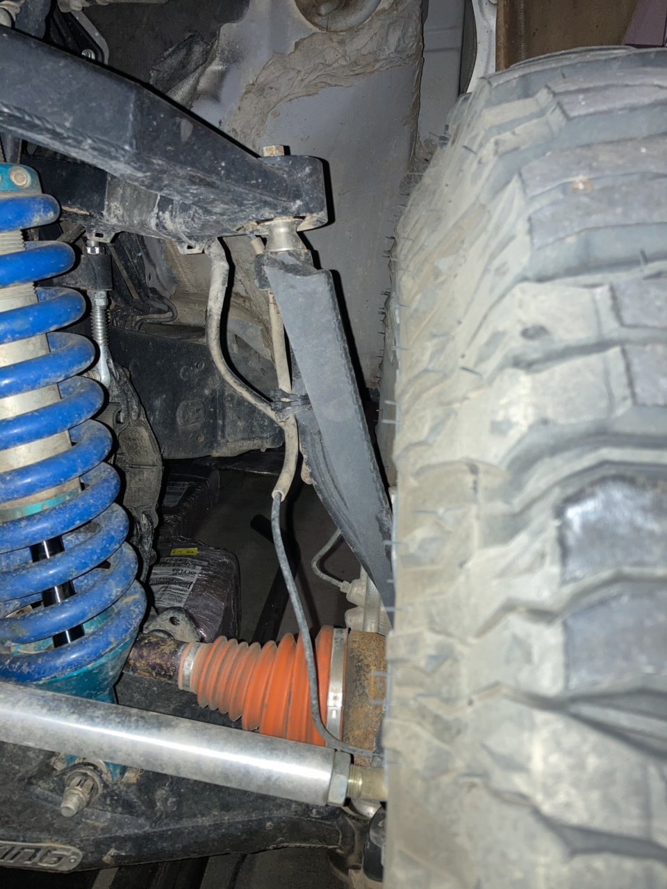

    But that’s a 3.5” bs

    There are a lot of important factors that should be given equal attention when talking about clearances, sizes and "how big of a tire can I fit.." circular discussions. Tire weight, brakes, suspension, tie rods, CVs, gearing, et al. There's way more to it than stuffing the biggest tire you can fit unless you are just speed bump romping at the mall. It's a lot to consider before heading down to the tire shop.
    Speaking of gearing...difference from stock to 35s. Regear happens next week. 4.88 nitros and front locker get installed. https://www.tacomaworld.com/tirecalc?tires=265-70r16-317-70r17

    Of course, I'm well aware that I'm not in the clear yet, but at least it's not impossible.
    I also have the +2.25 kit, same set up. The tires I got are the Nitto Ridge Grappler 37x12.5R17
    1.25" of clearance? haha
