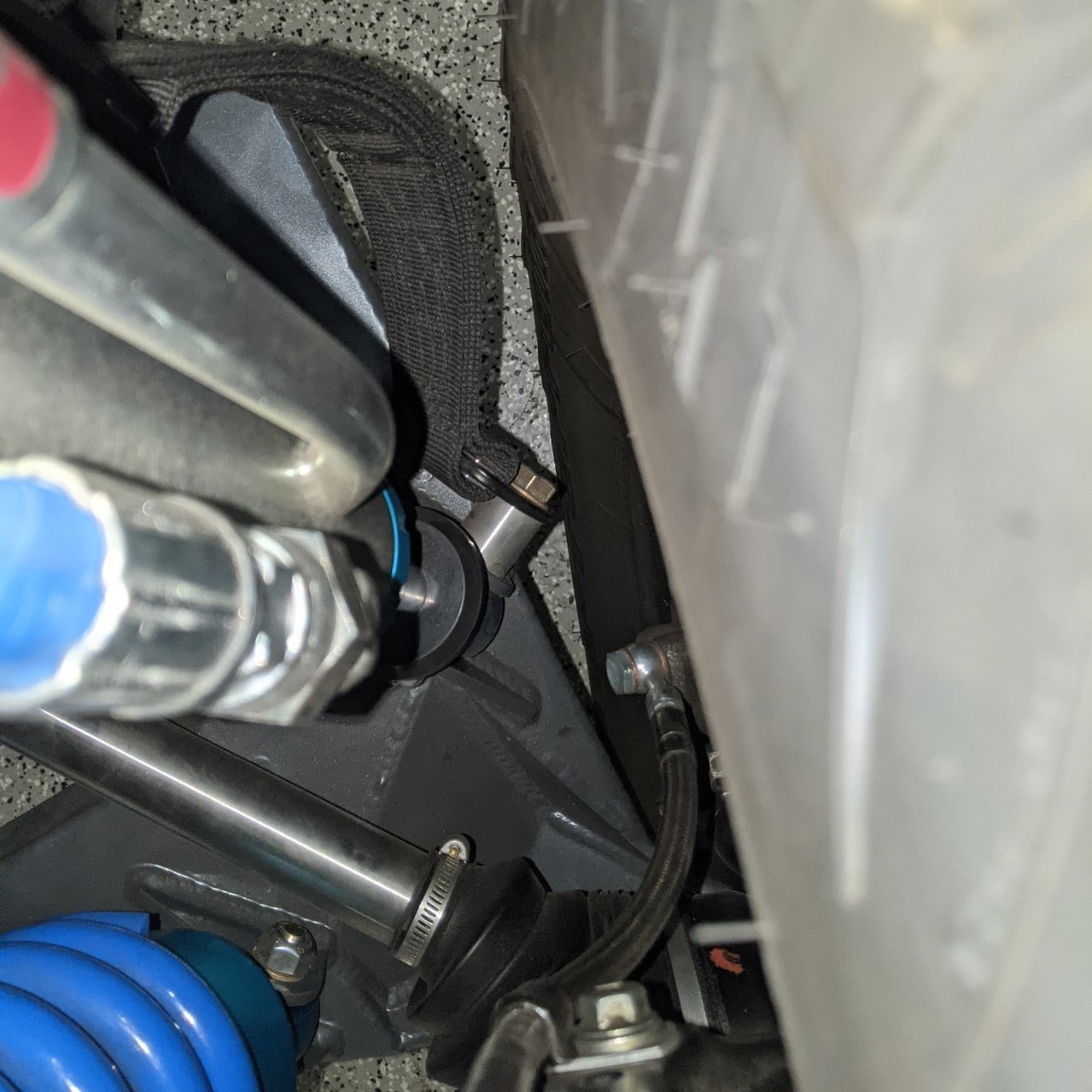

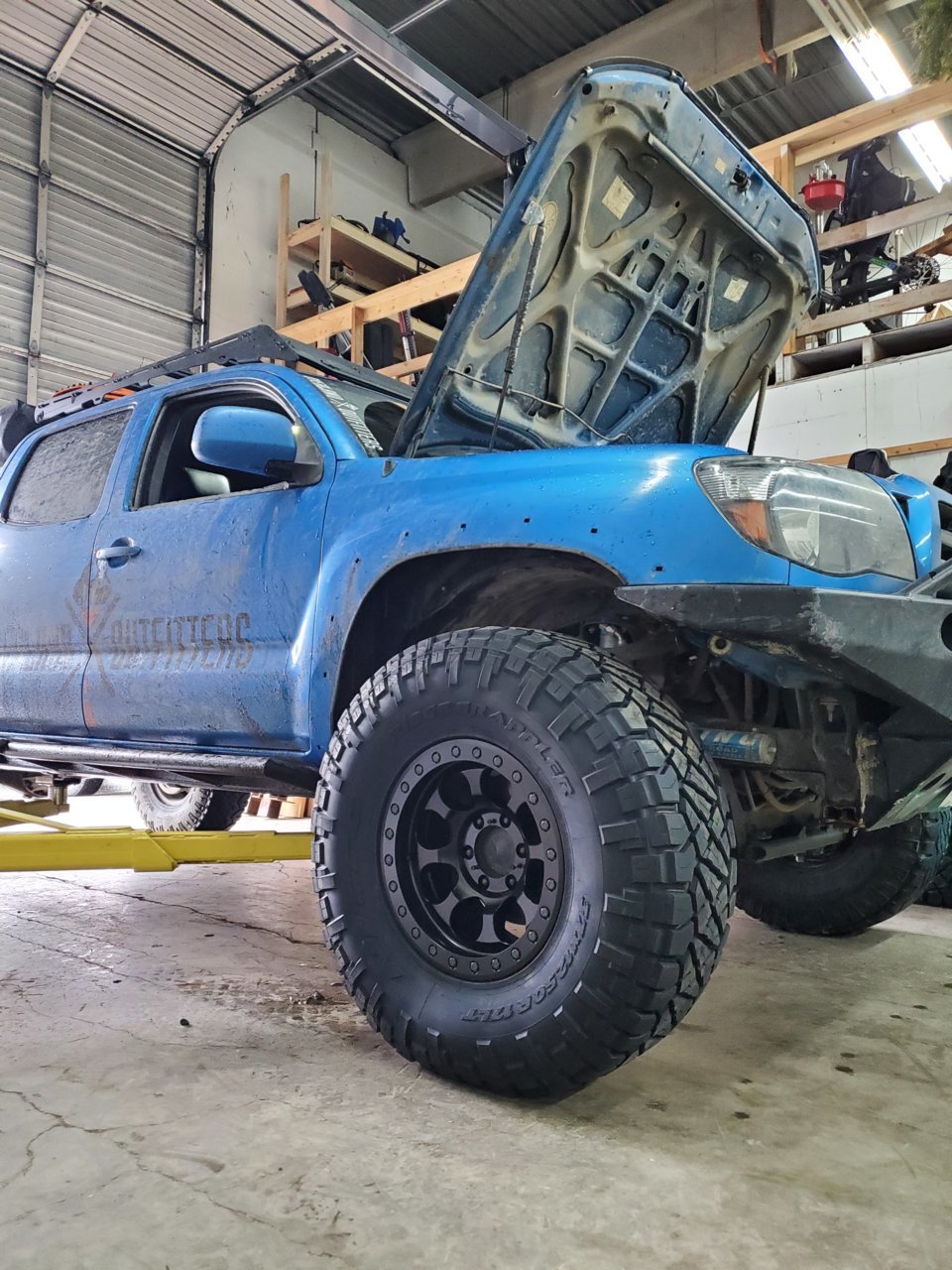

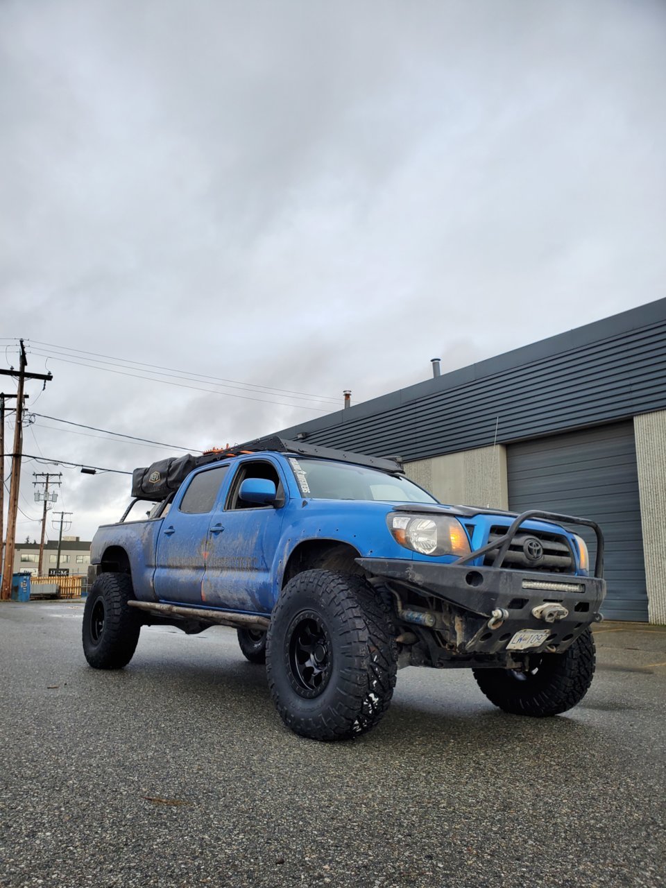

    Fit with no rubbing on street. Don't have time to get into proper clearancing today, but probably next weekend. Tubbing for sure required, but shouldn't be too bad. Clears the spindle with a finger width the whole way, 4.75bs

    long travel hood! it goes waaaay high haha.

    Looks beast!! Awesome! I guess 37s is what you need to make that land yacht of a CCLB look good!

    Looks really good, if you install the slide rack you can push the lowers all the way forward and the 37’s will clear with a CMC

    Yeah that's exactly what it looks like. Obviously still need to tub the top of the wheel well. Cab mount is relocated so no worries there.
    You'll see my Slide rack and rear SUA kit order sometime in the new year!

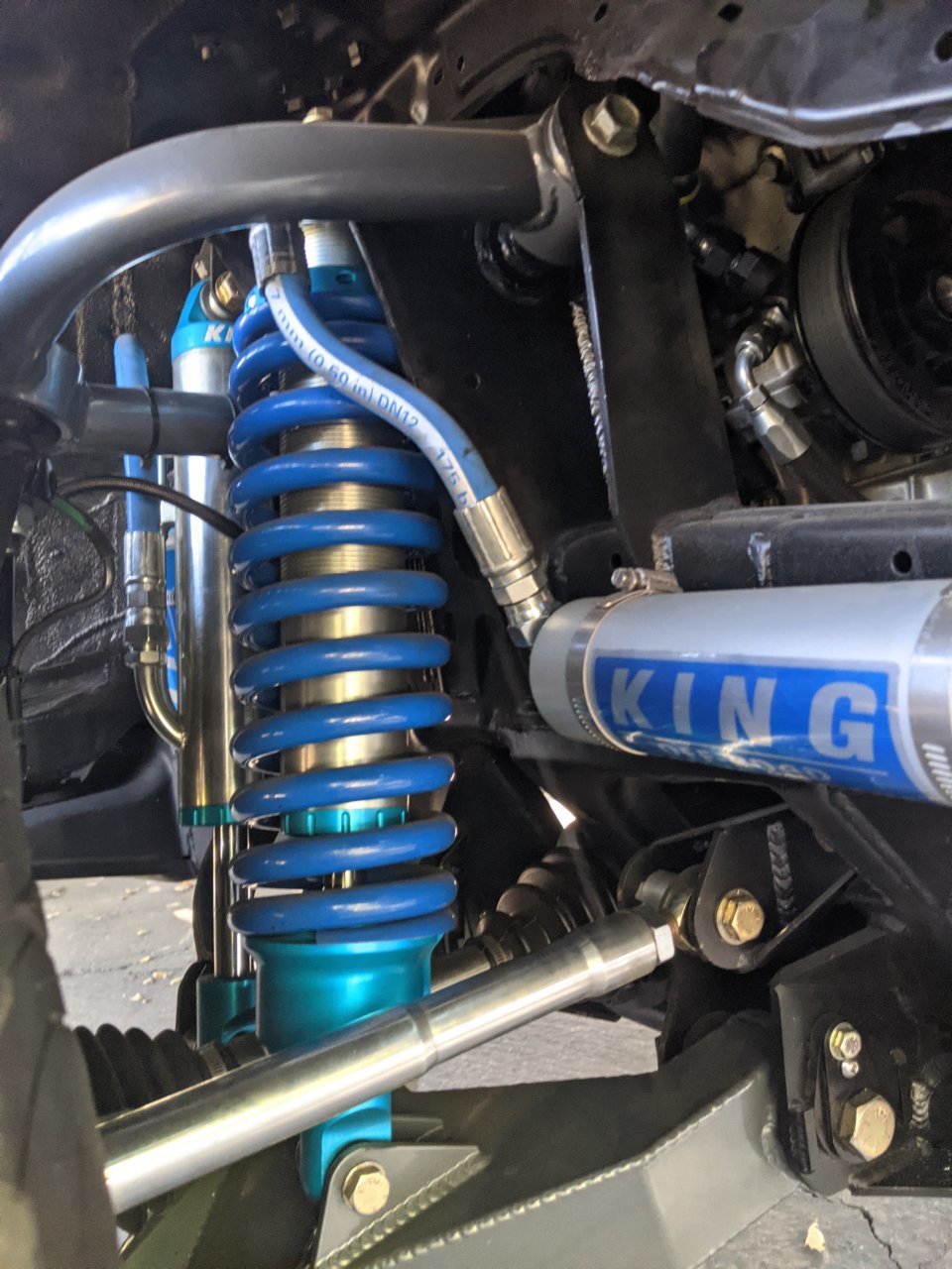

    I drive it as often as possible. Its solid, suspension is way more capable than I expected (already had high hopes), no drama and it's a pleasure to drive. It's like a completely different truck and I am incredibly happy and grateful for JD and their products but more importantly their guidance and how they developed this package.
    LT is not just about wider and more travel. I will argue with anyone I got WAY more than my money's worth. I learned a ton, they are incredibly easy and down to earth to work with and most important, their products and process are top notch.
    Just not enough good things to say about them and how this all turned out. It is not a client/manf relationship, it feels more like gaining an extended family.
    It took longer than expected, I ended up starting off with just wanting the LCA kit and install but reading through this thread, learned that if you are going to do LT, do it right and find the right people who know this process inside and out. Their main business is bespoke luxury prerunners and trophy truck-level builds, and that experience shows up every time I get behind the wheel and hammer the dirt.
    Sorry for the wordy response and gushing on JD to a simple question but honestly, it's not so simple, and it's easy to miss the important fundamentals that made this into an incredibly enjoyable and capable truck
    There's so much awesome sauce going on here. When a picture is truly worth more than a thousand words...
