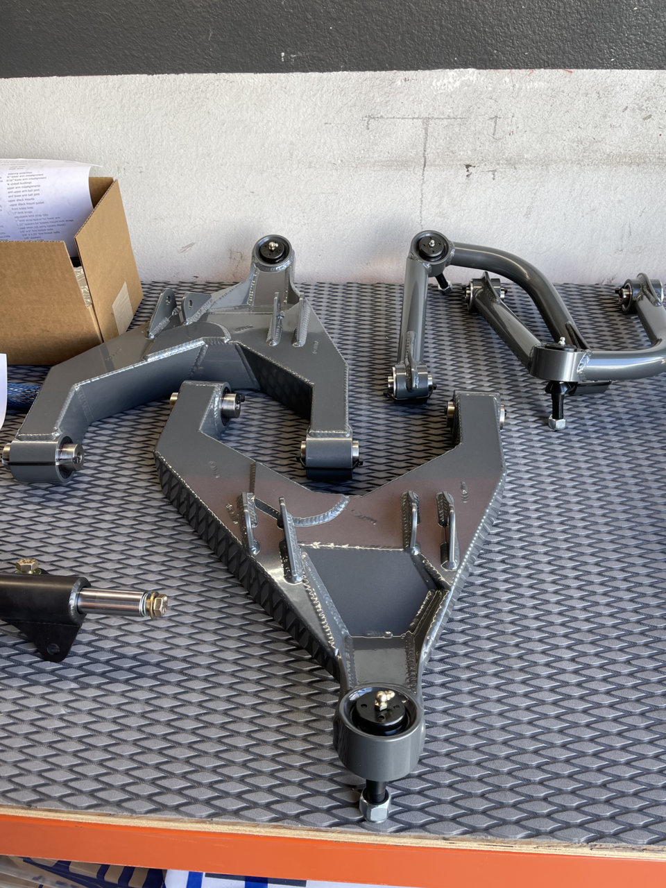

    Pictures don’t do the beef any justice!3F4B1F9F-D3A5-4C2C-9CEA-789C5708C658.jpg

    @81Trekker are the LCA Joints Special ordered EMF parts? I think they are different from UCA ones?

    Yes they are made specifically for the Tacoma lower spindle taper

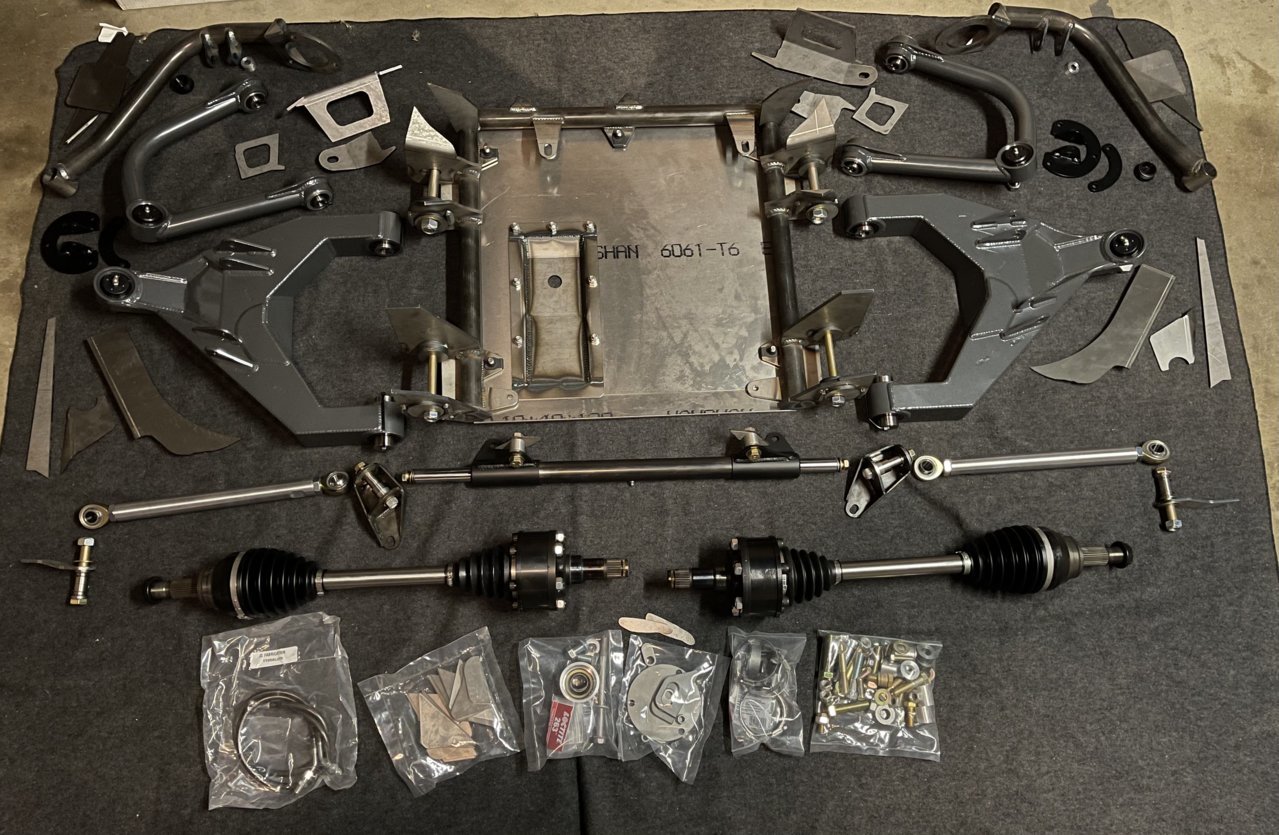

    It’s going to be party time.... eventually sometime this year. Haha
    Can’t say thanks enough to the guys at JD Fab. Harry and Jesse are knocking this Tacoma stuff out of the park.
    I gotta get this front end done so I can start working on redoing the rear.

    Love that pic and excited to see it all on your truck!

    Well when it’s finally rolling I’ll bring it by. I’m sure I’ll be coming by for more parts later this year.
