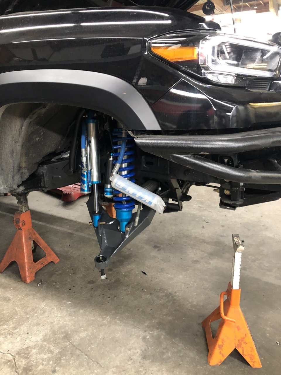

    2020 3rd gen getting some love today

    We went with a 934 inner CV as our LT kit is designed to have more drop out than any stock CV could handle. The 934’s safely do 28 degrees of angle.
