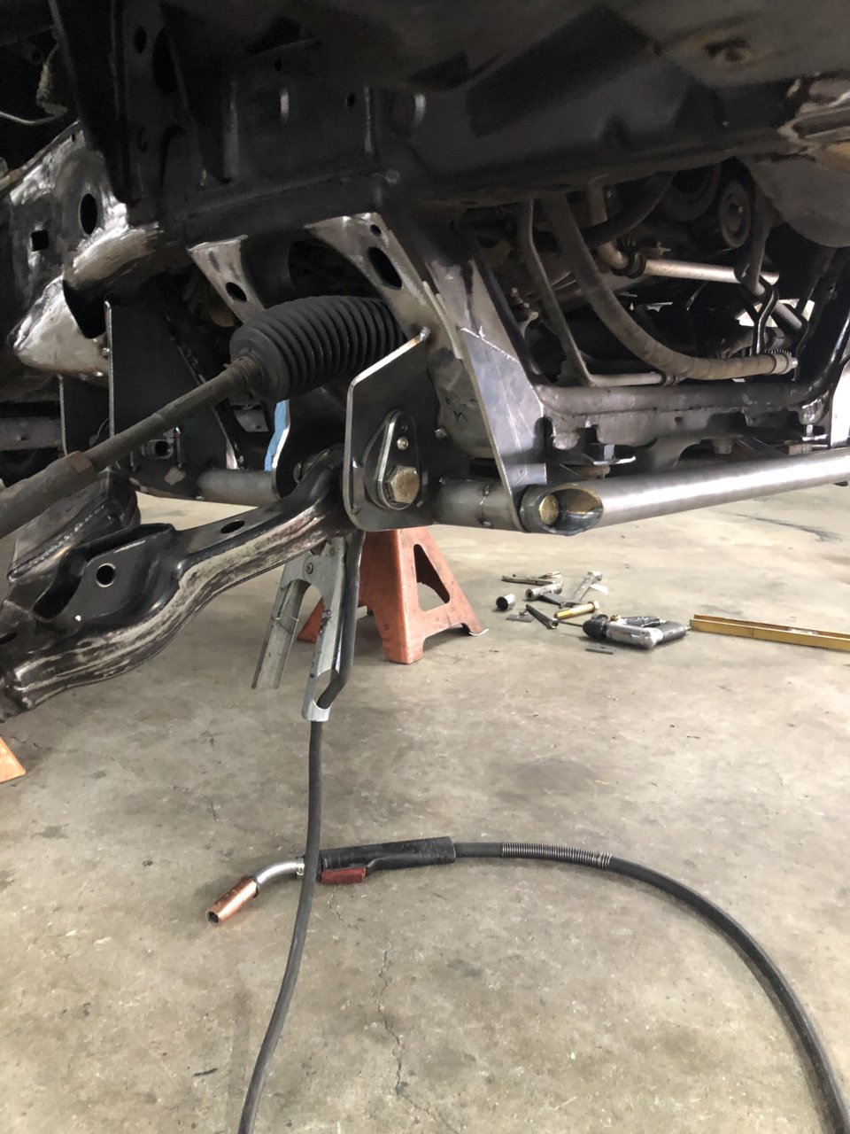

    Getting the front tabs finished and starting with the lower bumper tie in

    Considering changing the lower tubes and the bar that ties the lower arm tabs together to 1 3/4”. What do you guys think? Stick with the 1 1/2” .120 wall or step up to 1 3/4?

    1 1/2” looks to be the right size for that purpose and placement to me. 1 3/4” would be big and bulky imho. Now 1 1/2” 0.25 wall would be a nice way to beef it up if that’s what you were going for.

    There will be a 1/4 aluminum skid plate protecting the lower tubes so I’m not too worried about the wall thickness. And I agree that 1 3/4 is probably too bulky.

    That is some genuine beautiful fab work! *drool*
