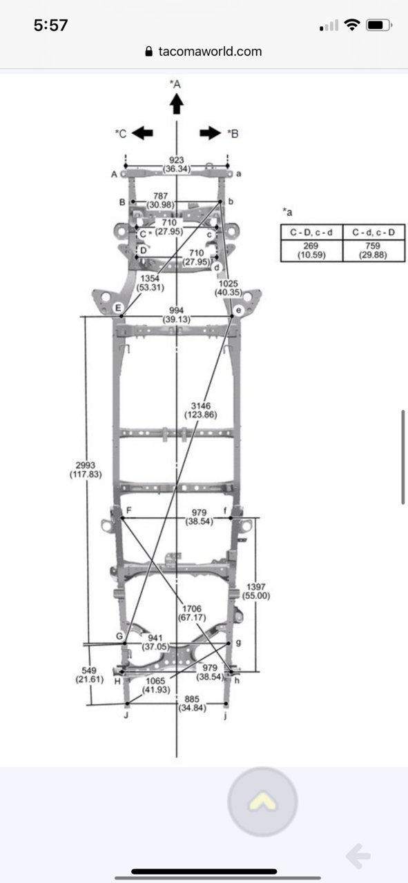

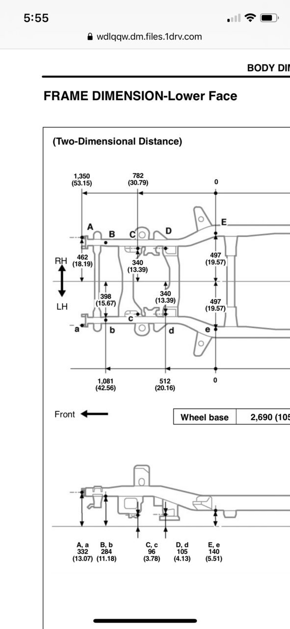

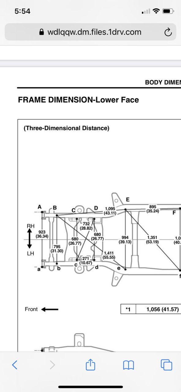

    The FJ and the Tacoma control arm pivots appear to me to be approximately 1" difference. The FJ almost 1" narrower than the Tacoma. However the frames are VERY similar where the lower control arms mount, so the JD Fab LCA kit will readily fit up. There is some, albeit very little overlap of the adjustment cam slots. So if you had your lower cams all the way out after the install, the LCA's would be all the way in. For me, I ended up with about -2 to -3 degrees neg camber, as I did not narrow the LCA subframe. I added hiems to my UCA's and got my camber back.

    If we can confirm the frame is in fact 1” narrower I could easily build a cross bar to accommodate it

    That's interesting that the FJ frame is 1" narrower, since the FJ and Taco use the same front diff and the ADD tube can be swapped for a twin stick conversion on the 4wd.

    I think the difference is in the LCA brackets and not so much the frame. I will say that I had to cut in half the skid mounting ear on the front closest to the diff.

    So where does the difference in width get made up? According to RCV the half shaft is the same, and the spindle assembly is the same. LCA? Or is there just an inch of tolerance in that tulip joint.

    So the FJ and Tacoma axles are not the same. Tacoma has 29 spline outer joints and the FJ has 30 spline outers. As far as length and plunge, that is something I don’t know about yet. Not sure what the other differences are.
    edit: the tulip cups are different too.

    Axle shaft or outer CV? They use the same hub, and RCV lists only one PN for FJ and 2nd/3rd gen taco.
    I'm interested because knowing who can share spare front axles would make our big wheeling trips alot easier.

    So the stub axles (inner and outer) have the same splines, so the front diff and wheel bearings are all interchangeable. When it comes down to the actual axles, the tulip cups, the axles, and the outer joints ARE all different. So that would explain why you can plug and play one front axle for another, but the components of the stock axles are different.
    So if you have an FJ or 4Runner and you want to go with the 934cvs and 300m axles from JD with the 29 spline Tacoma outer, you will absolutely need to use an outer joint from a Tacoma.
