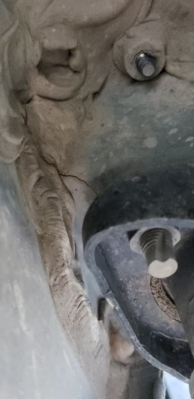

    Your buddy's passenger side is fucked too. Mine and @MonkeyProof 's rear body mounts are failing the same way. Driver side wants to punch through the chassis and the passenger side starts cracking the adjacent sheet metal structure
    I boogered some wire on the driver side cracks and ground them flat, hopefully it'll last a long time before it starts cracking again. Passenger side is a shit show, gonna wait till it gets worse to make a decision on it.
