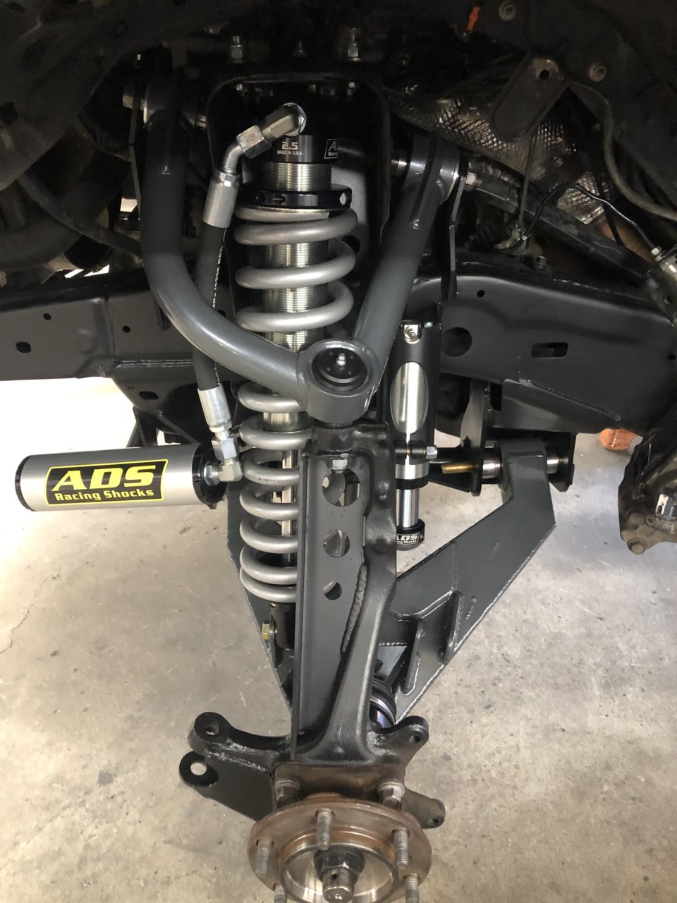

    Question: Has anybody on here actually installed ADS coilovers with the 2.25" kit? Any thoughts on that? Those King wait times are killing me...
  11. Jan 23, 2021 at 2:48 PM
    #3631
    81Trekker
    81Trekker [OP] Well-Known Member
    Aug 25, 2019
    #303299
    3,750
    La Jolla SD
    81 Trekker and 2015 CCSB Tacoma
    Too many to remember
    I have, does that count?
    they work fine you just can’t push the front end further forward than 7/8” because the ADS bottom hats will hit the tie rods. You either have to get custom hats made or run the slide rack and then you will have tons of tie rod clearance

    What are your thoughts about Fox 8”x 2.5” universal coilovers and your LT kit?
  14. Jan 23, 2021 at 4:59 PM
    #3634
    81Trekker
    Aug 25, 2019
    #303299
    3,750
    La Jolla SD
    You will have to modify the hose for sure, as for the rest maybe @desertjunkie760 knows... ?
  15. Jan 23, 2021 at 5:15 PM
    #3635
    TheBlueBeast15
    TheBlueBeast15 Well-Known Member
    Apr 28, 2017
    #217612
    821
    Kevin
    H-Town
    2015 Blue Ribbon Metallic TRD Off Road double cab short bed
    Thank you for your input. What modifications are you taking about? To make the hose shorter/longer or to change the angle of the hose fittings?
  16. Jan 23, 2021 at 5:45 PM
    #3636
    desertjunkie760
    desertjunkie760 @DesertJunkie760 (IG)
    Apr 11, 2016
    #183963
    9,159
    Shane
    2011 MGM DCSB TRD Sport 4x4
    Check My Sig.
    The Fox 2.5x8" C/O does need some changes to fit into the JD kit. These will not fit in the standard configuration.
    -1" shorter eyelet
    -Raised spring retainer
    -90* Fitting out of the shock body
    -Different hose routing. The standard layout uses a -10 hose that is 18" long with what I believe is a 7/8" hose port on the body cap. The fitting is pretty large for the shock to fit into the coil bucket as JD intended. You may have to go down in hose size to a -8 and a body cap with a smaller port to allow the usage of a smaller hose fitting that will clear the bucket and shorten the hose a couple of inches to allow the resi to fit in the appropriate spot.
    This is just off the top of my head so I may have forgotten a thing or two but those are the main changes.
