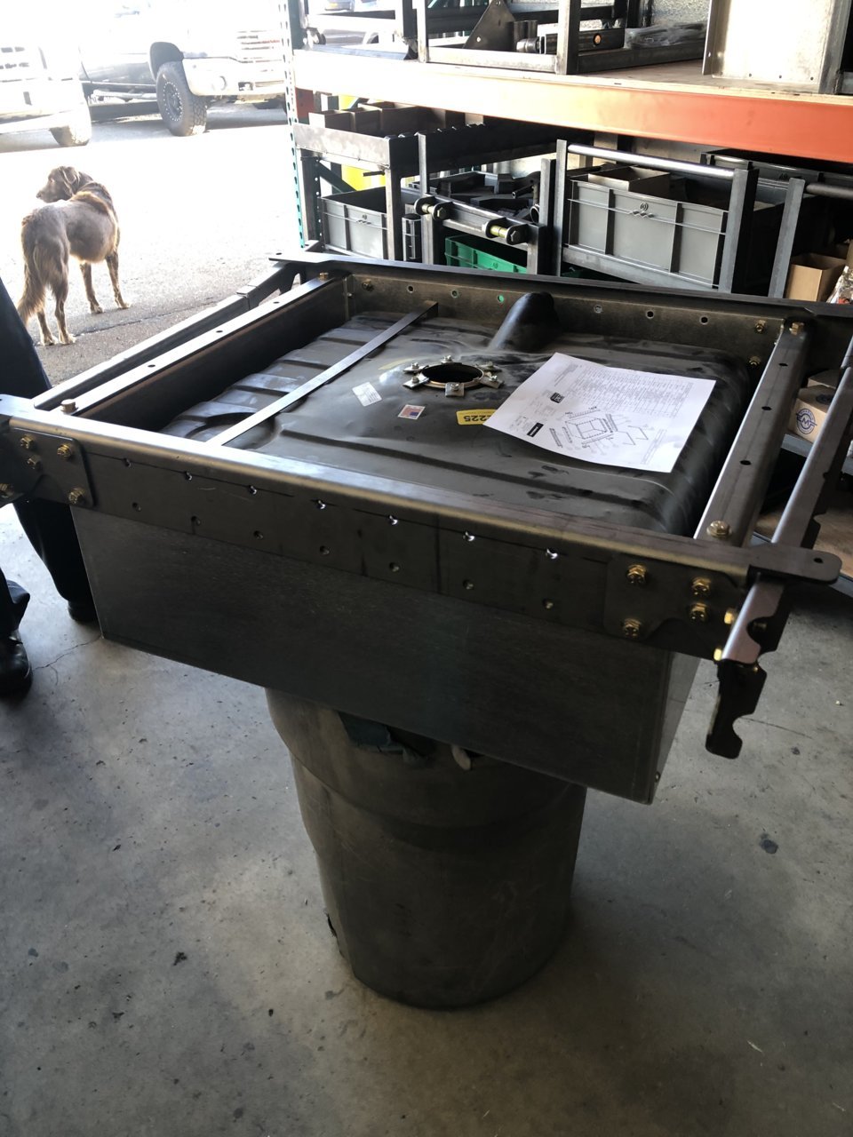

  13. Jan 27, 2021 at 3:34 PM
    #3693
    81Trekker
    81Trekker [OP] Well-Known Member
    Aug 25, 2019
    #303299
    3,750
    La Jolla SD
    81 Trekker and 2015 CCSB Tacoma
    Too many to remember
    The new fuel cell setup is all done, fits a 25g or 31g carb legal factory Chevy blazer tank that can be run as a stand alone setup or and aux tank. It also incorporates side plates to fully box in the frame.
    It could also be installed without the tank and used as under the bed storage
  14. Jan 27, 2021 at 3:37 PM
    #3694
    Slashaar
    Slashaar Trail Limo Supreme & Certified Hole Massager
    Nov 23, 2017
    #236717
    15,537
    Josh
    Kansas City, MO
    2015 Tacoma TRD-Sport DC LB
    Coastal HC Front, 6112s+650lb King Coils, JD 62 Swap + 14" Fox 2.0s
    Sits ~8" below the frame (from my calibrated eyeball is what I can tell)?
    EatSleepTacos and Sociopenguin like this.
  15. Jan 27, 2021 at 3:38 PM
    #3695
    81Trekker
    Aug 25, 2019
    #303299
    3,750
    La Jolla SD
    The 31gal sits 8” below the frame and the 25gal sits 6” below
