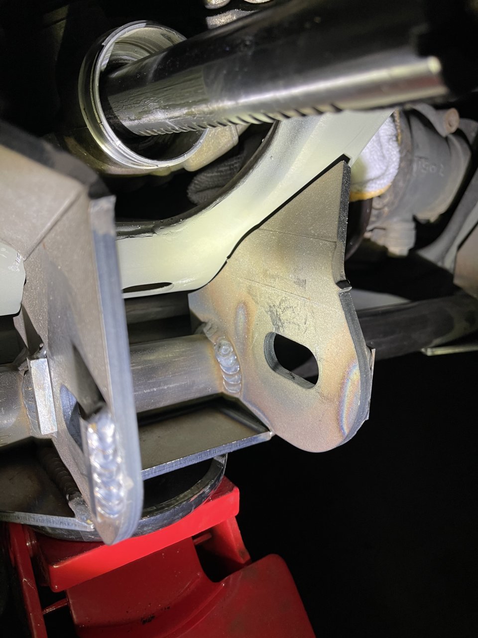

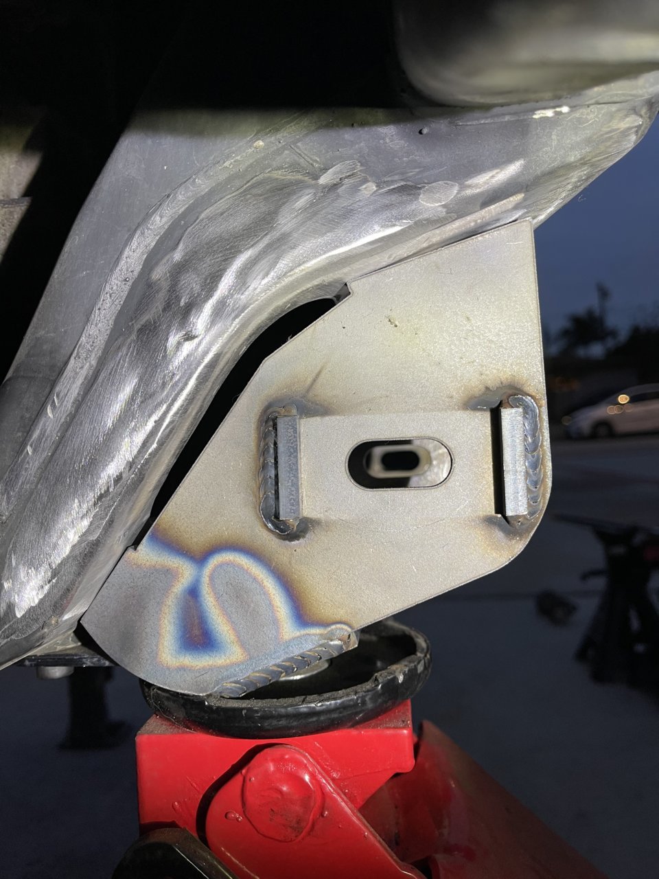

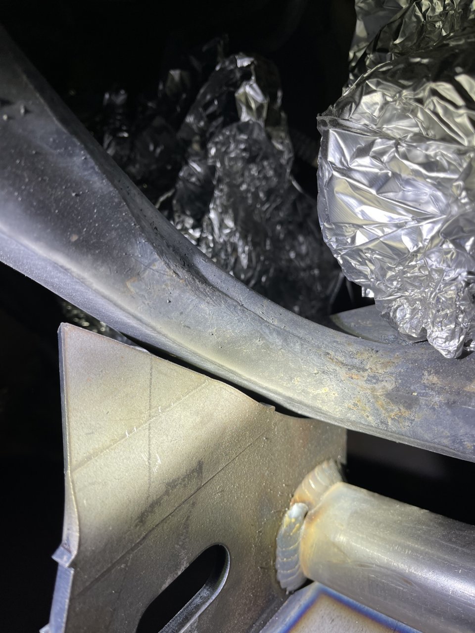

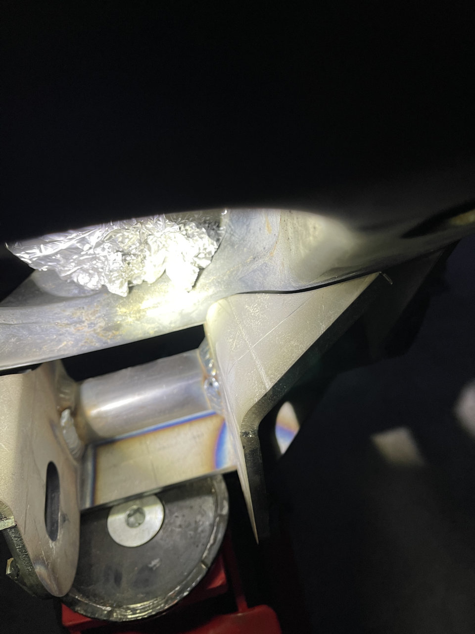

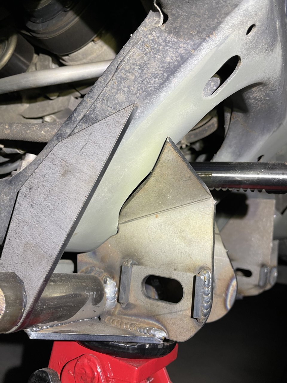

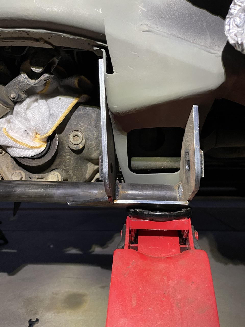

    Buena Park
    2013 MGM DCLB 4x4
    Front suspension: Work in progress JD Fab +4 LT, LCA pivot kit, steering slide rack, 934CVs Rear suspension: Archive Garage shock relocation and SUA Conversion,King 14x2.5 shocks, King 2x2 hydro bumps, FN wheels 5 stars, sliders

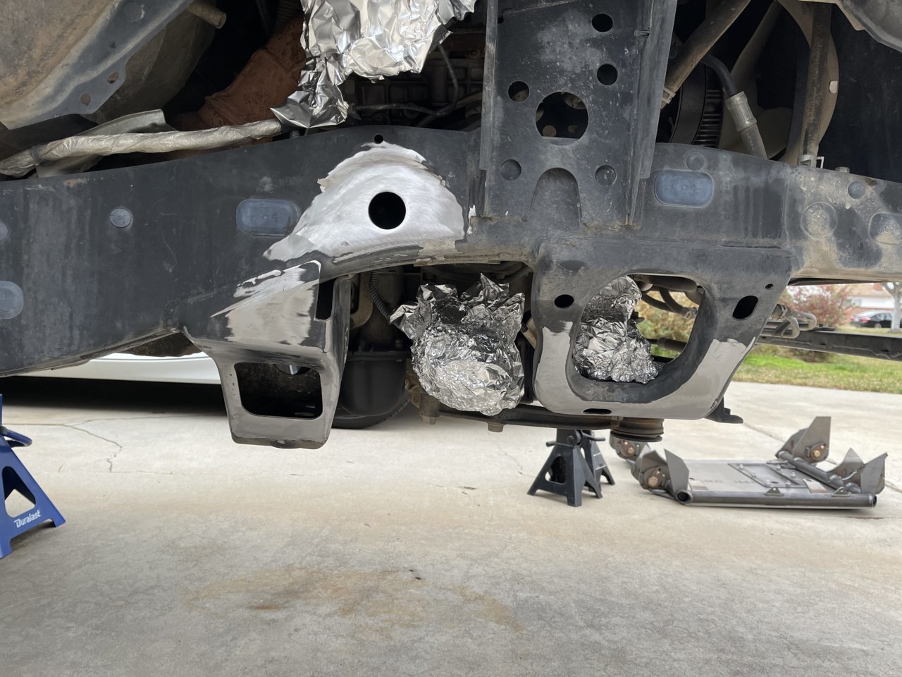

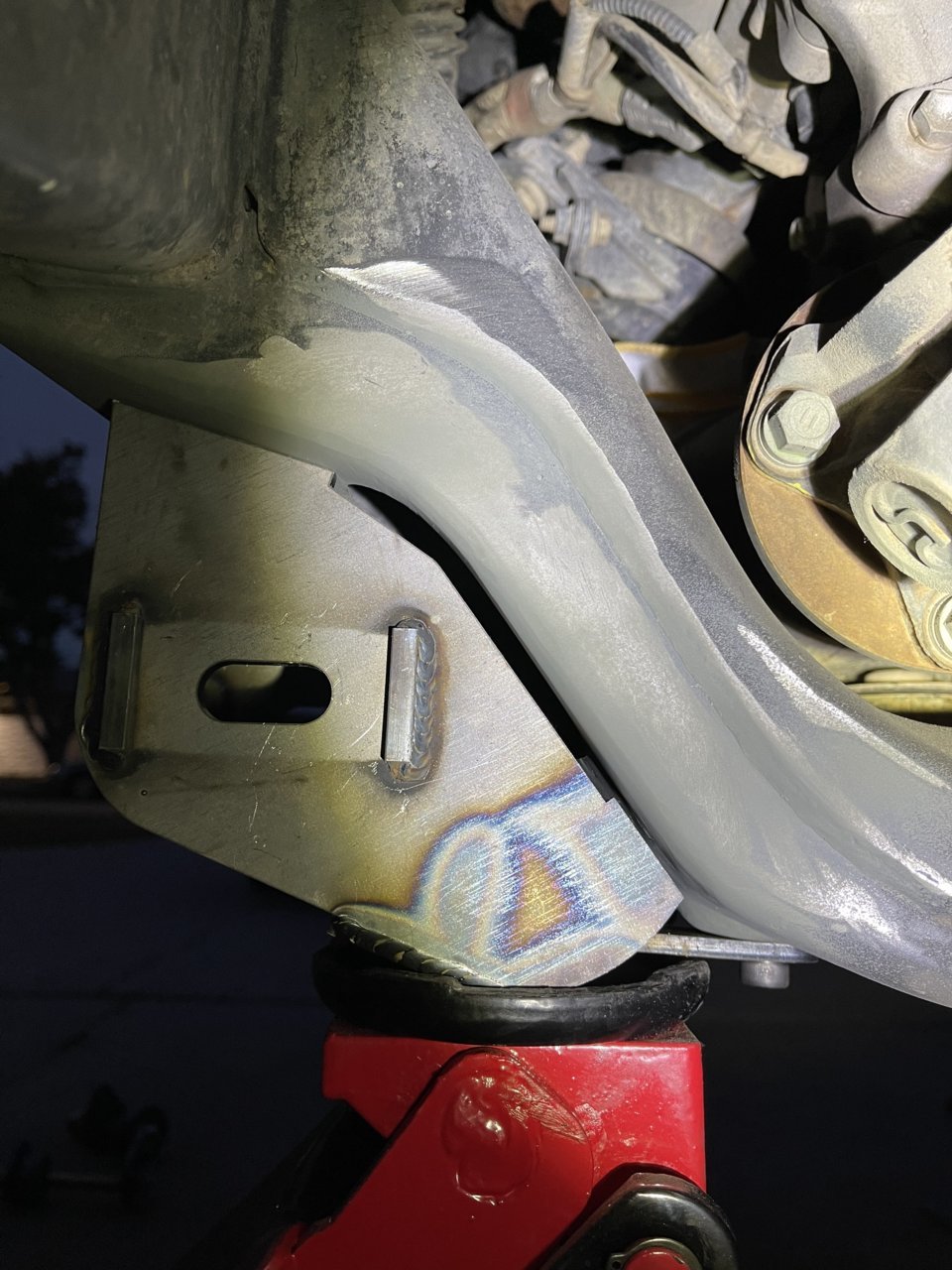

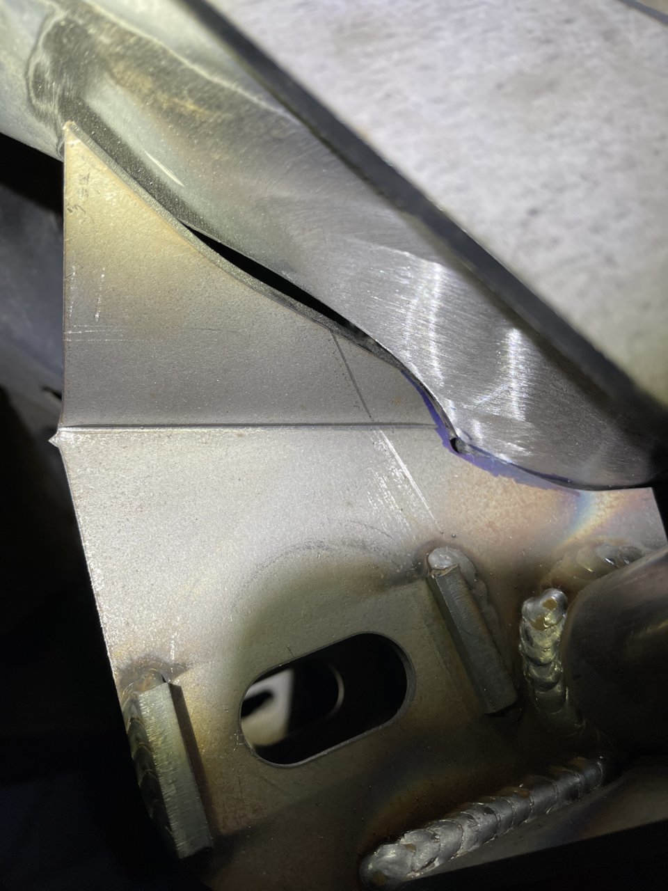

    I was able to cut everything off the passenger side today with another few hours. I bolted up the lca tab kit to “locate” the frame. There’s a few areas I want to work at to see if I can get it to fit closer.
    these pictures are with a jack under the specific spot with some pressure. I still had the weight of the truck on jack stands. Though using a jack to push the lca frame to the truck frame helped a ton.
    Yossarian, Jazz1one, Slashaar and 6 others like this.
  13. Jan 31, 2021 at 6:08 PM
    #3733
    RonRon23
    RonRon23 Well-Known Member
    Aug 25, 2013
    #111135
    1,301
    Ronnie
    Buena Park
    2013 MGM DCLB 4x4
    My next step is to better fit this lca kit, prep the cuts and fill plates for the slide rack heim brackets, clearance and fill plates for the 934s, fit the bypass mounts and lastly the upper arm double sheer gussets prior to welding.
    Arcticelf likes this.

    DocME
    DocME Well-Known Member
    Aug 24, 2018
    #263956
    1,583
    California
    '07 FJ Cruiser
    TRD S/C, UCON, 61# inj, 2.5 pulley, 7th inj, Roostfactor Y Pipe, URD exhaust, WAT Nomad Valve body, Dana 60, DK LT, JD FAB LCA mounts, custom roof rack...and way too many others.
    Those notches on the rear are for those formed plates to be welded over the open pocket. Don’t know if you tried that yet?
  15. Jan 31, 2021 at 6:42 PM
    #3735
    RonRon23
    Aug 25, 2013
    #111135
    1,301
    Ronnie
    Buena Park
    2013 MGM DCLB 4x4
    Yes. I’m aware of it. They still slid in place, I didn’t have enough hands to hold everything for a picture.
