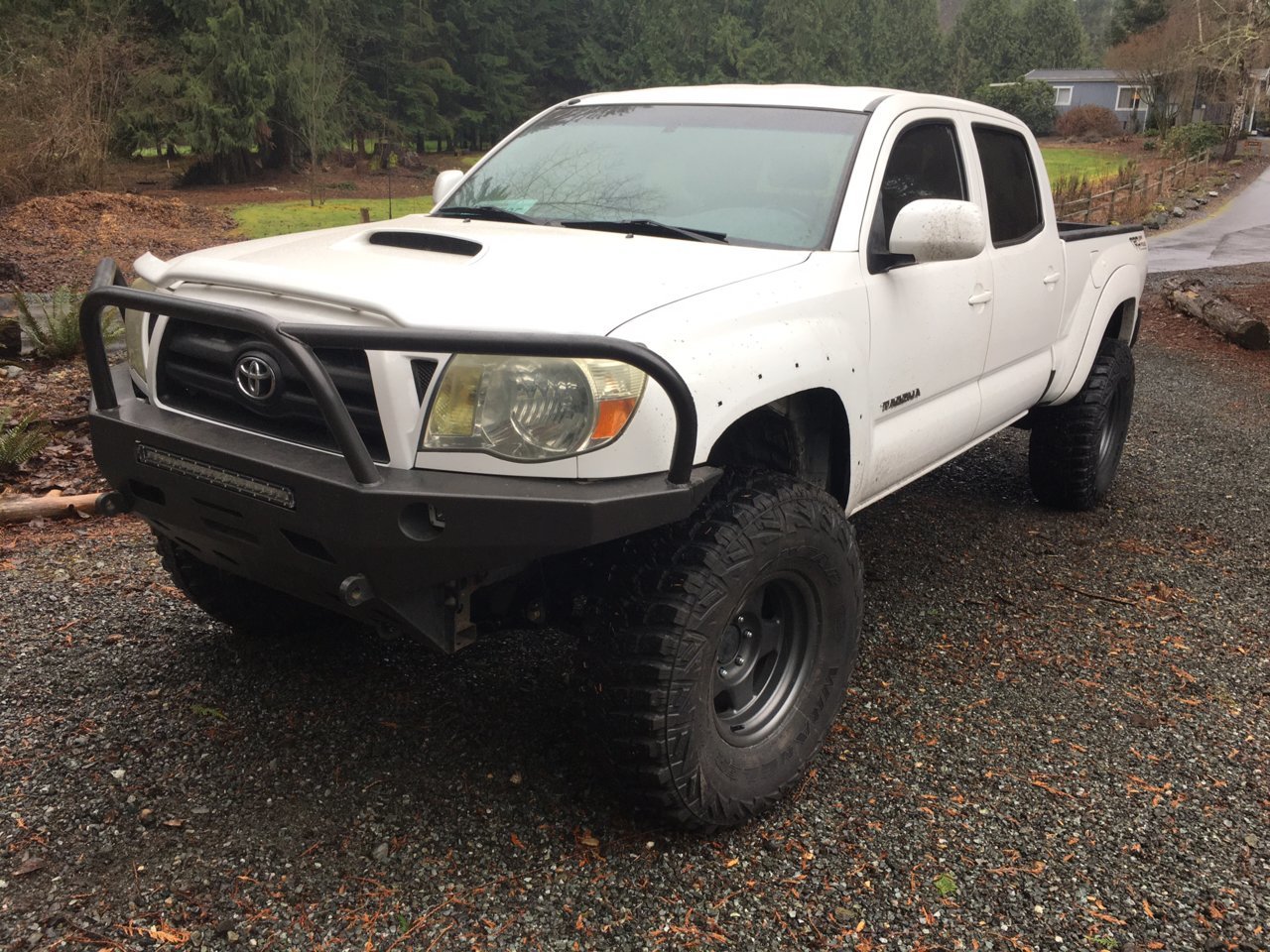

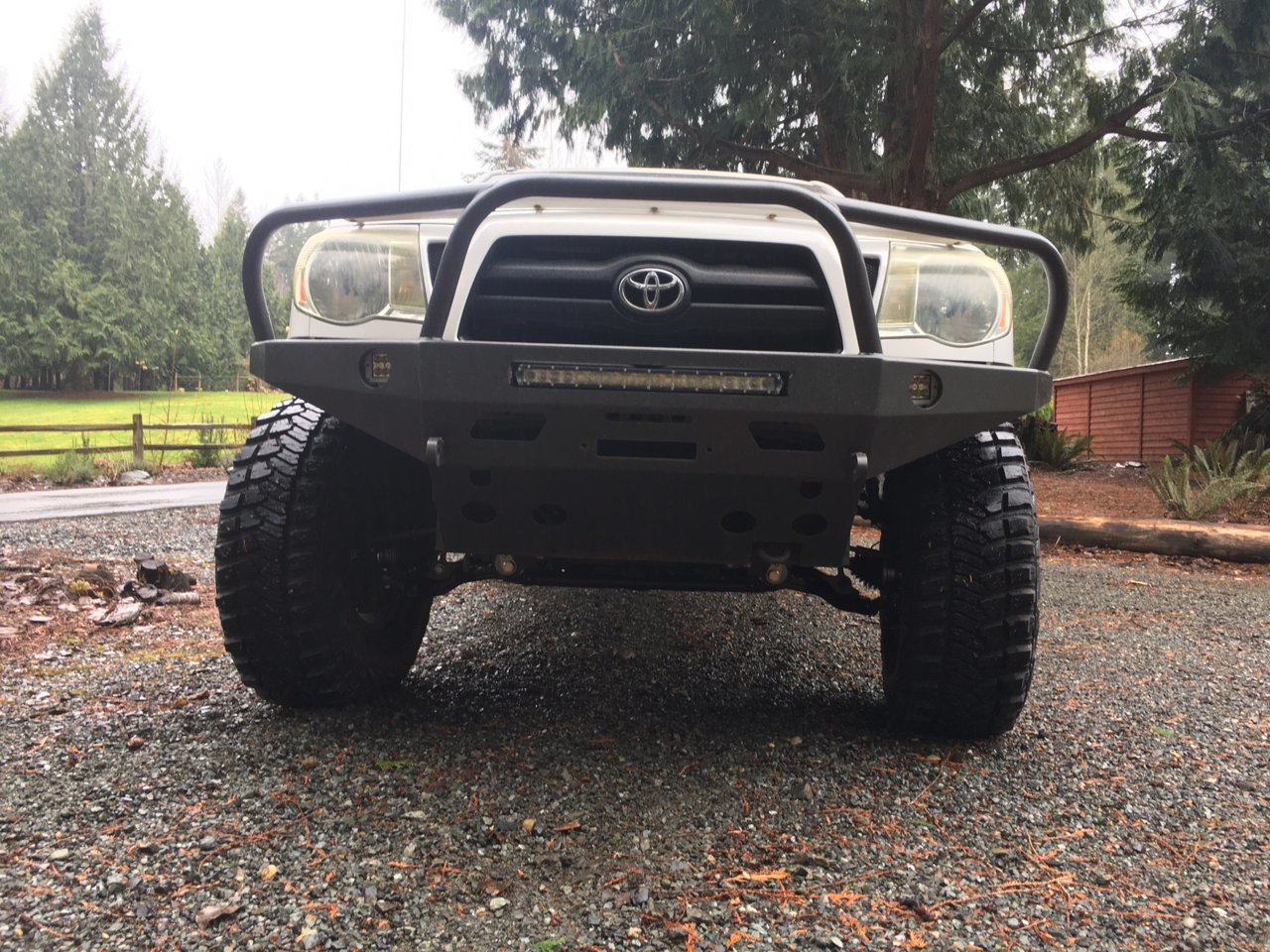

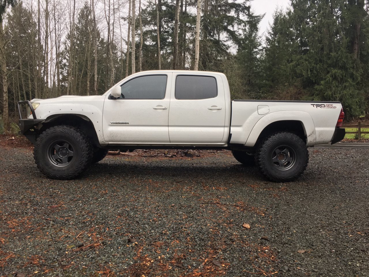

    Just got my pivot kit finished up, aligned, and back on the road. 35" kevlars with OEM LCAs spaced all the way forward. Full bump, lock to lock, plenty of clearance to the firewall and barely touches the upper fender well. Drives great. Thanks again to JD and Harry for an awesome solution and great customer service. 37's are next.

    With the stock lower arms what shocks are you running?

    I’ve done them with 5100’s, 6100’s, kings, fox’s and even OE shocks... they all work

    5100's. I have pics, but haven't re-figured out how to post forum pics since the pirate days. Is there an easy way on this site?

    Just click the upload file button when you craft a message, don't forget to check the box that makes the image full sized instead of thumbnail sized.

    What front bumper?

    Have you bumped it and see if it clears? It looks like it’s going to be hard into the inner fender at full bump just behind the headlight.

    Yep, clears at full bump/lock except top of tire barely contacts the fender well. I’m sure once this gets wheeled it’ll get into a bit more. It’s a bit deceiving in the pic as the tire is slightly turned.
