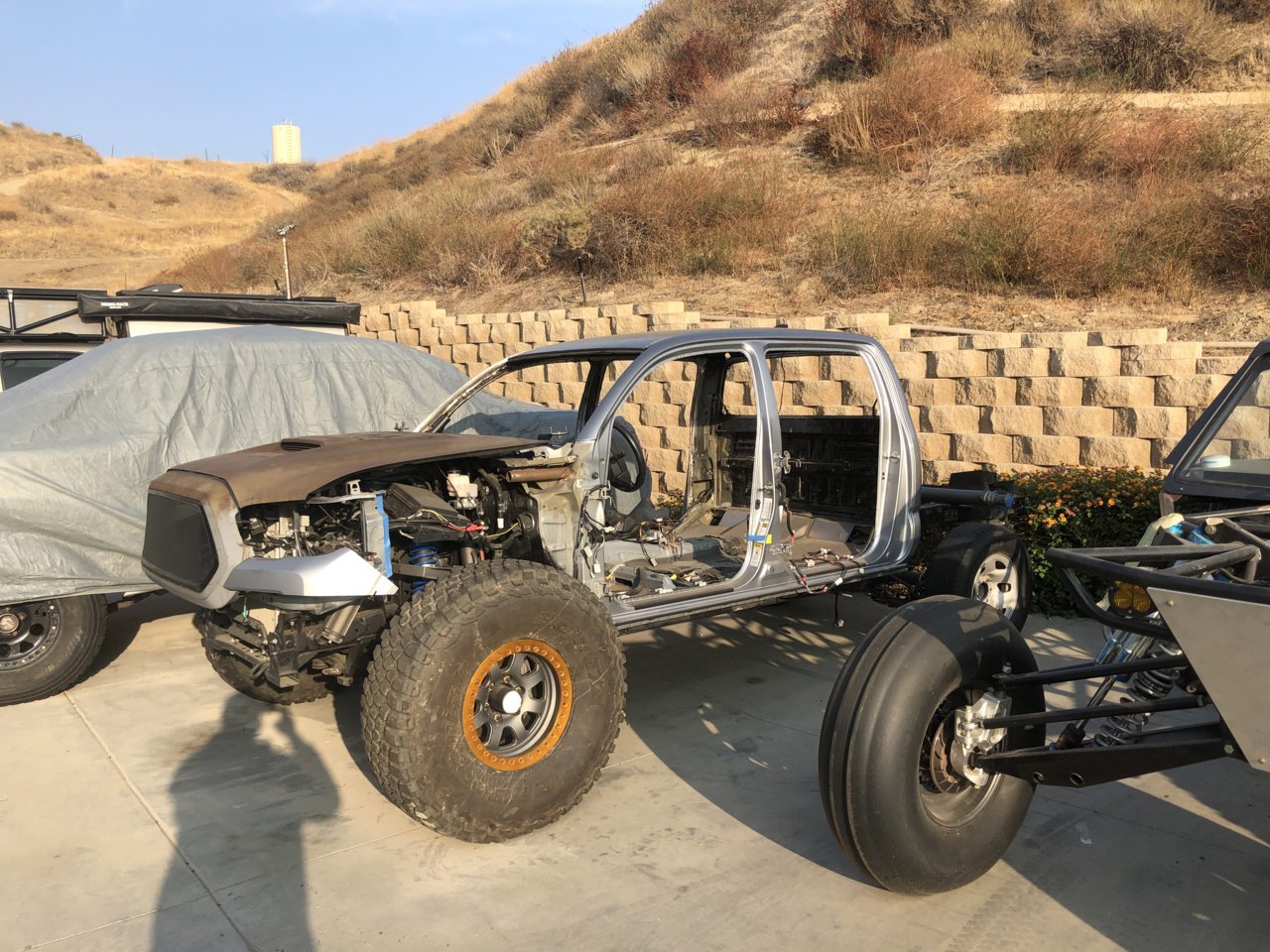

    By chance was this picture taking at Even Weller's Shop?

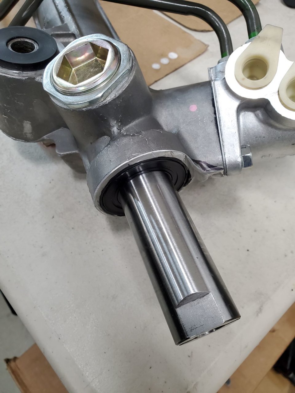

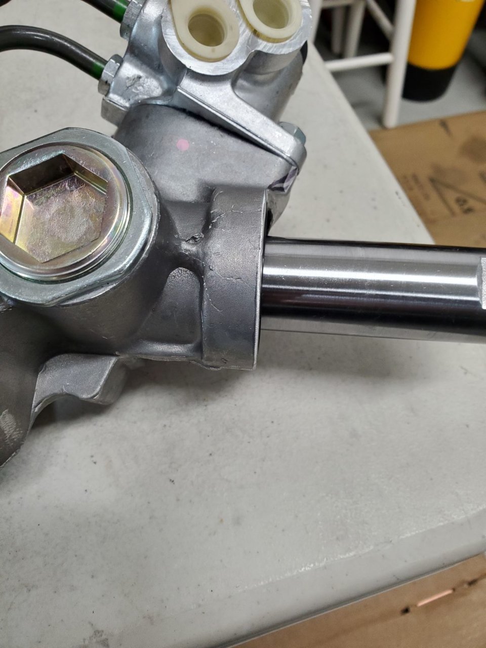

    Anyone that did the slide rack install have a pic of the cut they made on the racks drivers side?

    Here you go Airdog
    Bolt the clevis on and cycle it to the stop....you'll see you don't need to take much material off the input housing

    1.25” needs to be cut off the end of the rack
    *also it depends if it’s a true OE rack, aftermarket racks can vary.

    Do both ends get modified?
    What are you using to make the cut?
