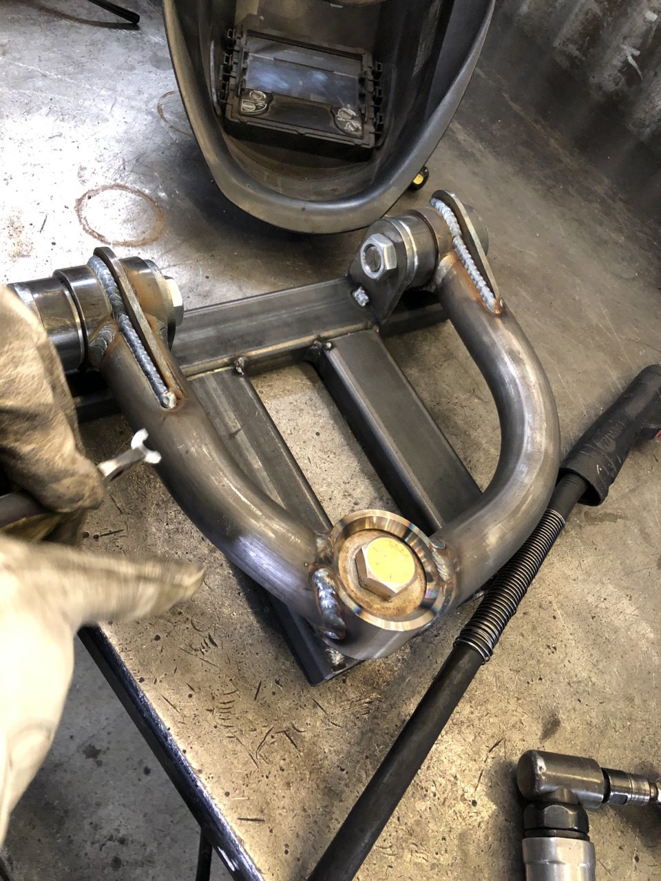

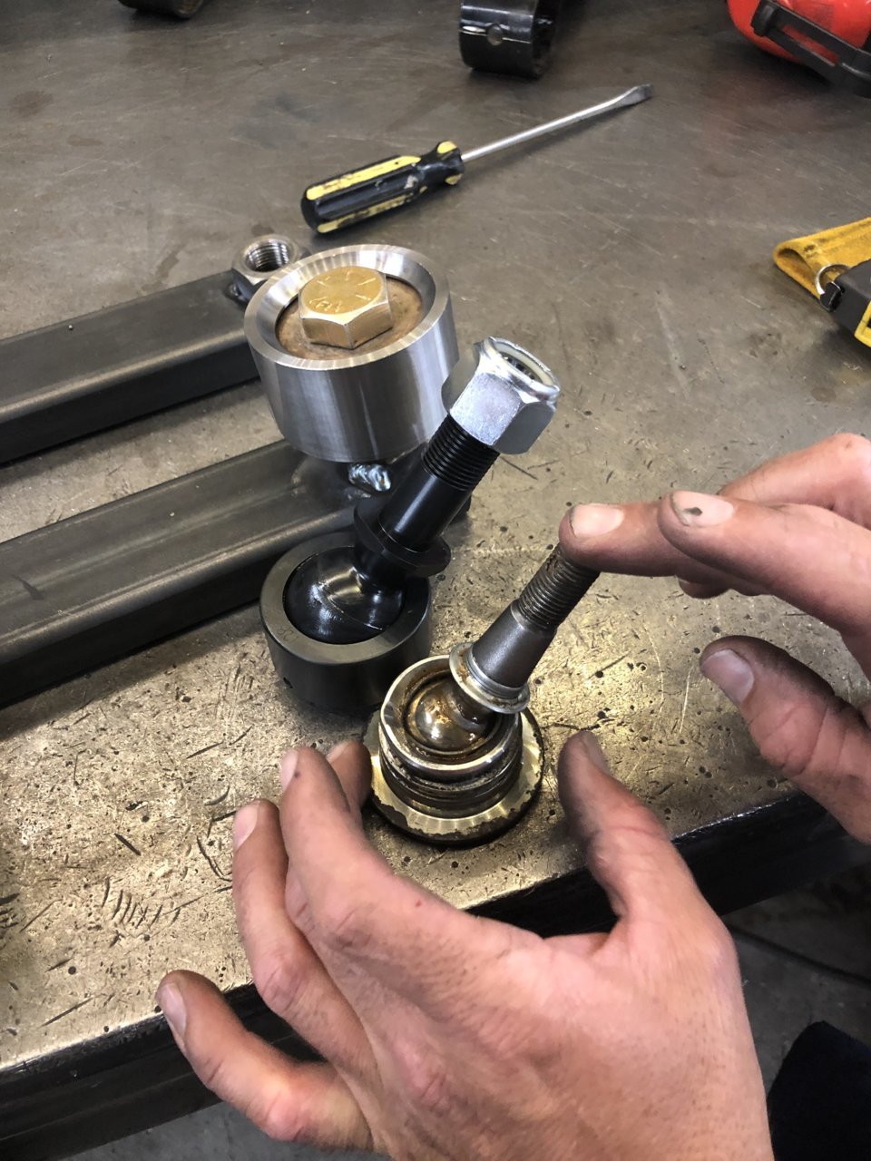

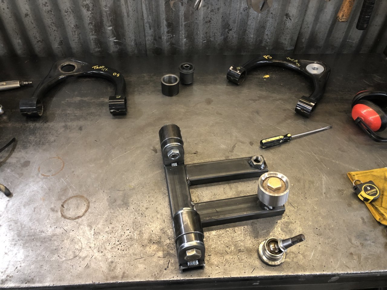

    A little progress on the upper arm today... the inner pivots have a bunch of adjustability so the proper caster can be selected after the lower arm is pushed forward. I’m also using the larger tundra OEM bushings because I hate how loud urethane bushings get and heims are the same. Please keep in mind this is not my main trail rig and I’m trying to keep it low maintenance/quote on the street

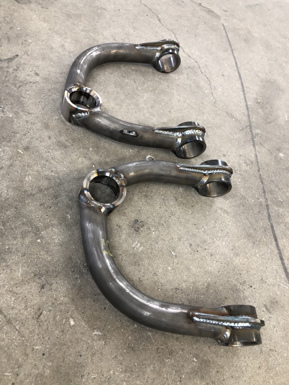

    upper Arms are just about finished...

    Off to powder coat...

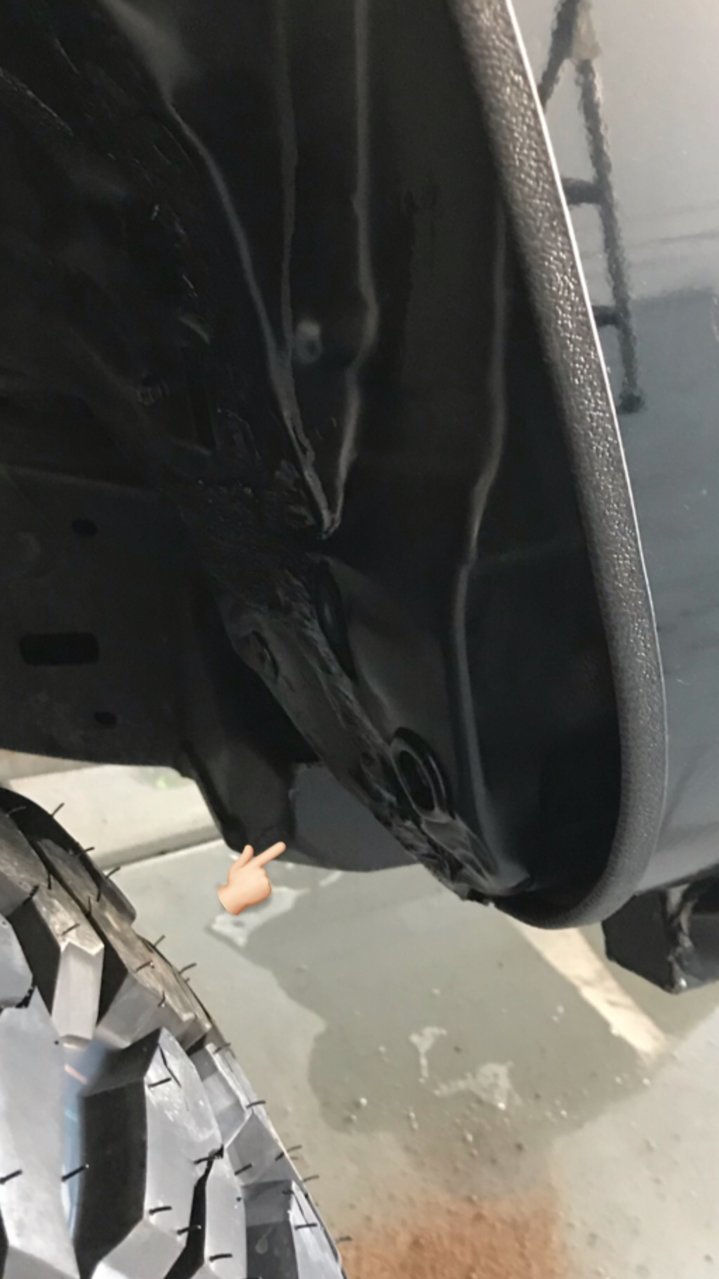

    Interested in seeing where this goes. Props for giving it a go. One thing you also may want to keep in mind is as the wheels move forward the first point of contact becomes the front of the inner wheel well.
