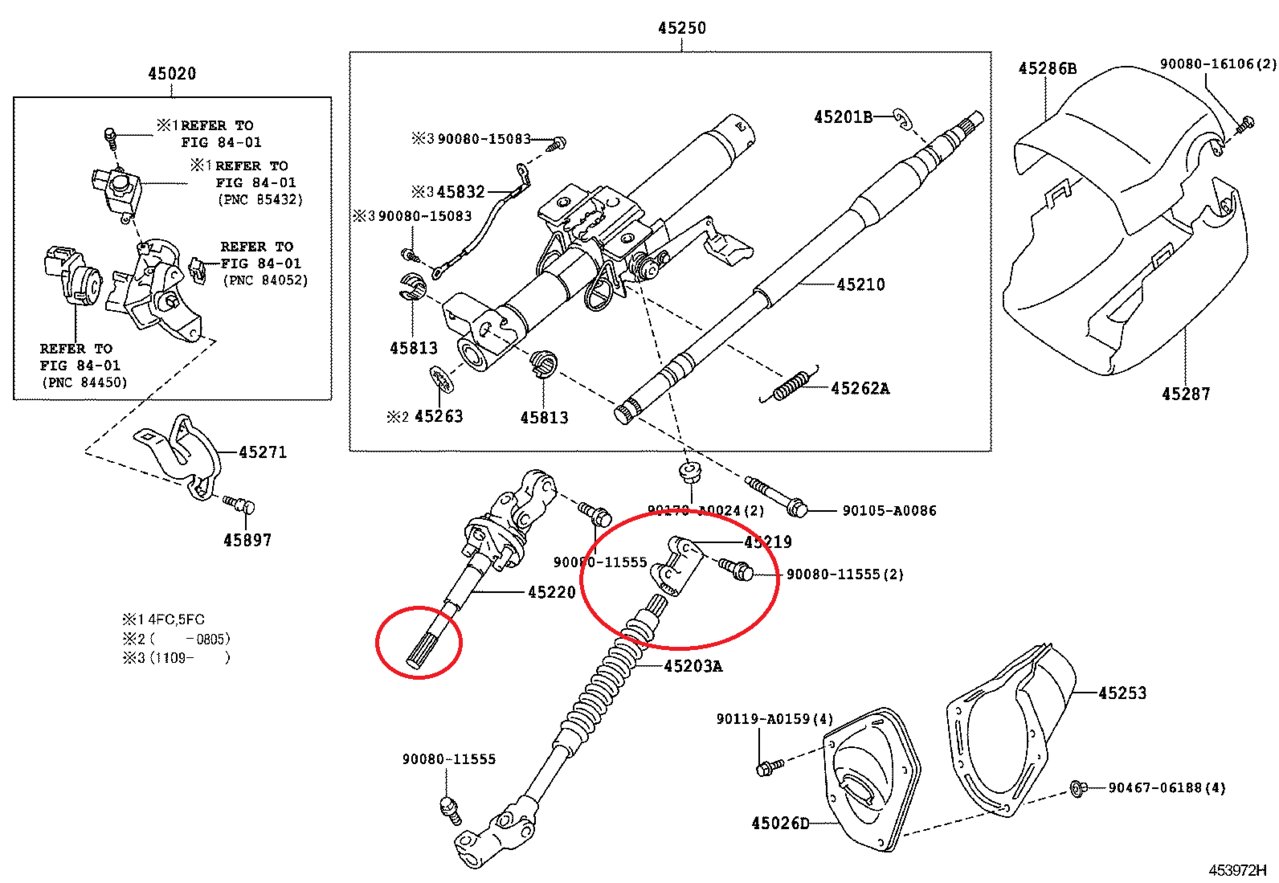

    Out of curiosity, I did a little research on steering quickeners and how they work. They're surprisingly inexpensive (~$100).
    I'm curious where it gets installed on the Tacoma. I was guessing here, in place of the yoke. Just shorten the intermediate shaft to the appropriate length. Not sure where the quickener would mount though.

    It completely replaces 45302a. We had u joints made that take it from Toyota spline to quick steer and then back to the Toyota rack. The quick steer has a weld on bracket that welds to the crossmember right below the motor mount
