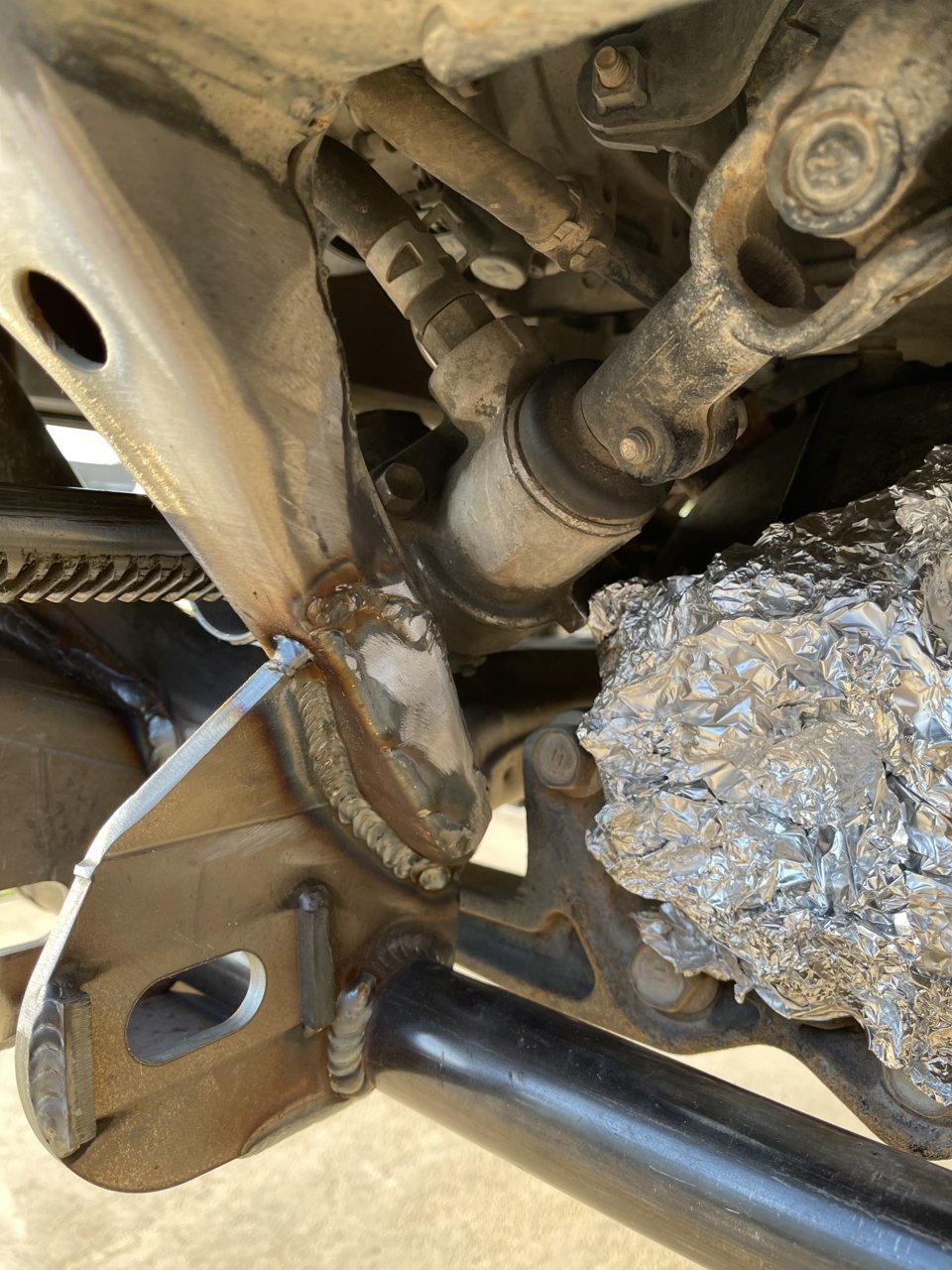

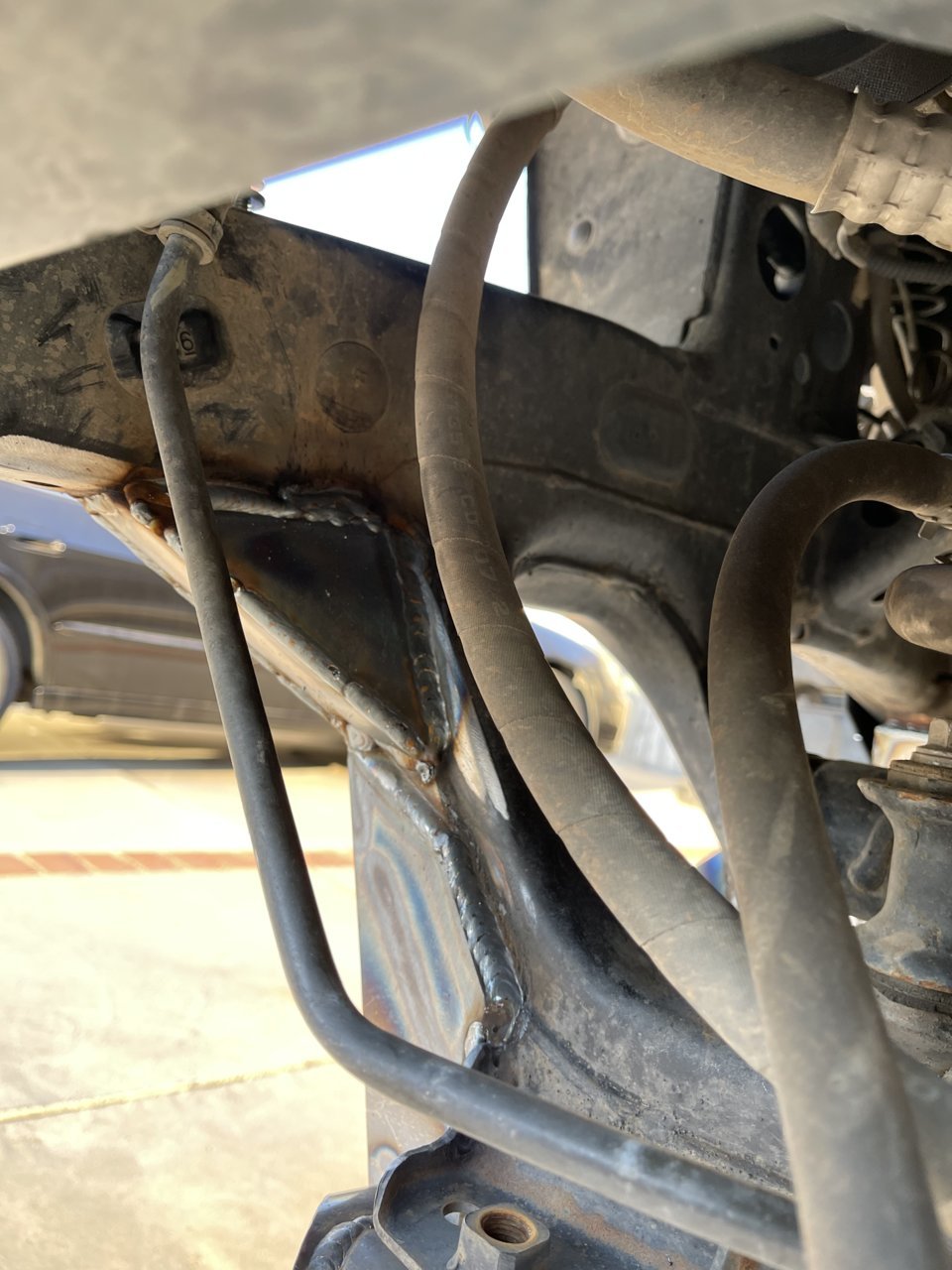

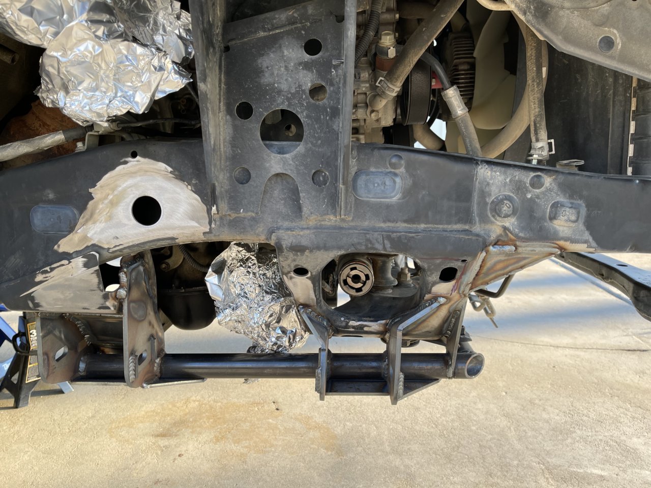

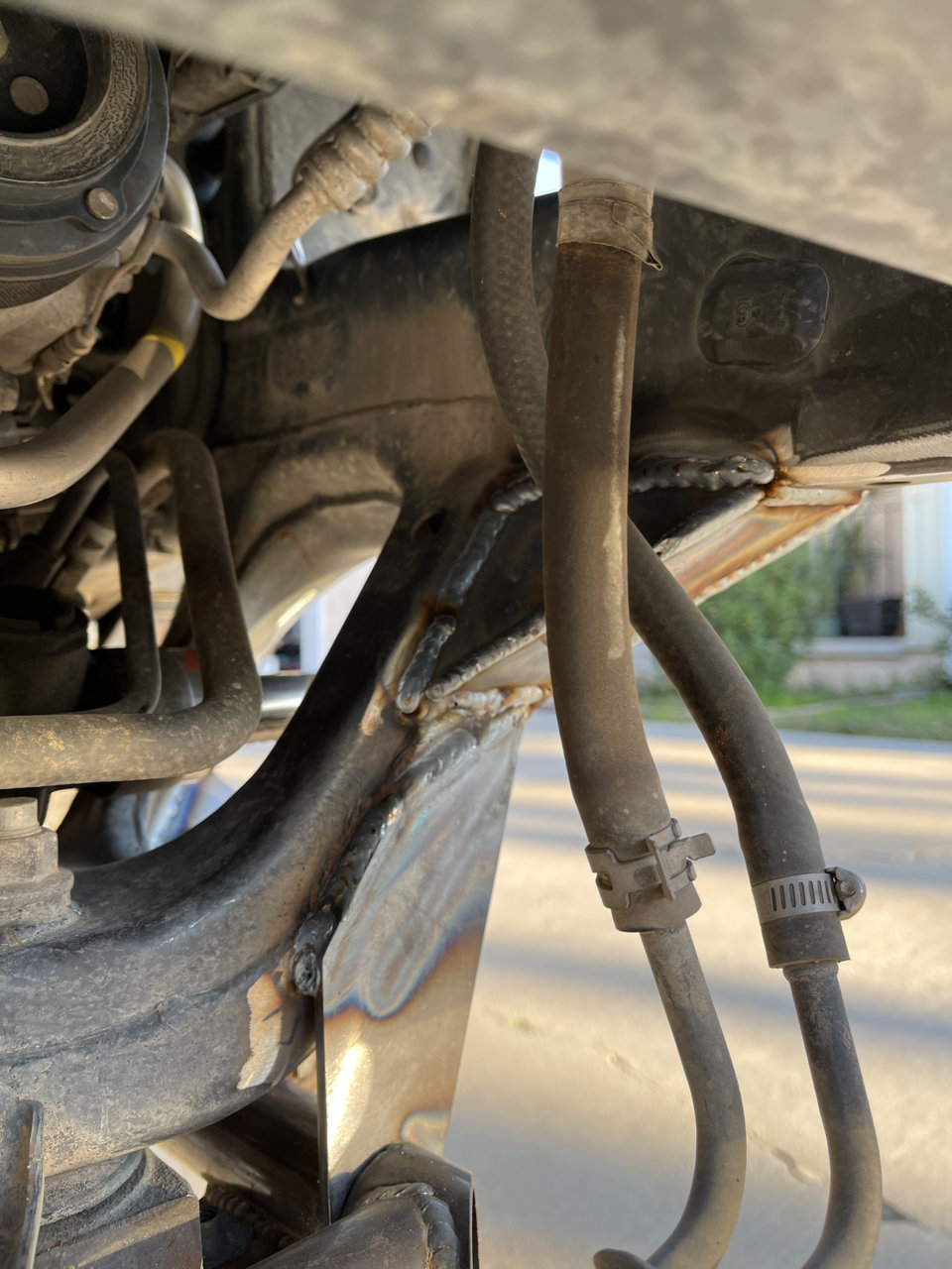

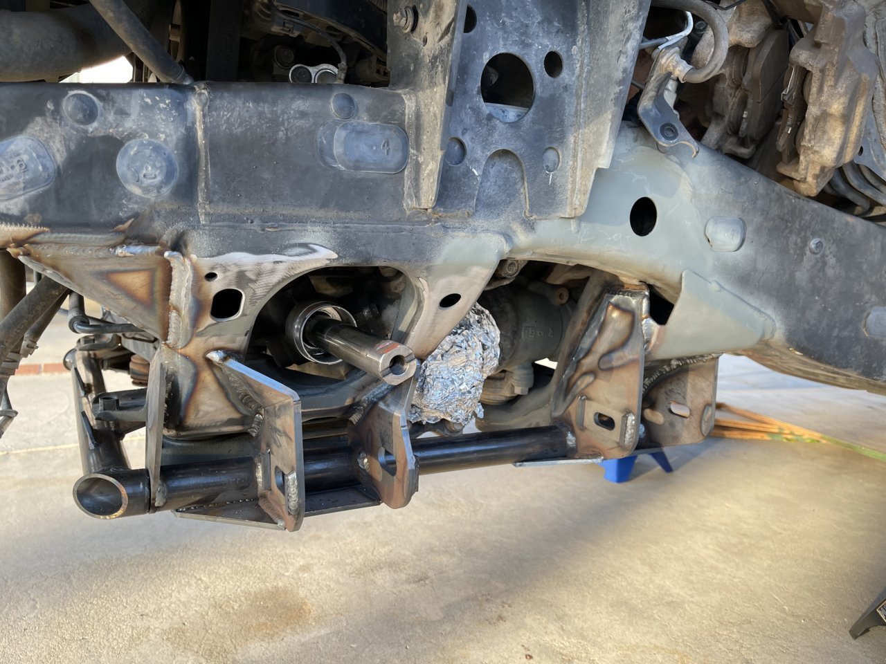

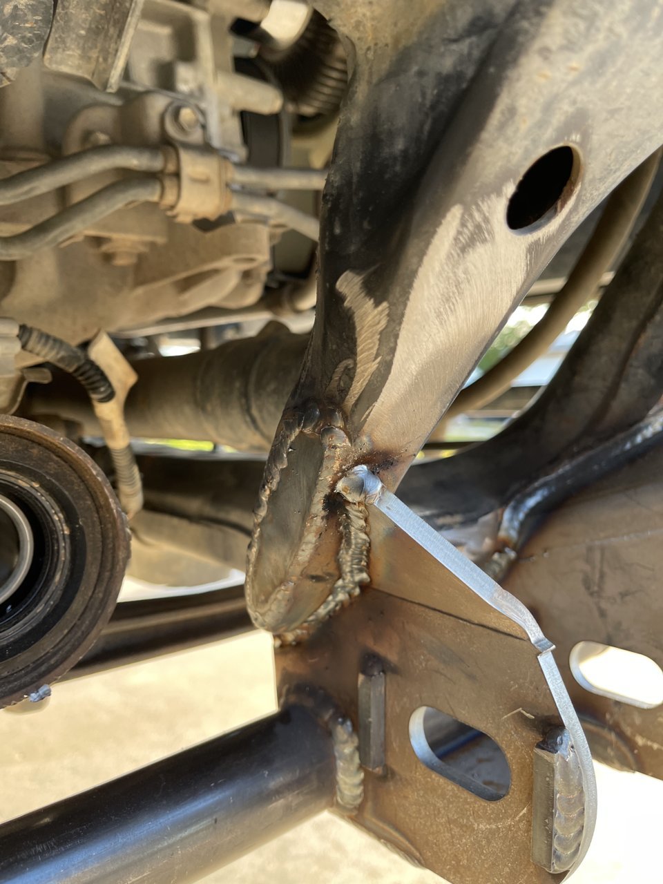

    Had @Yotamac from TacomaPros burn the lca kit on today. He also burned on the exterior gussets included with slide rack, and the full plates for the 934 cv notches. E904C0BF-F3E1-4D3E-B47A-635B4046FB87.jpg 4244750C-4EE9-405B-87EC-F85A330E8E1B.jpg 28841161-C2E2-49E4-ADE1-2531DA0210A0.jpg ED3B7F2E-A6B8-4D4B-90AA-A0000BE60B73.jpg B1E81AA5-A1BD-49C7-941D-6A7220D2218C.jpg CB21C079-C7AB-49B2-8925-525185871199.jpg I’m going to pull the rack next so I can cut the notches out for the slide rack. The next go around we’re going to burn on the full plates for the slide rack notches, the slide rack tabs, upper arm double sheer gussets, and bypass mounts.
    This was a huge part of the puzzle that got done today I’m super excited to get more going on soon.

    BC
    Did you test fit the 934s?
    Slashaar and Torspd like this.

    2013 MGM DCLB 4x4
    Front suspension: Work in progress JD Fab +4 LT, LCA pivot kit, steering slide rack, 934CVs Rear suspension: Archive Garage shock relocation and SUA Conversion,King 14x2.5 shocks, King 2x2 hydro bumps, FN wheels 5 stars, sliders
    Yes, I did so before the plates and when they were tacked on.
  9. Feb 20, 2021 at 8:01 PM
    #4149
    WormSquirts
    WormSquirts Armageddon
    Dec 18, 2015
    #172583
    2,866
    Braeden
    BC
    Sweet yeah, it's a tight squeeze!

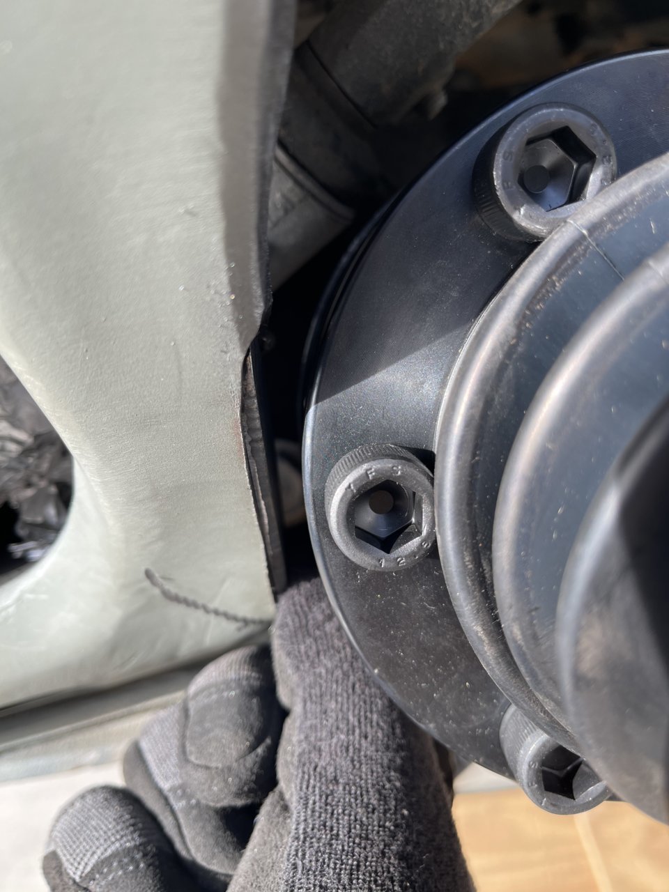

    What wheel spacers do you have to run? Glass or fenders chopped?
  11. Feb 20, 2021 at 8:16 PM
    #4151
    RonRon23
    RonRon23 Well-Known Member
    Aug 25, 2013
    #111135
    1,301
    Ronnie
    Buena Park
    2013 MGM DCLB 4x4
    I don’t know the specifics, I don’t have their spring under kit. That’s after I finish the front. I currently run archive garage sua kit. I have to use spacers to help stay off the shocks.
    I have glass personally, though their spring under kit should fit with trimmed oem fenders. I’m not sure if they fit with untrimmed.

    For sure gotta chop about 2 inches off the OEM fenders. Not sure about spacers but with the angle he leans the shocks forward you may be able to not have to run them.

    yea, even the filler neck gets repositioned. Fender trimming with SUA when fully stuffed. I'll get some pics in the morning. The flex pics Harry posted are with 33's.
