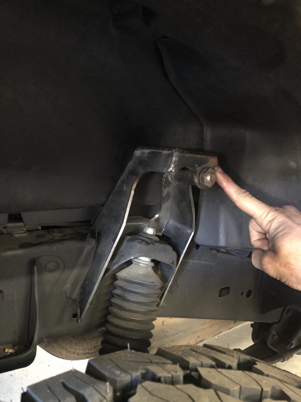

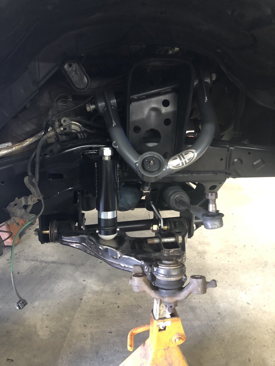

    Lol! Look at that mini bump! Curious to see how you’re going to beef up the LCA where it mounts to the truck. The weak part between the bushing barrels and the arms

    Im going to cut out some plate and wrap the bushings.
    In all reality I’ll probably end up building a stock replacement lower if I get bored enough
