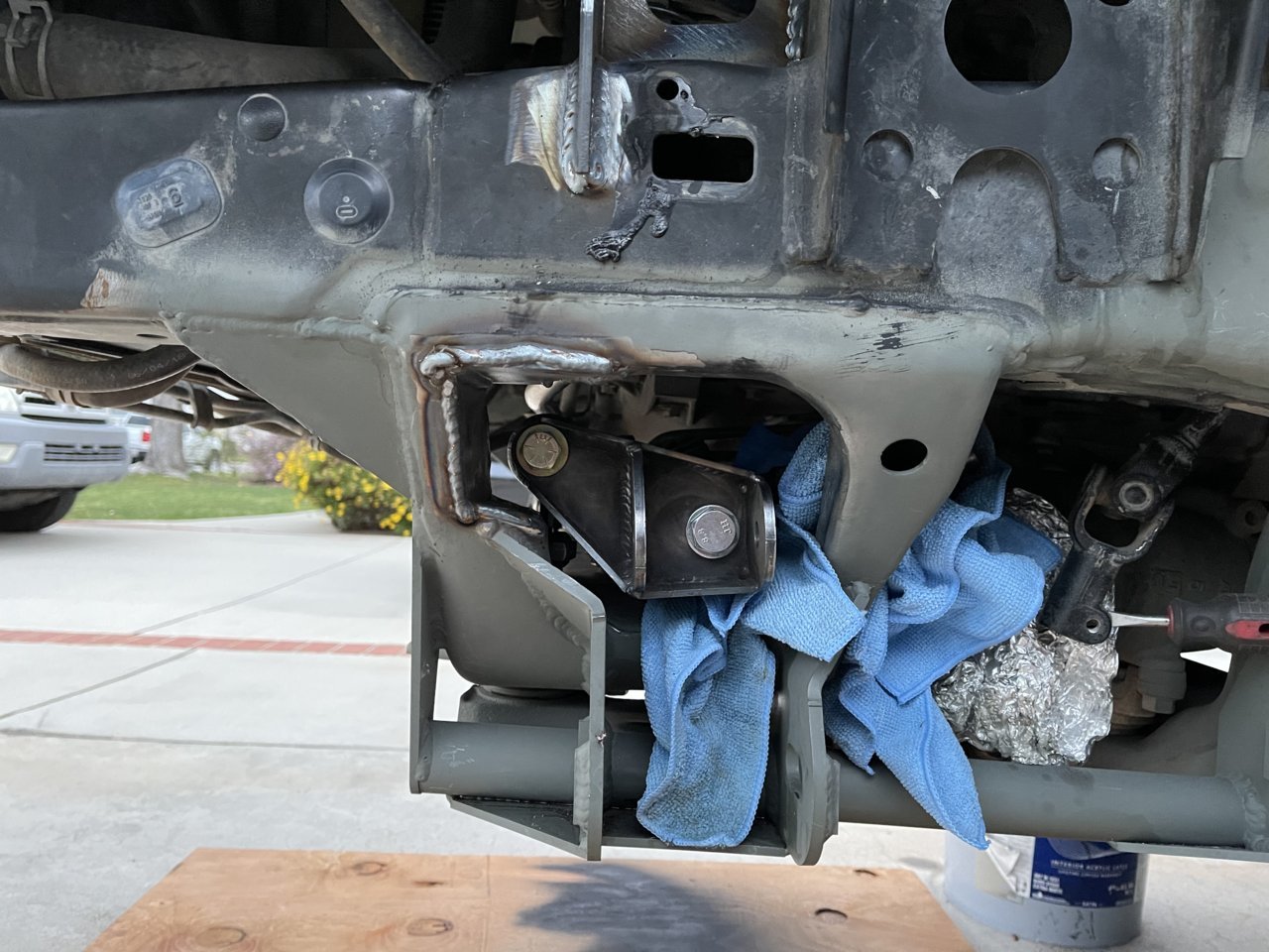

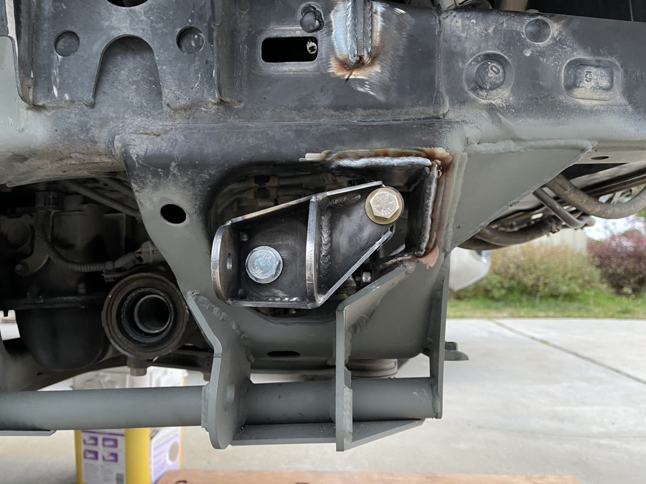

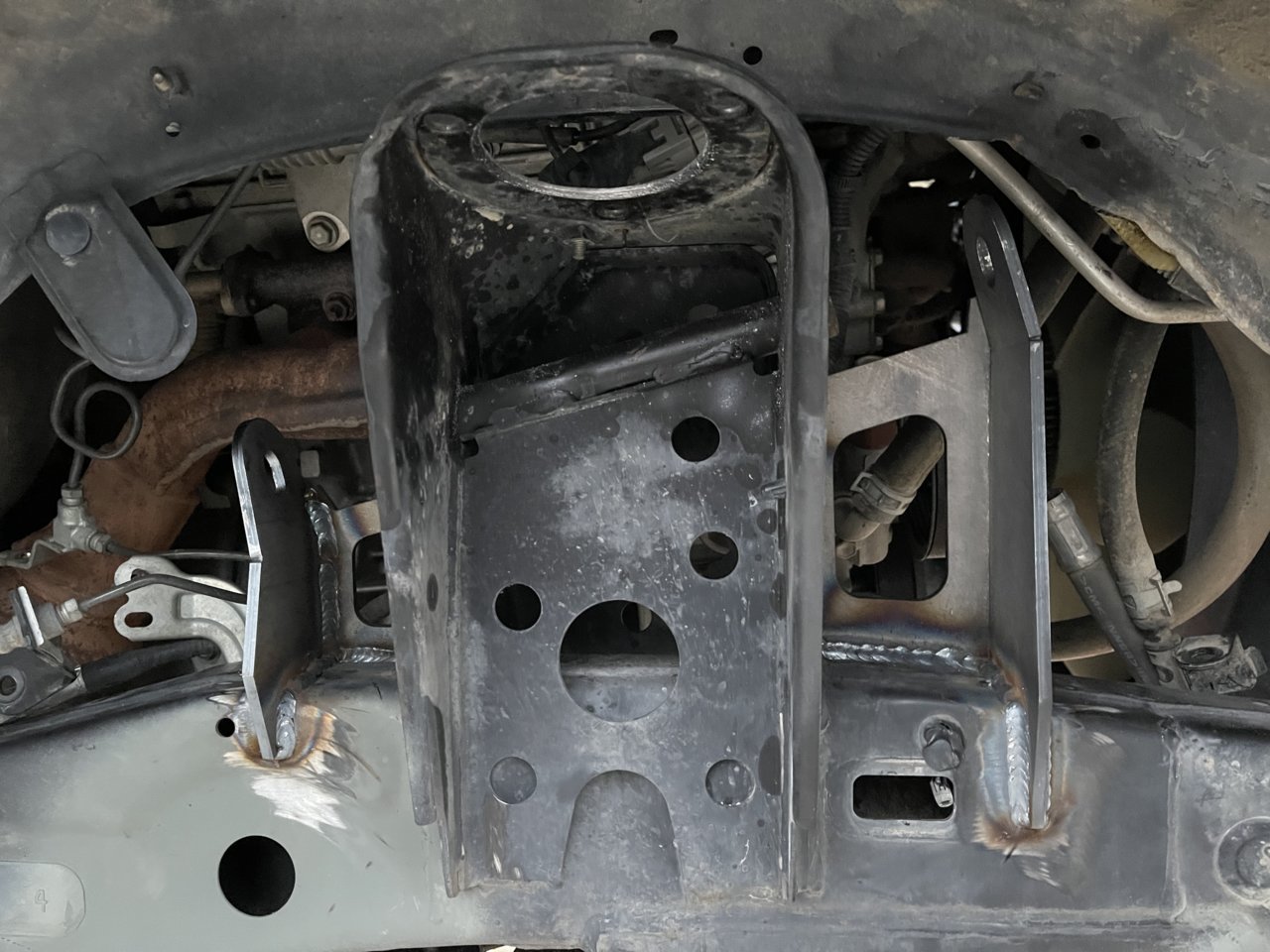

    Didn’t get to the bypass mounts as Ze did my cousins cam tabs for his tundra first. Got the slide rack installed and coil bucket gussets finished.

    I gotta say, find a good quality hole saw for the 3 inch hole for the coil bucket. Those Home Depot Milwaukee ones did the task, but did it barley. Should of put a jack under the drill like @Airdog was telling me haha. My arms were dead after.

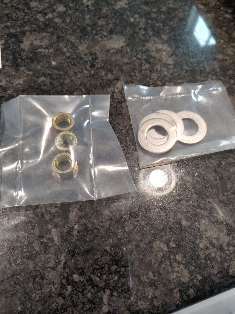

    @81Trekker, I think I'm missing one of the smaller nuts in my second picture based on the paperwork. I can just go out and grab one if you can confirm the specs for me!

    You’re not missing anything, the kit come with three 3/8” finish nuts for drilling the upper shock mount (so you don’t use your top locks)
    and the additional washers are for upper arm shims when welding the double shear tabs
