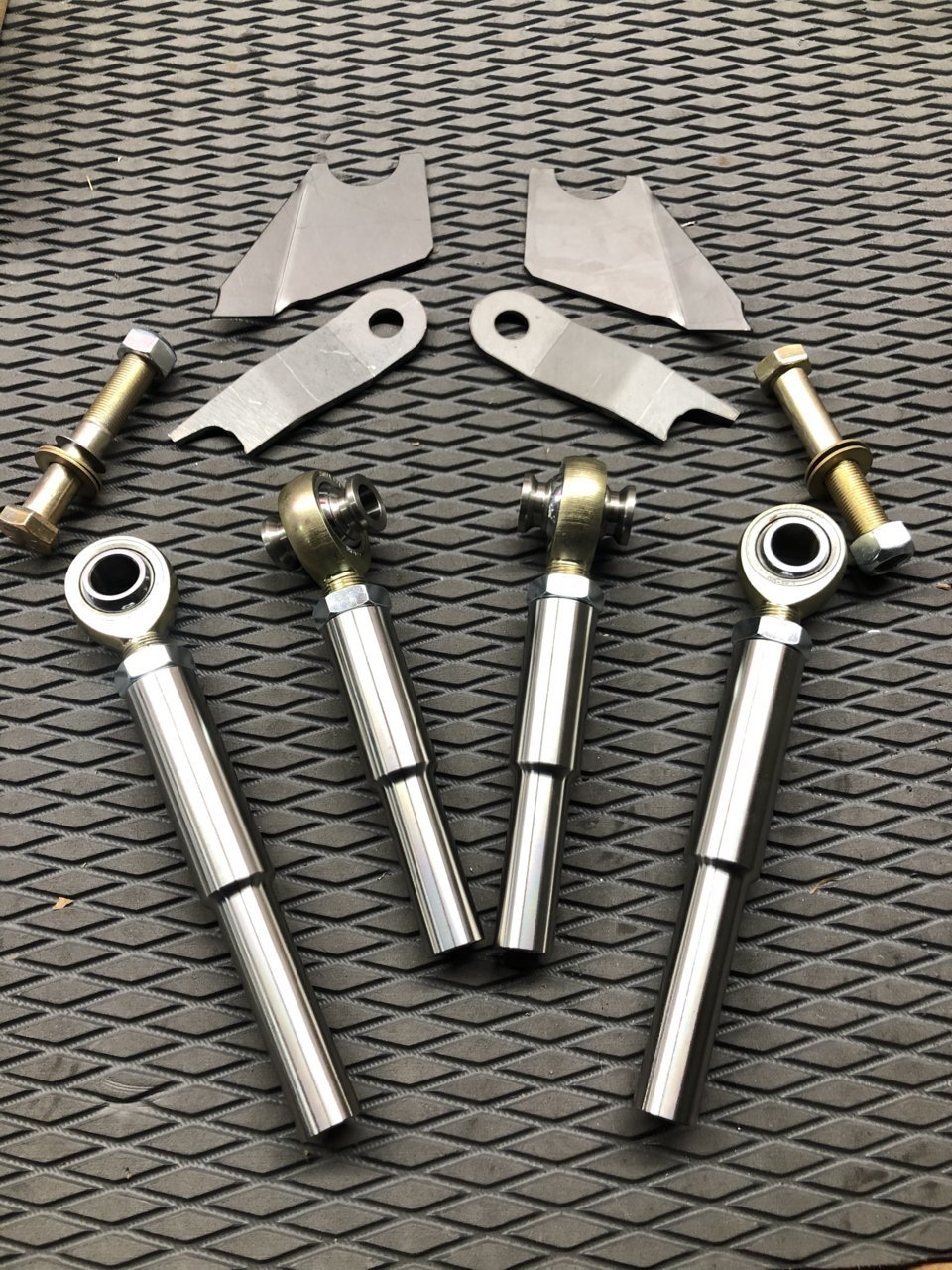

    Just picked these up... we now have steering extensions for our double shear kits in 3 sizes.
    stock length
    2.25”
    4”
    The 2.25 will work with any 2.5” LT kit and the 4” will work with a 3.5” LT kit.
    so basically no matter what kit you have you can run the double shear kit to your factory inner tie rods
