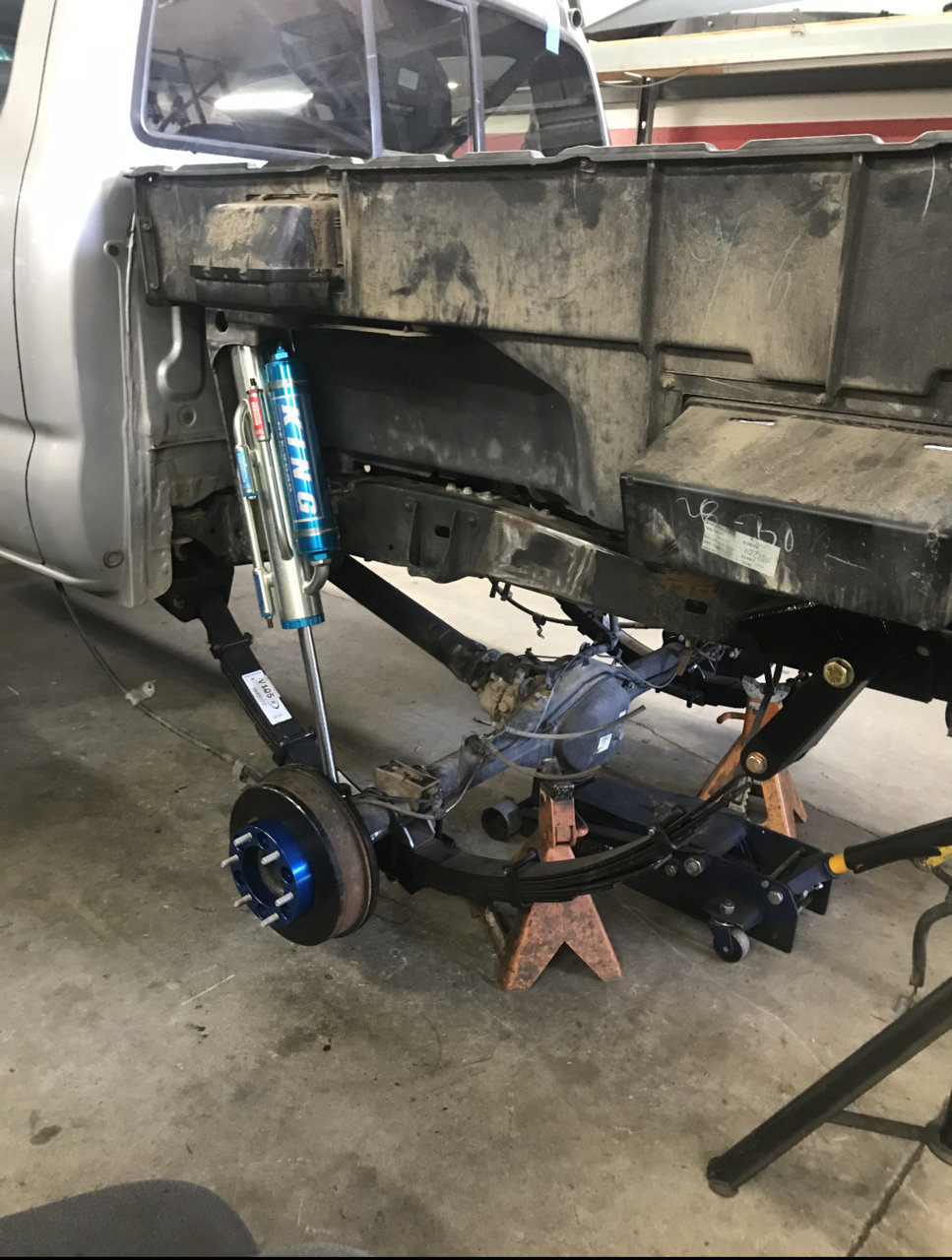

    Hey mr @81Trekker i got a technical/ design question for you. Your rear sua setup allows the shackle to swing forward past vertical at full droop as seen here. C59B4843-C6FC-4238-95B8-4E2707F1C82F.jpg
    I’ve been reading up on some old articles, builds, leaf spring design stuff, and talking to an old desert racer buddy as I decide if I am wanting to rework my rear hangars and flip my shackles to ditch the low hanging rear hangers.
    I’ve seen a few times and my buddy really emphasized that it is very important to not allow the shackles to cross vertical as you run the risk of the shackle flipping up and moving in the wrong direction. Curious what your thoughts were on this concern?

    My guess is its limit strapped so the shackle doesn't flop (limit strap not pictured)

    He said in the past that they aren’t running limit straps because the leafs are the limiting factor.

    The angle of the pic makes it look way more extreme than it is, the shackle angle is a non issue. If you’re super paranoid then you could strap it

    Thanks.
    Just trying to learn and with suspension design and geometry there’s 100 different ways of doing things and even more opinions about what’s best.
