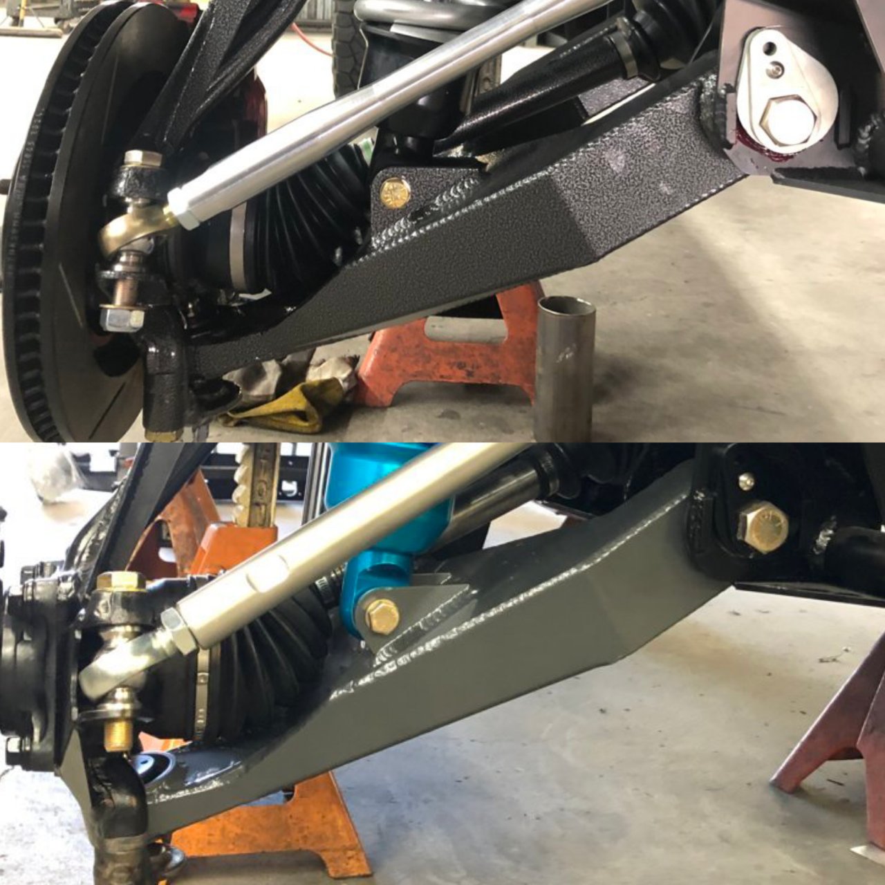

    I haven’t measured the difference between the arms but in all the pictures you can tell there is added length at the pivot area. It looks similar in the spindle end of the arms. I would imagine similar backspace wheels would still be a problem on +4. PNG image.jpg

    The shock is pulled 1/4” back on the +4 kit so you can get away with a 4” BS wheel
