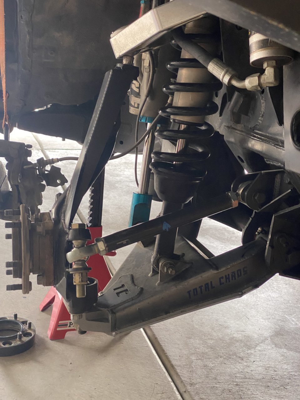

    Are those Bluetooth axles?

    does hat tie rod clear the coil at full lock ?

    Do the tie rod heims in the kit have zerk fittings for lubrication ? Will they end up getting noisy ?

    If you're asking those questions they aren't going to be for you.

    These ones don't, and they might if you don't keep them clean and lubricated

    I have never lubed a uniball with anything other than the PTFE spray. I was under the impression that heims don't get lubed because of their material. You either rebuild or replace.

    It's not dismissing a quick google search would net you the result and just looking at the pictures. Most heims DO NOT have zerks and are a sealed DRY joint of sorts. In fact the only heims I know of that are greasable are in industrial applications and are Yuge. Like I said if you are asking those questions with no effort in research they probably aren't for you.

    Well actually...a lot of crawler heims have zirks and a lot of race car heims and heim’d steering TRE’s have zirks which is what he may be familiar with.
    My understanding is that the type we are accustomed to with teflon lining will take more impact abuse but as you know they go in the trash when they get sloppy but the greasable joints last longer because they are lubricated. Some of the crawler heims are even fully servicable / rebuildable.
