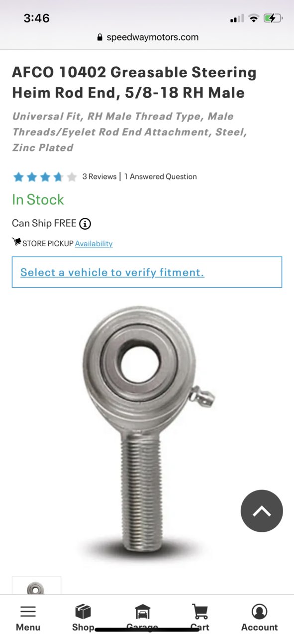

    Treat heims like the check engine light on your dash
    When they start to make noise, it’s good to check them.
    you should be cleaning out your heims with compressed air and your uniball lube of choice weekly to give them the most life.
    they have a Teflon lining on them and are very tight tolerance to allow the range of motion
    Once that all starts to wear out
    It’s time to service it.
    so a zerk fitting isn’t going to help your case as much as compound the amount of weekly check up

    The crawler heims are you talking about the like the johnny joints? I'd like to see the steering heims that are grease zerked. From owning a round track car and several drag cars none of those had zerked fittings all were like the ones used here teflon lined.

    Johnny Joints are a good example of durable units but each style has its application. But, Harry uses these Heims for a reason. They can be replaced and are relatively cheap just like uniballs.

    And a serious answer to the question is we use FK rod ends, they are not greaseable or rebuildable. Depending on how you use the truck will depend on their life. We typically get 3-4 yrs out of them on our big prerunners. They can easily be purchased from a number of vendors online and are not terribly expensive

    Thanks that’s a great example , I don’t mind maintaining something, if it rebuildable even better and if replacements are not crazy expensive I’d just keep a couple spares around.
