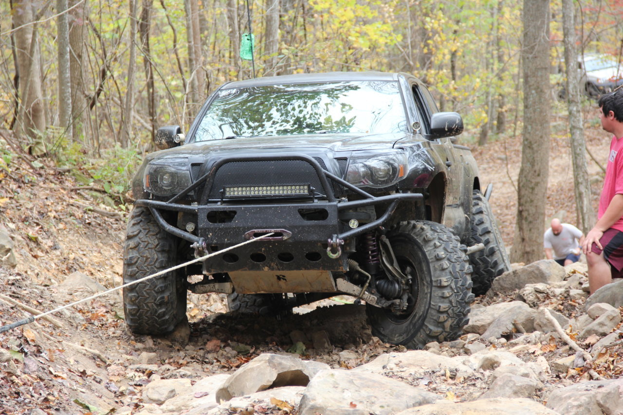

    I understand what the slide rack is for. He asked specifically about using the double sheer kit with build tie rods with the stock rack. In my experience with many folks who wheel on 37"+ tires, stock rack and built tie rod ends, they go through racks very fast where me and a few others have rack issues but go through tie rods faster. This is mainly because of the use of a front locker though. Every time I bend/break a tie rod, I had my front locker engaged where the rack is a more cumulative effect.
    The pictures are from the last trip I took. Was stuck on a challenging obstacle, was on/off with the front locker use, finally came up over a ledge and had the locker engaged still then the tie rod let go. A common saying we have is if you haven't broke it yet, you haven't wheeled it hard enough. Doesnt mean you don't challenge yourself and your truck but there's a limit to every part, you just have to find it.

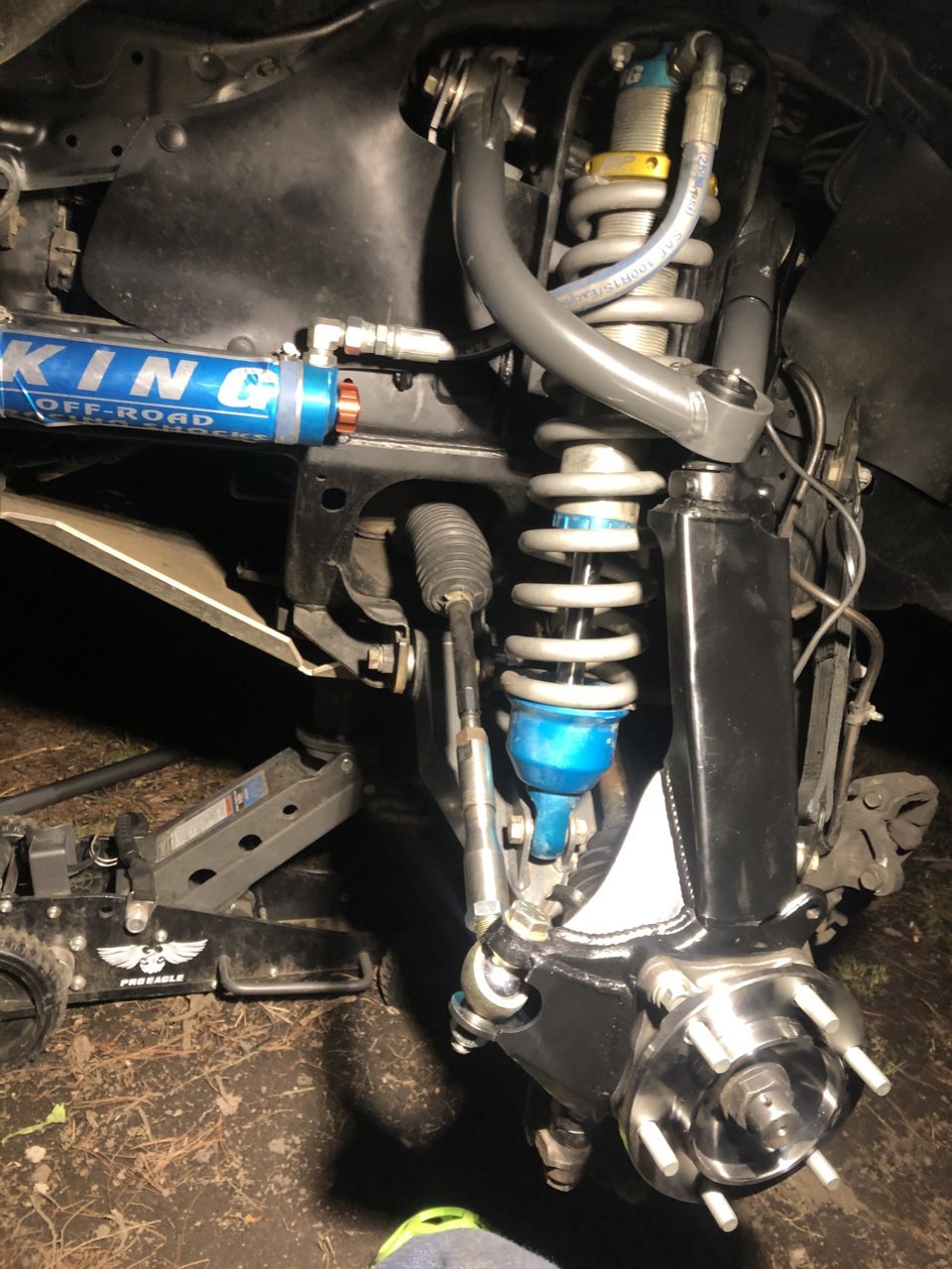

    Got everything wrapped up with new hubs and seals as well.28B44452-08F7-4846-A200-6052AA769BDF.jpg

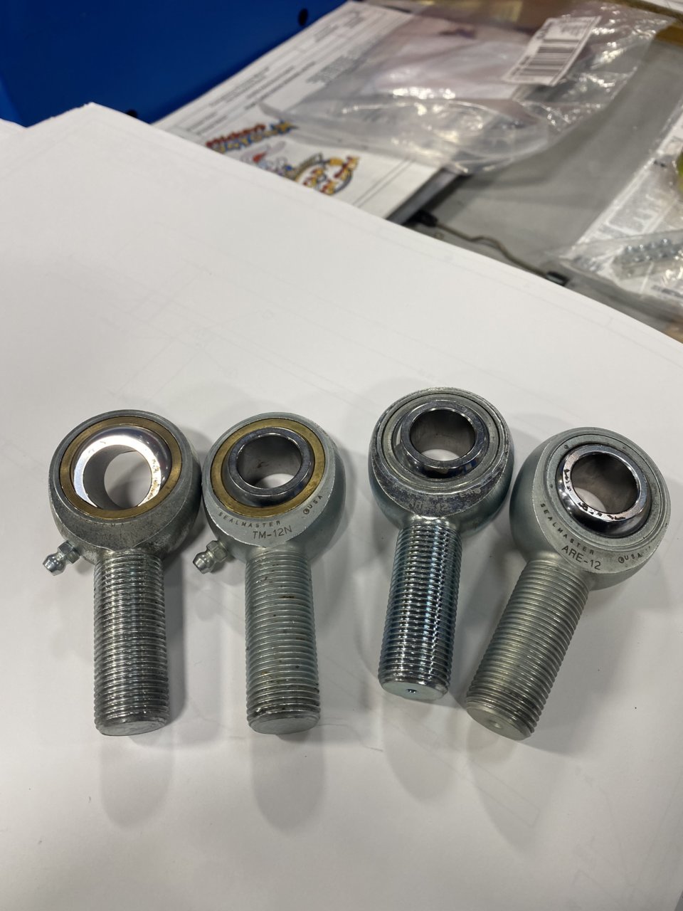

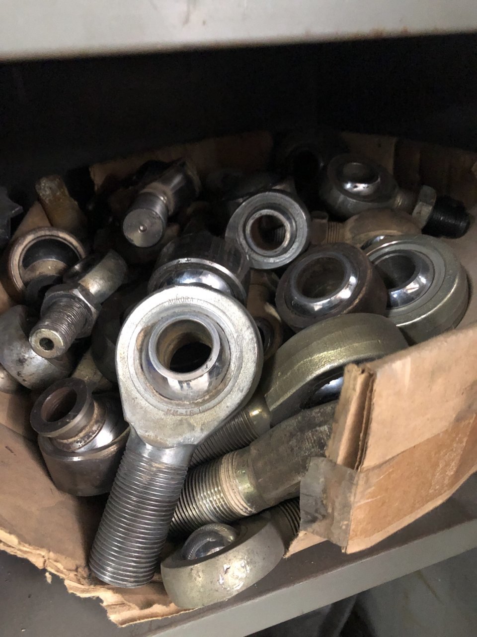

    https://www.tacomaworld.com/threads/airdogs-2012-prerunner-access-cab-slow-build.264263/
    Random 3/4 TRE’s from parts bins here at my work. Though I used the FK rod ends I found here for my truck... keeping these as spares I guess. 2 have zerks.

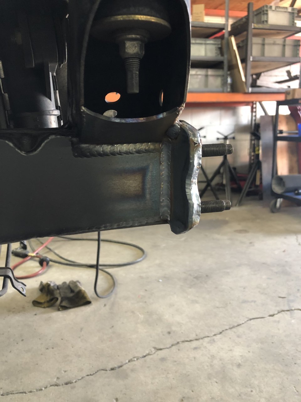

    Because you guys are all obsessed with winch bumper stuff...
