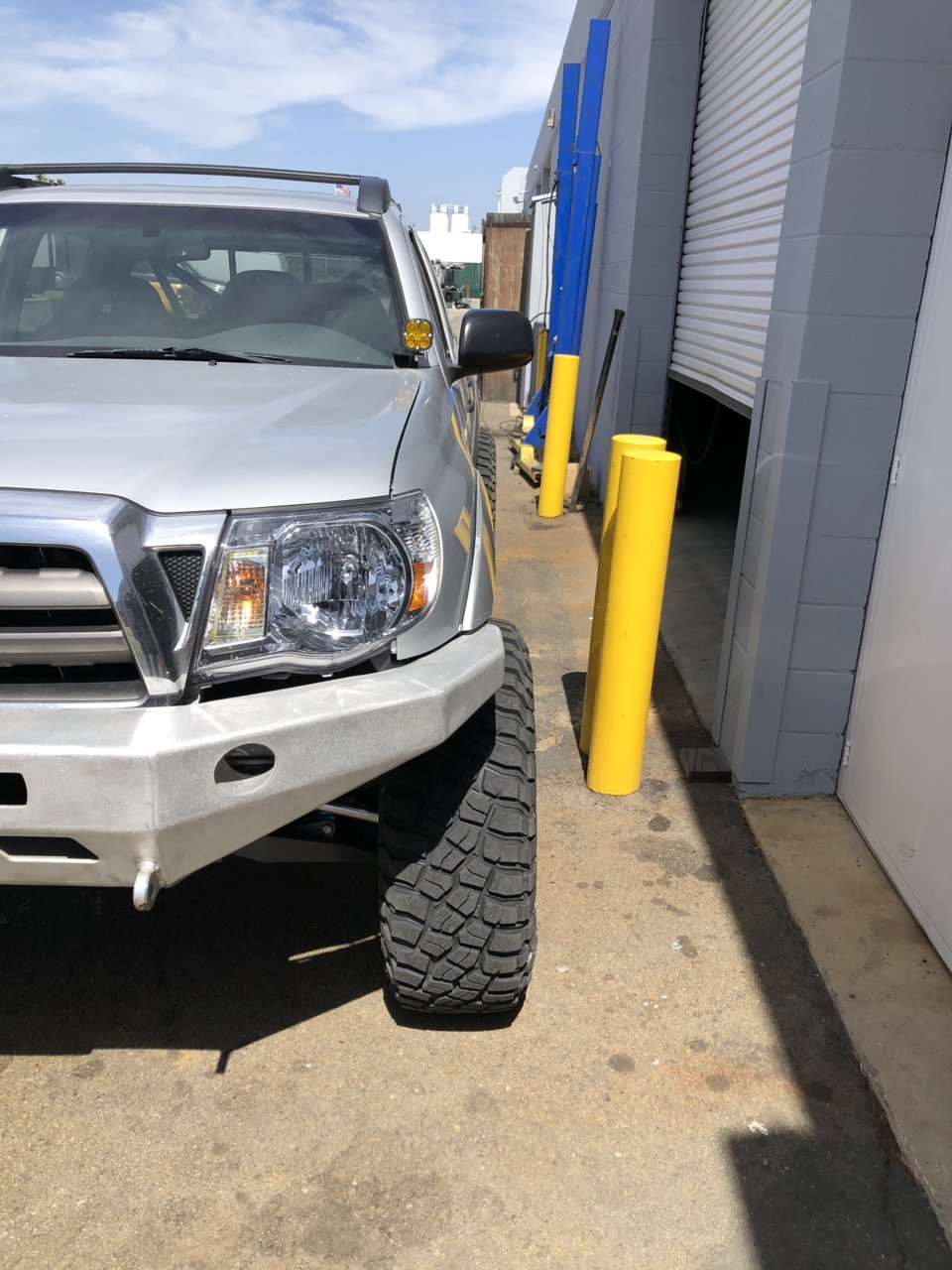

    That’s not bad at all. Is that as tucked in as possible?

    Yep pretty much. If you lift it more they'll get a little more tucked. The flatter the A-arms are at ride height the wider it will be. But not a whole lot. The more aggressive the wheel the more it'll poke out as well.

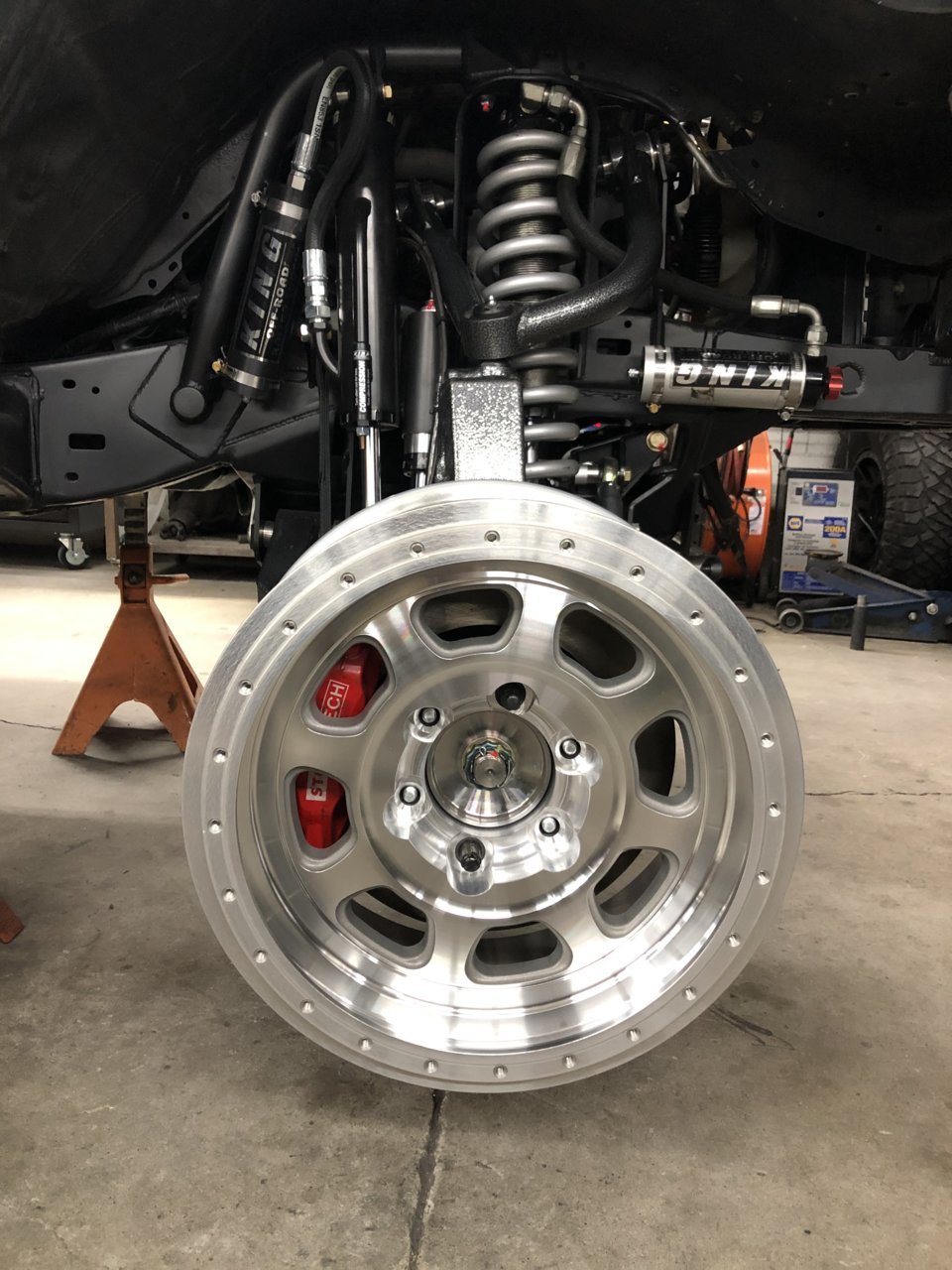

    Are you just gonna open up the hub yourself? I noticed it’s 82mm

    If you zoom in on the box it says the wheel has an 82mm hub. The tacoma has a 106mm hub.

    looks like they fit fine to me

    I guess they machine the hub out too then, or maybe those are 108mm based on the gap around the hub. I was just curious is all.
    My KMC’s are blanks and drilled to a Toyota bolt pattern but have a 108mm hub since the two options for blanks are 72mm or 108mm.

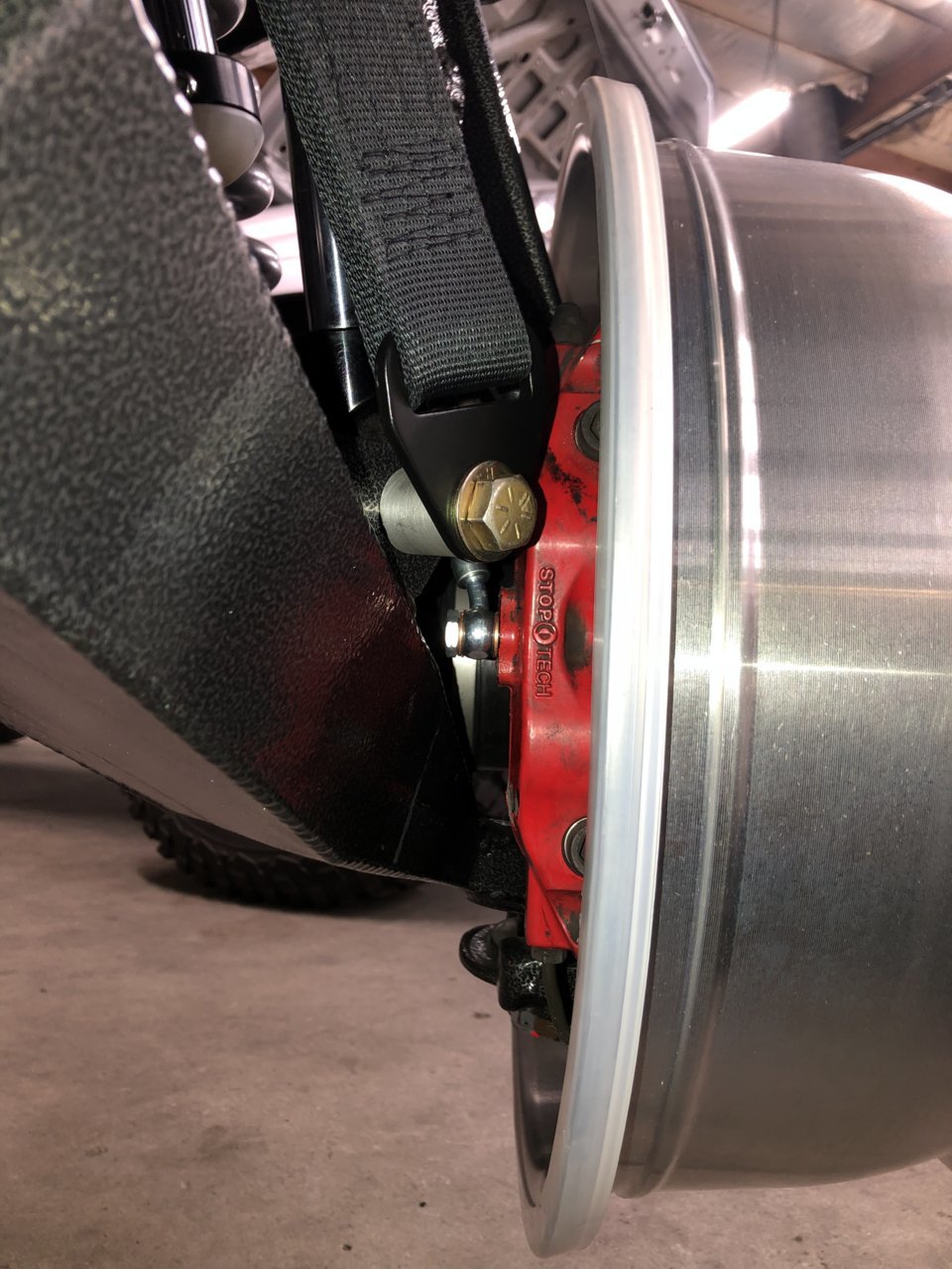

    4.5 BS wheel with Stop Tech big brake kit clearance
