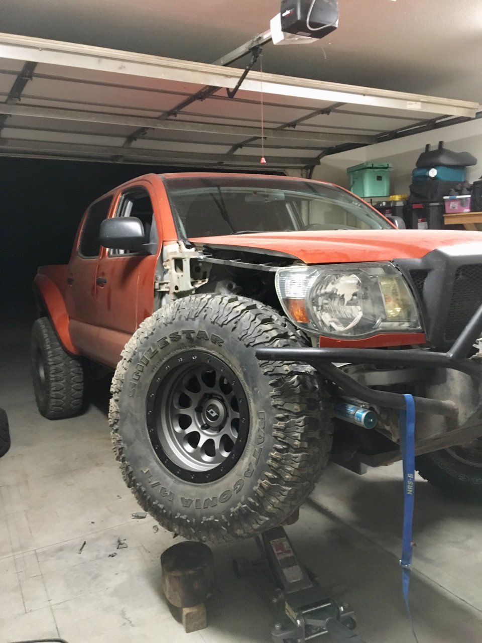

    I just had a massive light bulb go off on how to sas or stuff huge tires and change up the ifs a little for better all around goodness. Without having to alter wheel base. It's actually very obvious. Don't need to do it though. Even though I have been looking at wrecked AC.

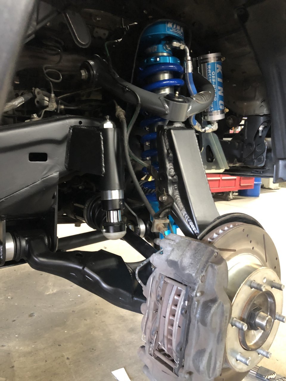

    To those who said it wouldn’t work...

    What are the aluminum spacers for in the LCA mounts?
  18. Oct 30, 2019 at 4:24 PM
    #478
    81Trekker
    81Trekker [OP] Well-Known Member
    Aug 25, 2019
    #303299
    3,750
    La Jolla SD
    81 Trekker and 2015 CCSB Tacoma
    Too many to remember
    The final version of the lower arm mounts are adjustable... this kit can be run with anything from the stock pivot location to 1” forward. Different thickness pucks can be used to achieve the desired amount the arm is pushed forward

    Ah now that's cool. That's a neat little addition. I don't remember reading anywhere that you were doing that. Like that you added some adjustability to it for the end users to be able to dial in what they want.

    Best part is that uca bolt is still backwards lol
