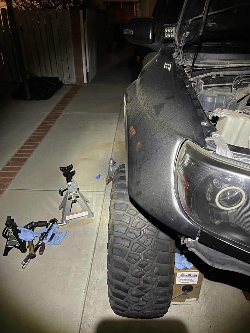

    We’re getting there. I bolted in the passenger side arms, spindles, and axles today. Tomorrow I’ll be throwing the slide rack, steering rack, and driver side together. Not sure if I’ll get to the brakes yet.
    here’s a quick picture with the fender tossed on. These are 315s on 16in wheels,3.5 BS.

    what glass are you running?

    And that’s the +4 kit, right?

    advanced fiberglass and yes a +4
