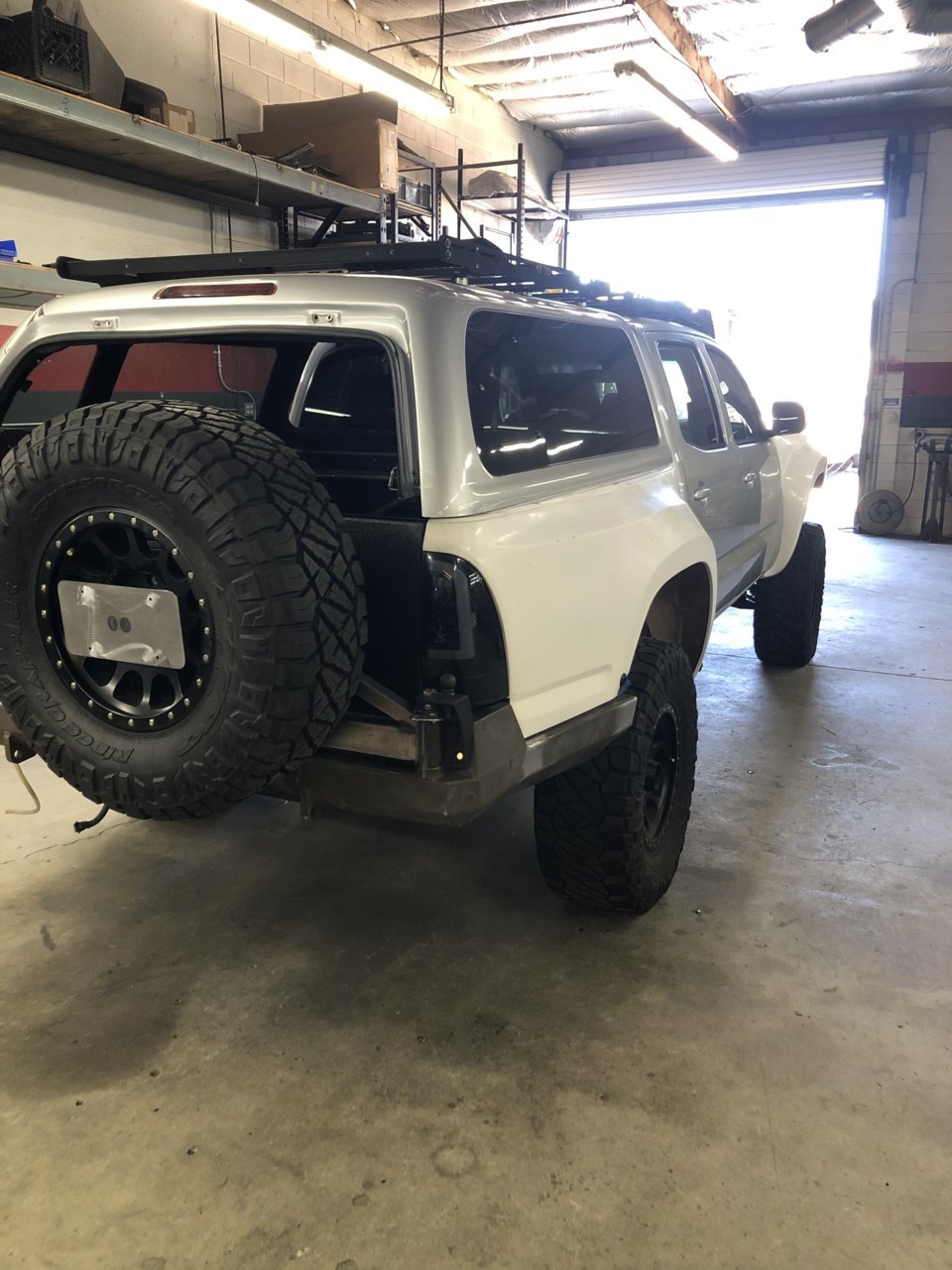

    Since you guys love pics of Tacoma’s

    Is that HC bumper modified to follow the lines of the new fenders? I can't tell if it's a trick of the lighting or not.

    I heavily modified it for the glass, made my own 60/40 swing gates and filed in the license place cut out
