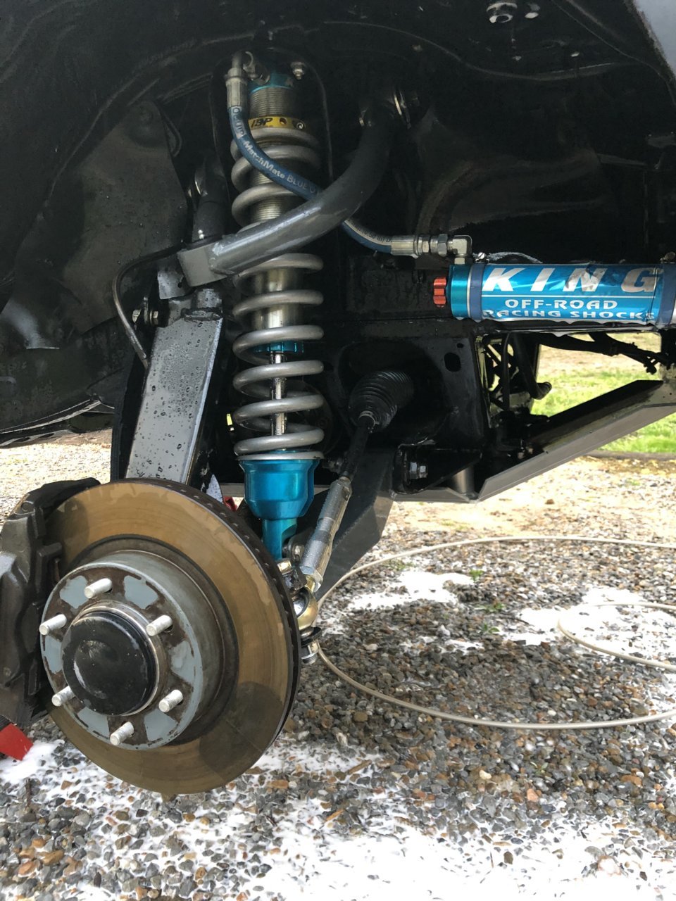

    Finally got a leg up on my project and got mine aligned today. JD FAB LCA installed on an FJ Cruiser, 934cv's, LT kit from others. I converted the UCA's to adjustable heims and was able to get my alignment in spec (the Tacoma mounts are wider than the FJ's). Cams are basically fully in minus some adjustments. 5 degrees of caster with two pucks behind the LCA. Rear links are within .08 degrees of front which I was told was better than factory specs, so that's a score. Especially because those aren't adjustable. Once I get my rear spring rates figured out I should be back in action.

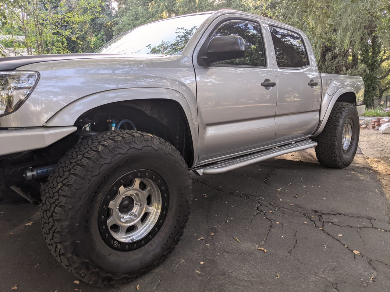

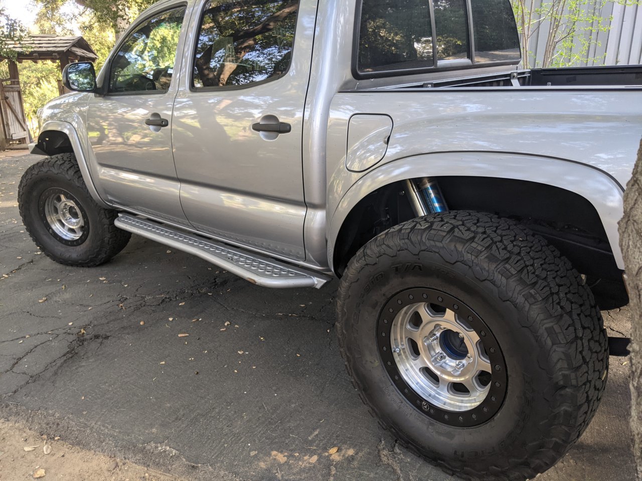

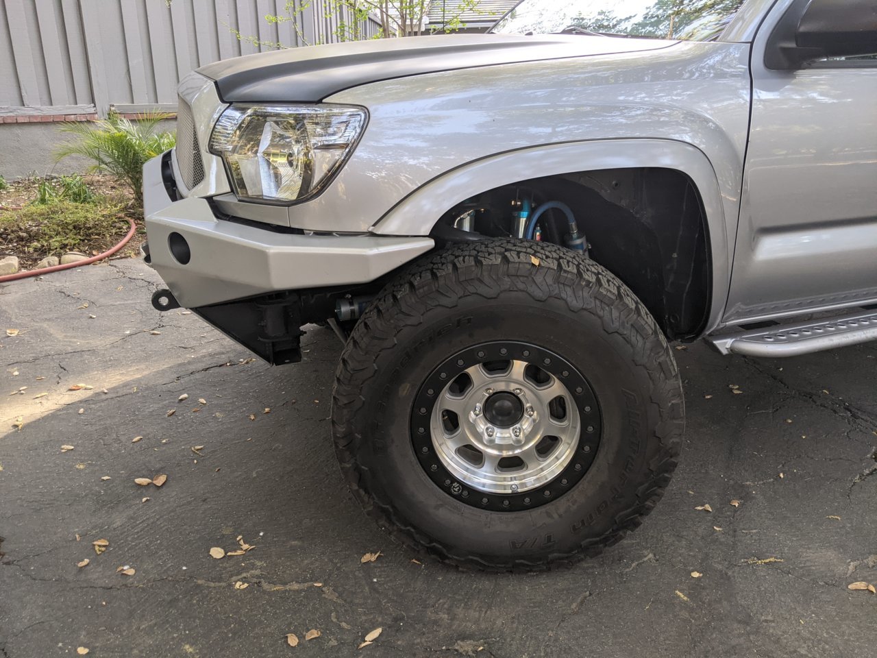

    Sooo this happened. Special thanks to everyone who helped pick up spilled washers and putting in bolts. Performance wheels never looked so good...on MY truck! They would look good on YOUR truck too! Text Harry 100x for the 'TW discount'! (don't do that... tw discount=no parts for you!) but if yer lucky maybe they'll sell you a set too!
    TR Beadlock 17x8.5 (flow formed)
    Black Rings with Magni Black Hardware
    Getting closer! Inner fenders and fuel tank switcheroo coming soon.

    Shit I thought you actually went down a dirt road for once but let down still a pavement princess :boink:
    Wheels look good! I'm probably going to get a set and have them custom PCd
    Yossarian, Camazon, tyfoon11 and 3 others like this.
