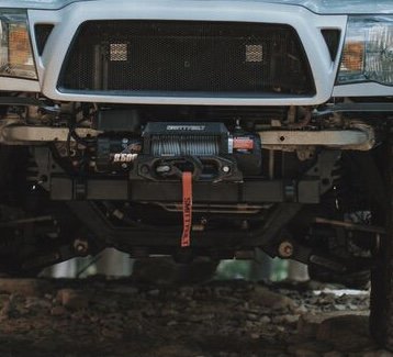

    8FA4371A-BB82-44D1-ADC7-30791E0B5DCC.jpg I did something like that on my old taco. Was able to get an xrc winch almost behind the grill.
